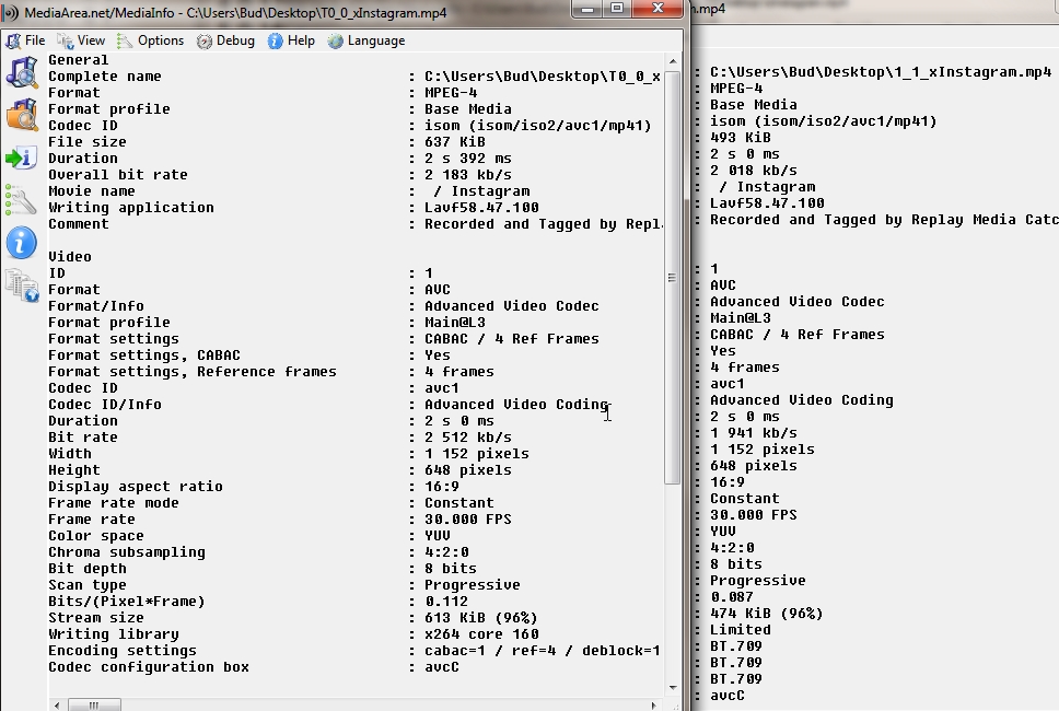

This has really gotten me baffled after checking everywhere and doing many MANY tests. I have a video approximately 6 minutes that I am using to test. The mediaInfo of them is:
[Attachment 56904 - Click to enlarge]
The Encoded portion (Prefixed by T_) is as close as I know how to make it the same as the copied portion.

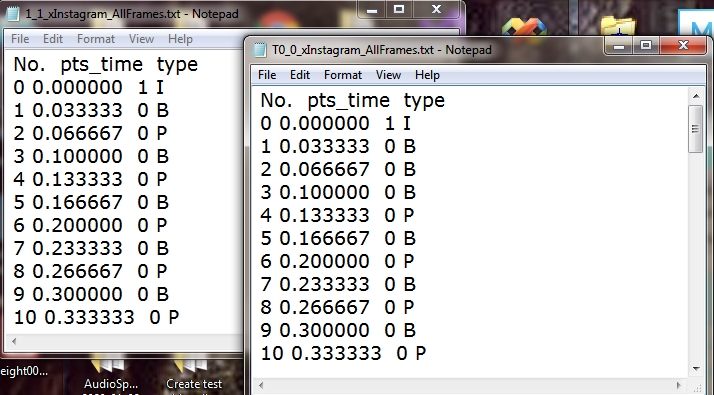

The ffprobe shows Identical Bit structure, starting with an I frame and ending with a P frame with the requisite 30 FPS Pts for each frame'

The problem is that there is always a glitch at the junction, either at the I frame or just afterward
C:\Users\Bud\Desktop\T_1_1_xInstagram.mp4
Successful Cut at Frame 60 ENCODED poretion
1.833333,B
1.866667,P
1.900000,B
1.933333,B
1.966667,P
C:\Users\Bud\Desktop\1_1_xInstagram.mp4
Successful Cut at Frame 120 COPIED portion
1.833333,B
1.866667,P
1.900000,B
1.933333,B
1.966667,P
The junction shows a 1 frame hesitation with a PTS of 2 frames.

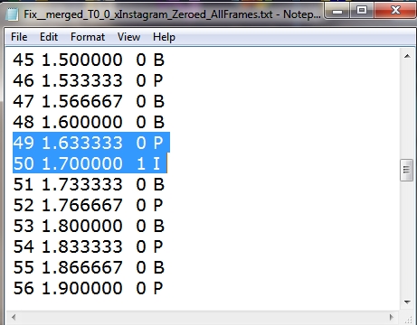

[Attachment 56906 - Click to enlarge]
If anyone knows why and/or how these 2 encoded/cut segemnts from the same video can be joined smoothly, I could really use some help.

Joining them still gives an error but is almost imperceptible when viewing.Code:ffmpeg -i "video1" -c copy -bsf:v h264_mp4toannexb -f mpegts -y "intermediate1.ts" ffmpeg -i "video2" -c copy -bsf:v h264_mp4toannexb -f mpegts -y "intermediate2.ts"
58 2.005333 0 B
59 2.038667 0 P
60 2.038667 1 I
61 2.072000 0 B
62 2.105333 0 B
Closer but not quite a cigar.
