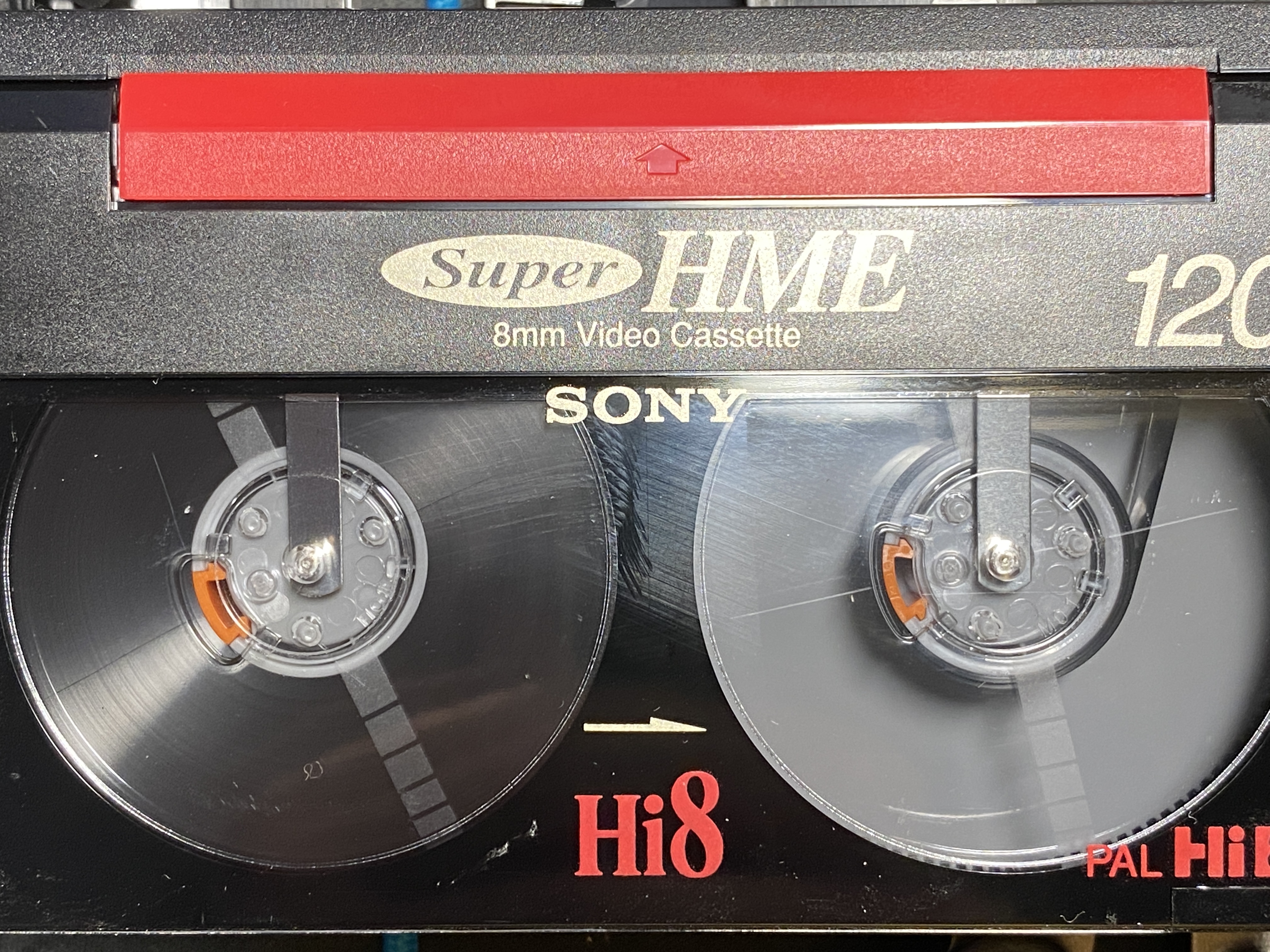

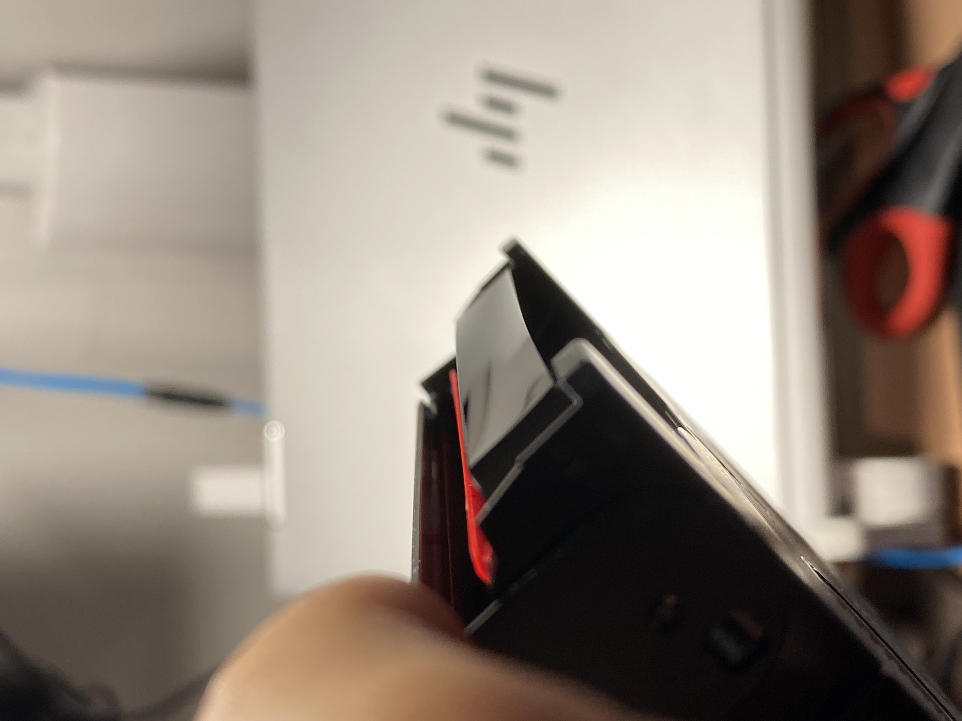

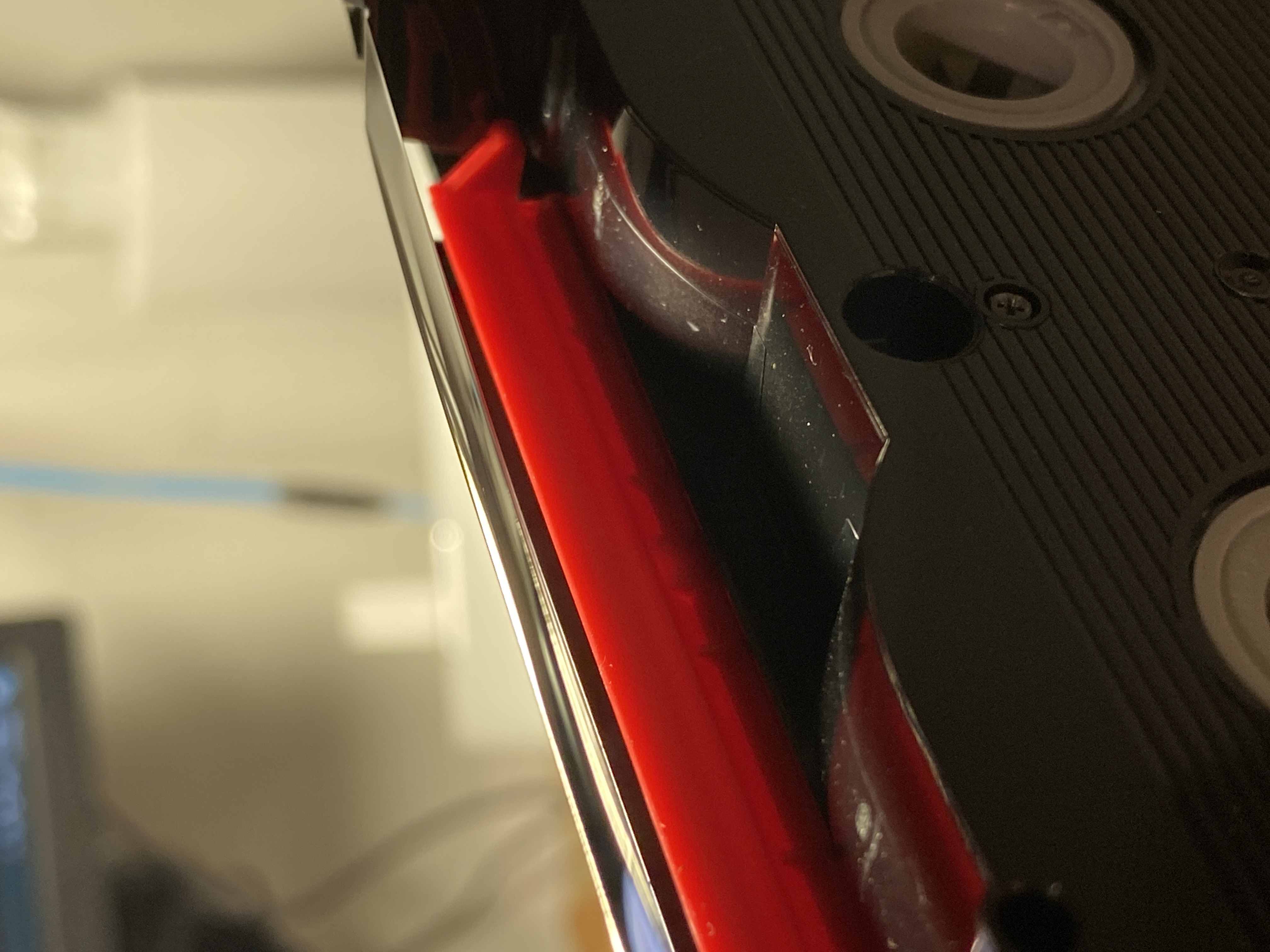

    Now I have the last 8mm tape and it acts not friendly and I couldn't find anyone reporting a similar issue. The tape itself is curled at the edges and I suspect that's the problem but I would some picture. The tape instead starts and stops and not playing through. I RW and FW a few times in a row with the hope it'll help.
    Below some pics of the tape and a video of the behavior.

  2. Member dellsam34's Avatar
    Jan 2016
    It looks like the tape layers are stuck to each other due to mold, You need to take it a part and manually release it.

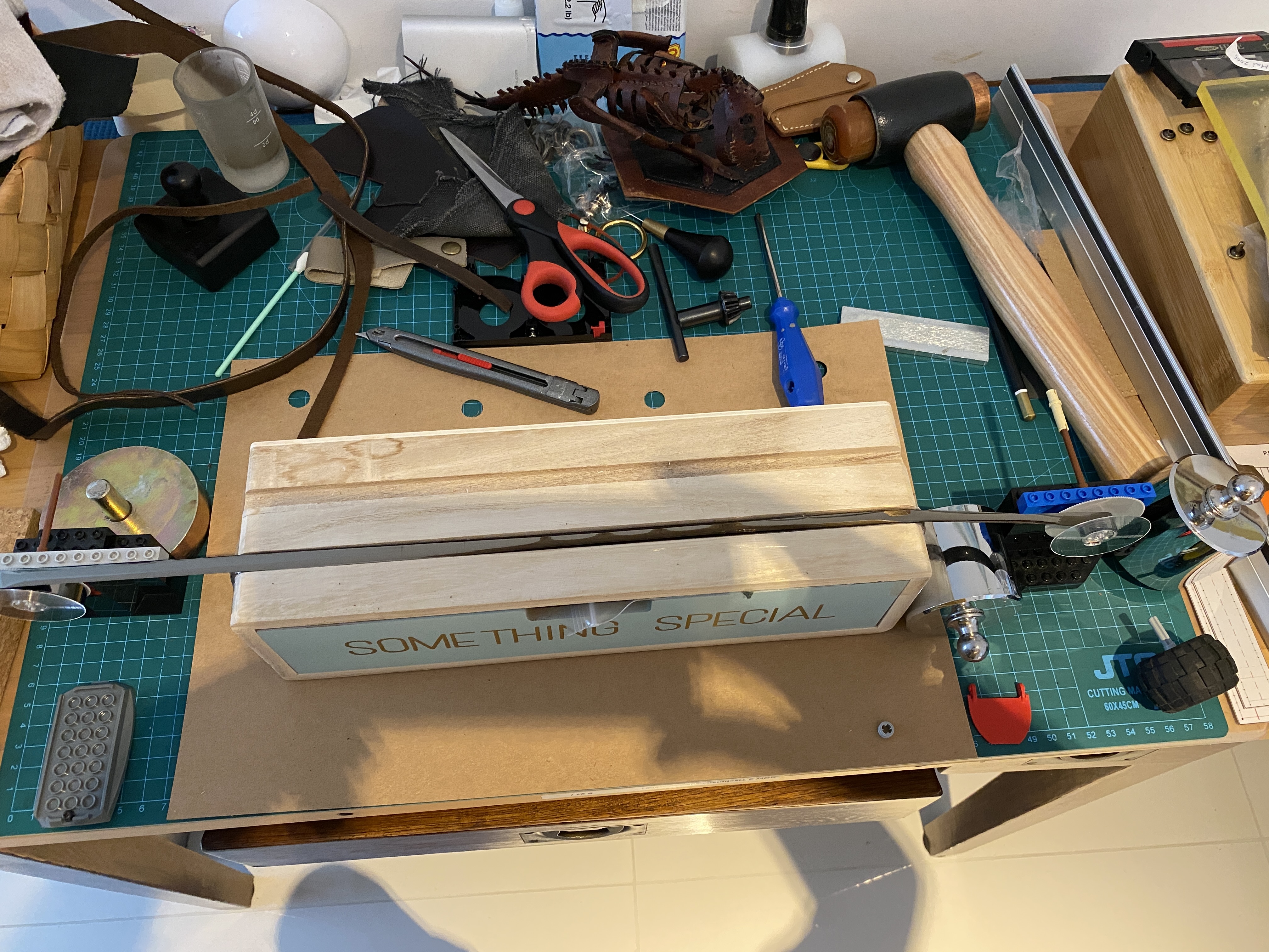

    Yes, Take it out of the shell, wind it manually by making a jig on a tape to make sure the tape is not sticky, If you have another shell use it because it could be just the shell you have is defective.

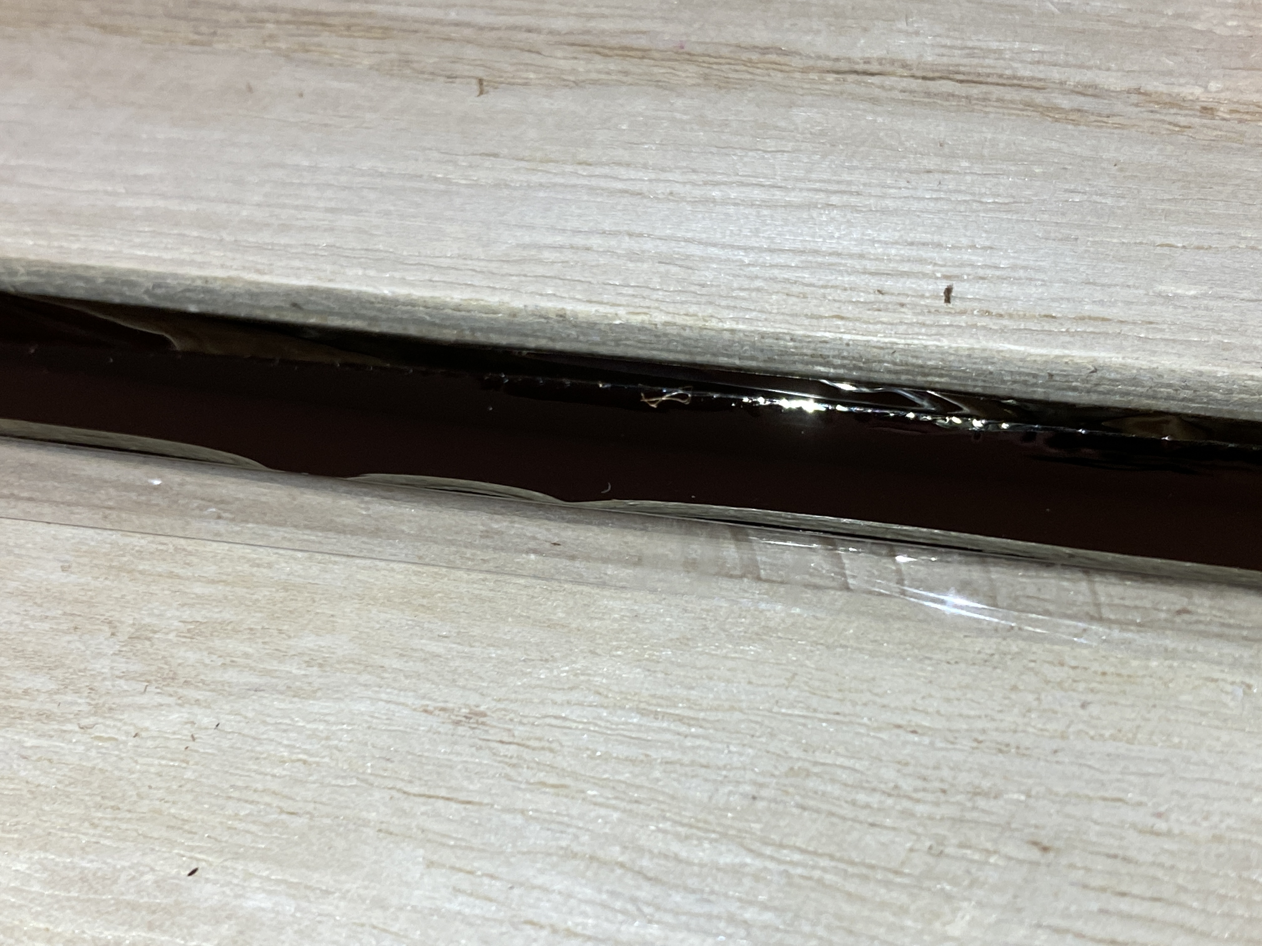

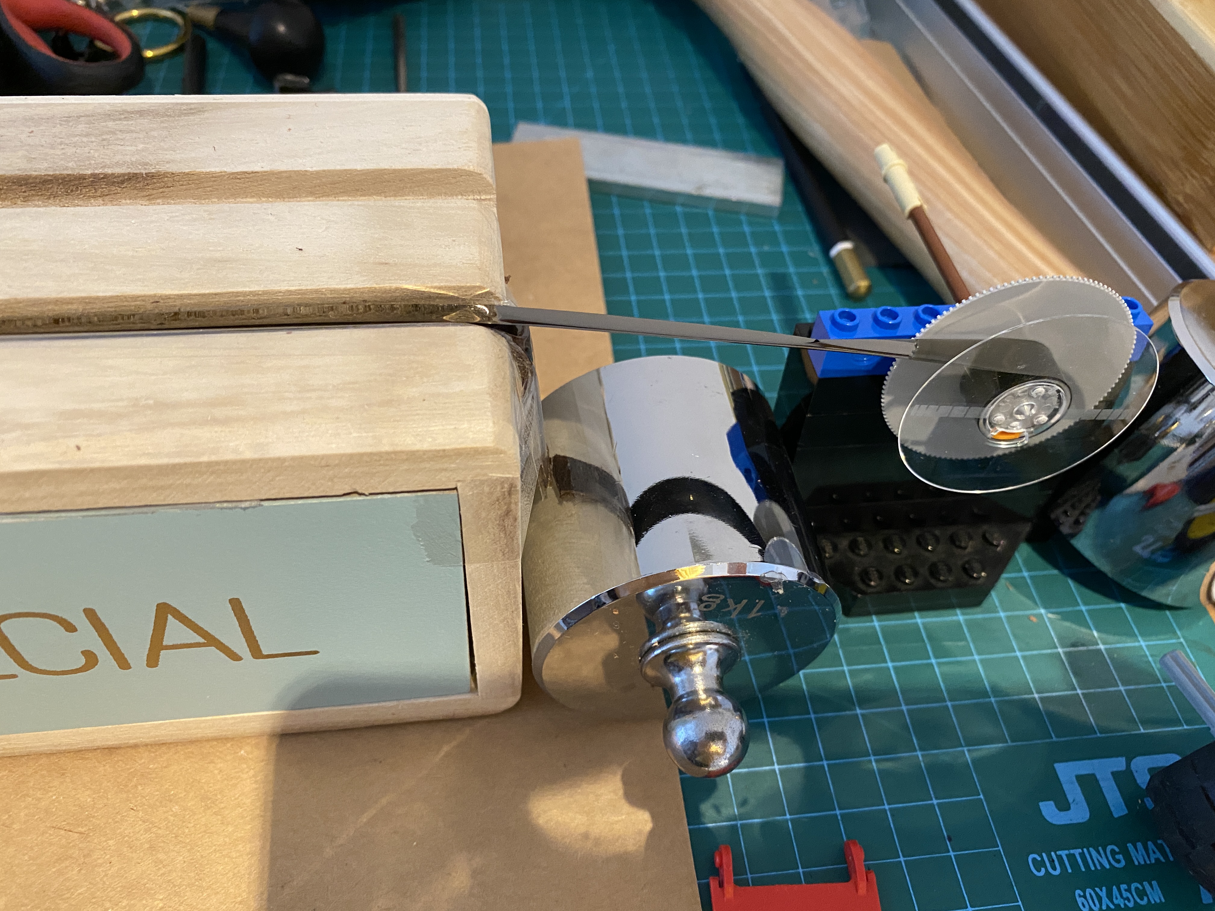

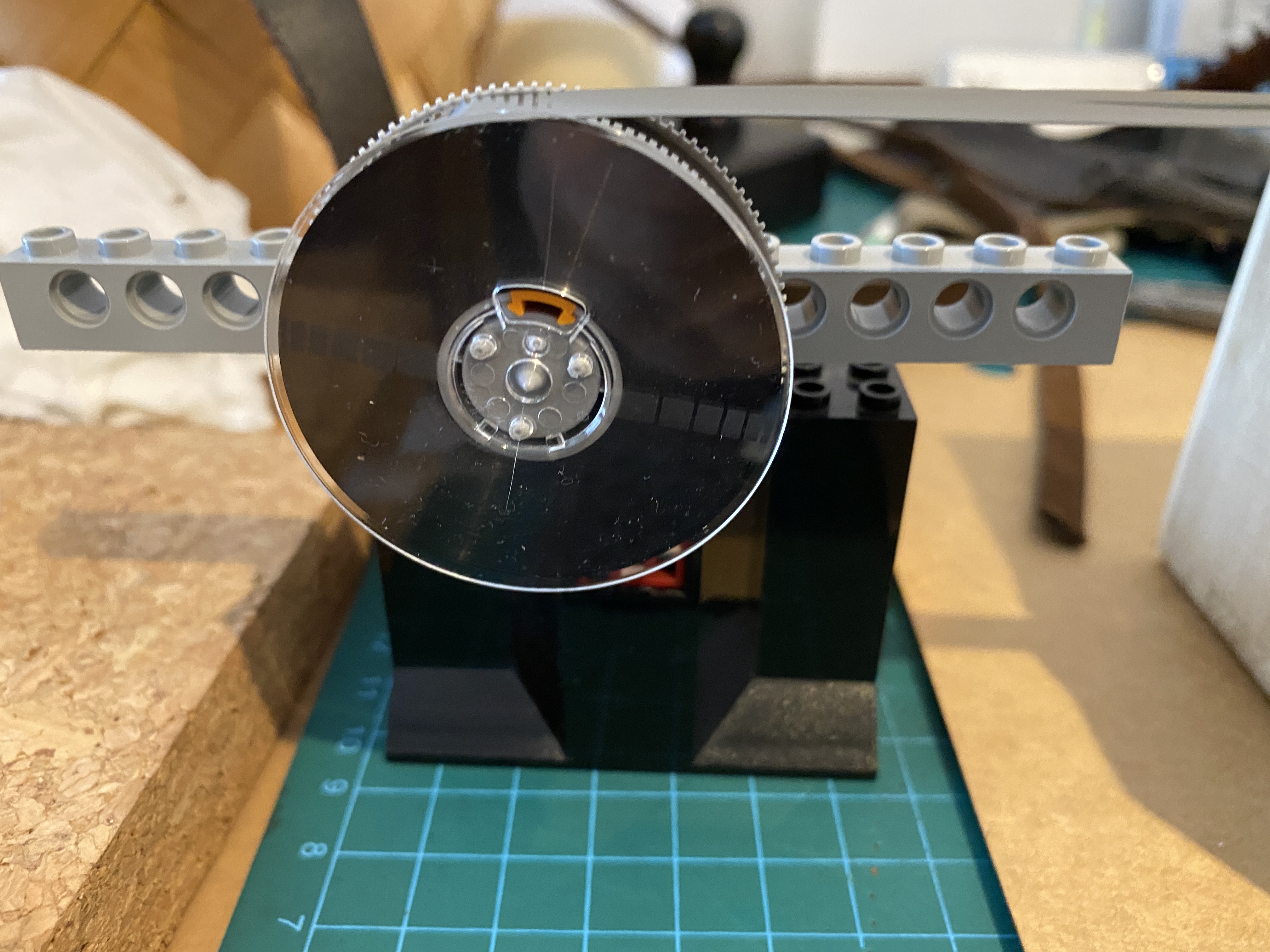

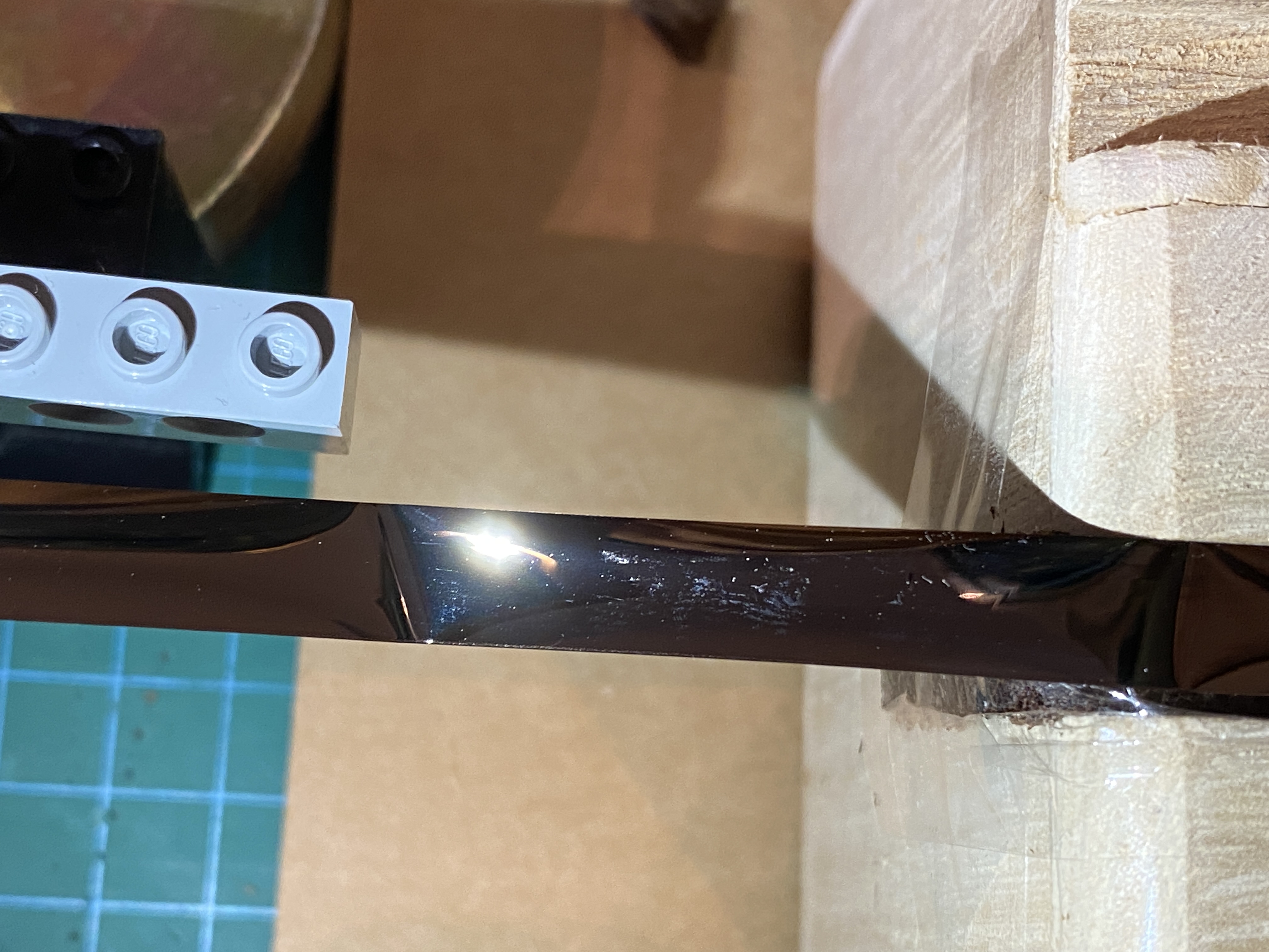

  5. well it kinda worked and not, my wife is gonna kill me, it's the tape with a scene from my younger son which we liked to remember ..
    first what I did and photos of my impromptu "jig" with lego
    [Attachment 56923 - Click to enlarge]
    [Attachment 56924 - Click to enlarge]
    [Attachment 56925 - Click to enlarge]
    [Attachment 56926 - Click to enlarge]
    [Attachment 56927 - Click to enlarge]
    [Attachment 56928 - Click to enlarge]

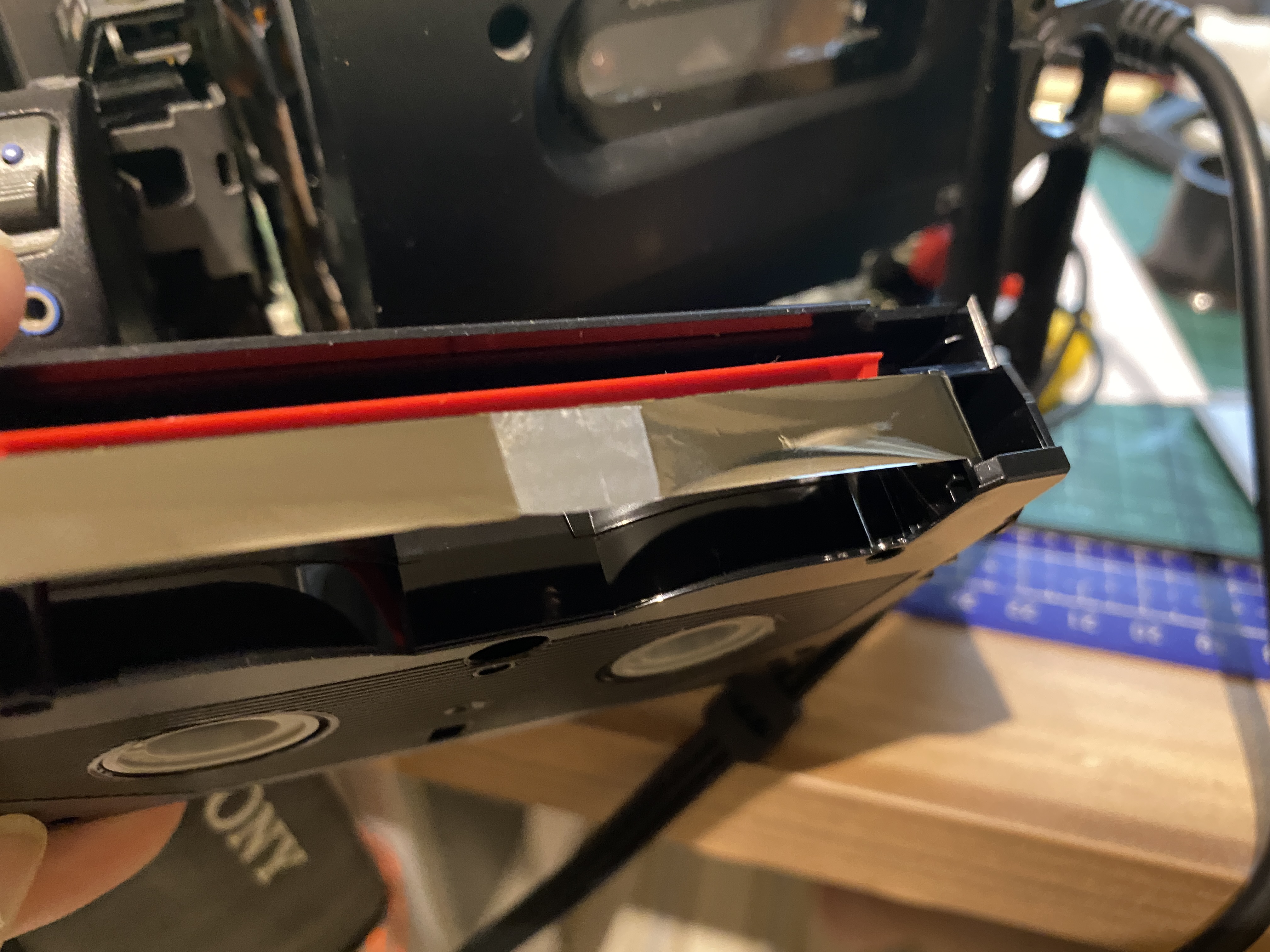

    The p2 hotos before the last show the only visible "anomalies" I could find. I have cut the portion which was damaged and tried to splice (last photo). The erratic behavior of start/stop disappeared but I have no picture and sound just blue screen. When I look at the clearclick it receives a video signal but nothing is showing.
    Is it possible I destroyed the band with my fiddling ? It shouldn't be possible that I would have wound the tape upside down ? (even with lego the winding was a pain..)
    Forgot to add, I took a tape I had captured and swapped the shells, no luck...
  6. Member dellsam34's Avatar
    Jan 2016
    No, The scotch tape should not be facing the drum you risk damaging the heads, Do it again and reverse the adhesive tape. You should not have cut the tape, just clean it, it wasn't that bad to worry about.

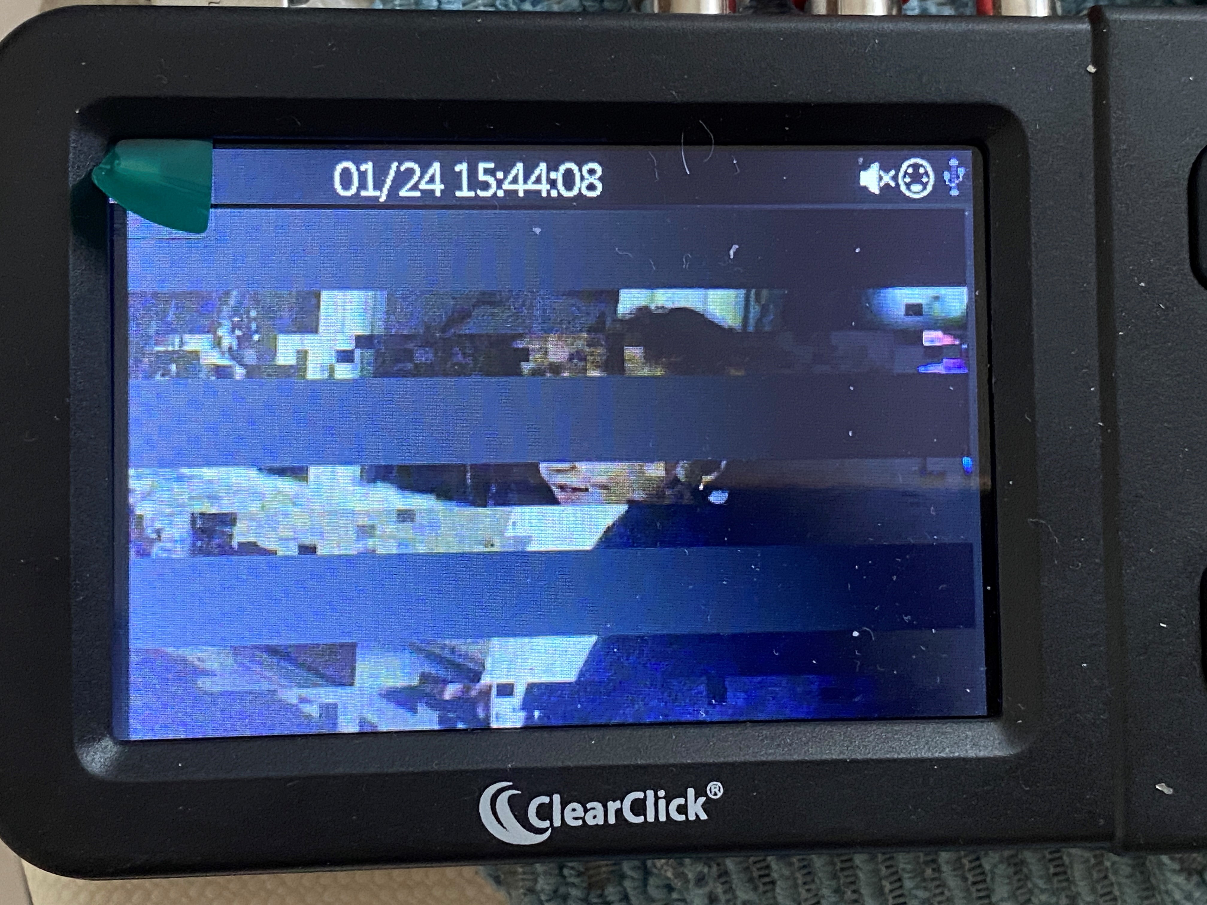

    I did correct my mistake (quite badly though but anywho..), I wound by hand beyond he spliced part and now I get some picture but with 3 grey bars , a bit pixilation now and then and again it will stop after a few seconds, start again and so on..gonna loose soon the few hairs left on my bald...
    [Attachment 56948 - Click to enlarge]

    How about the camcorder viewfinder? How does it look like? The best method to capture analog video is Vdub or AmarecTV PC software to hard drive.

    Viewfinder and monitor show the same picture as clearclick.
