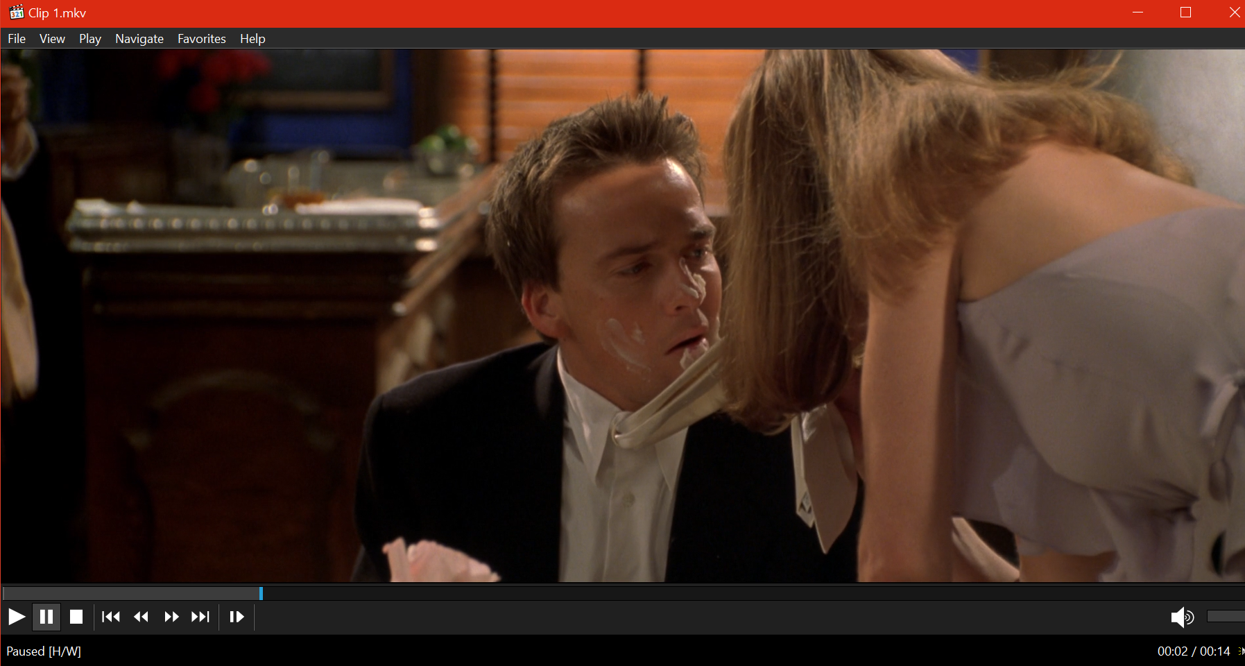

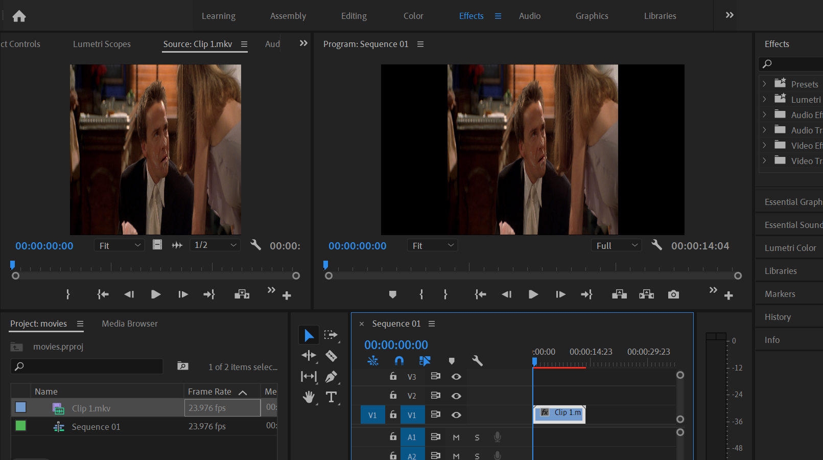

    I've included two screen caps.
    The first one hows the clip as displayed on the player - it fills the screen completely and it's the same when I try it on my TV.
    The second pic shows the clip once it is imported - with thick black bars on both sides . It must be something I'm doing silly! It has to be.
    The properties of the clip (attached in the first post) say it is 1920x816.

  9. Certain versions of PP have MKV support. It got removed in certain versions, returned in others
    You can interpret the AR of a clip by right clicking the clip in the project bin => modify => interpret fotoage . Set the pixel aspect ratio to conform to square pixels (1.0) .
    Make sequence of the matching settings of the newly interpret clip (right click => new sequence from clip)
  10. Originally Posted by poisondeathray View Post
    @poisondeathray OMG! Thank you Thank You and Thank You !
    It certainly was the Pixel Ratio and I am sorted!
    Thanks to everyone who took the trouble to help me out!
