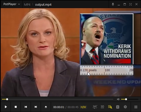

The video has a 4:3 frame size and displays as 4:3. But I think the OP is right, Amy Poehler's face is too narrow (compare with her other appearances on SNL at youtube.com). Stretching the video to 16:9 is obviously too wide though. I think somewhere around 600x384 gives the right aspect ratio. So setting the DAR flag to about 1.56 should work.
Quick ffmpeg test shows the square window ( assuming it was meant to be square) beside her head measure 208x220 with a Pixel ruler. That is an error of 0.945. Doing the math shows 720x454 makes the square exactly square. That makes aspect 720/454 =1.586
Using ffmpeg below display correctly and does not re-encode:
Code:ffmpeg -i "D:\Replay Media Catcher\videoplayback.mp4" -aspect 720:454 -c copy output.mp4
[Attachment 56882 - Click to enlarge]
