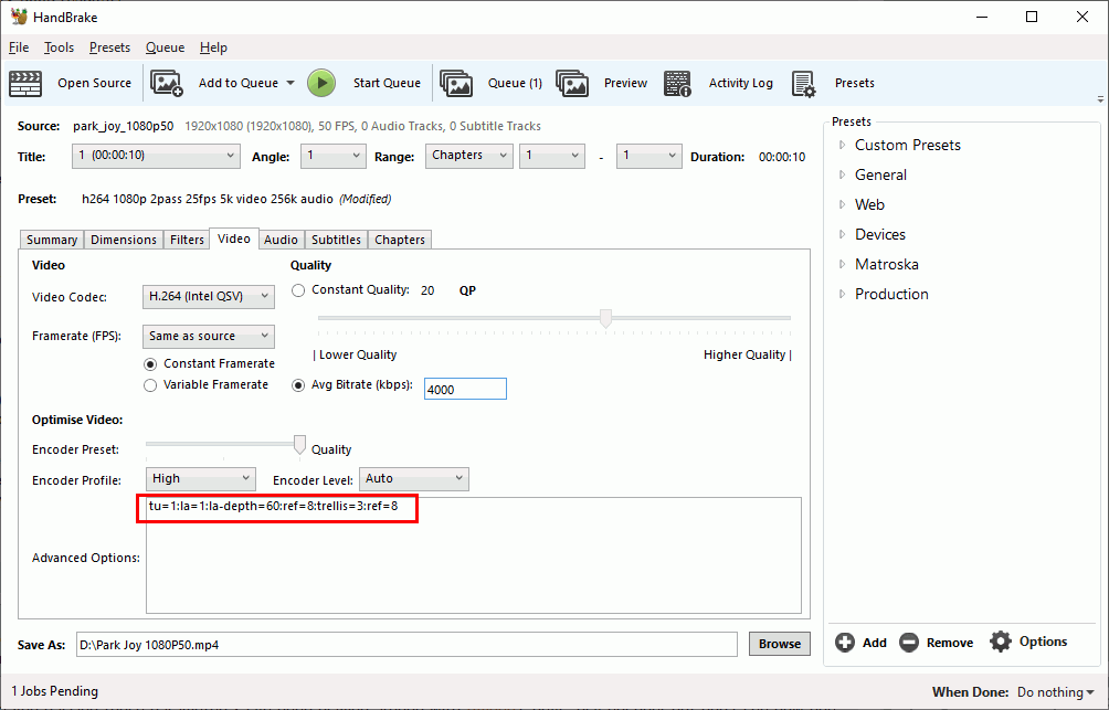

  7. Image
    [Attachment 56932 - Click to enlarge]
    Here you can see my favorite settings for Intel QuickSync (QSV) encoding mit h264.
    I use 8 ref frames, to increase compression (reduce filesize) and it produce more quality and a little bit sharper videos.
    If you prefer h265 encoding with Intel QuickSync, you will need more time to encode, but you will get better video quality!
    You can use my 'advanced Options' with H.265 (QSV), too!
    Some newer Intel CPUs (Skylake) support h.265 coding with 10bit, but I am not sure If there is any TV or video player who play them!
    This video format is a little bit sharper and show more details.
  8. Thanks for the reply. A while after I last wrote I figured you were using Handbrake.
    https://handbrake.fr/docs/en/latest/technical/video-qsv.html
    Of the settings you recommend, the hevc_qsv encoder appears support only tu (target usage, aka preset) and refs (reference frames), both of which I'm already using.
    ffmpeg ... vcodec hevc_qsv -preset 1 -refs 8 ...
