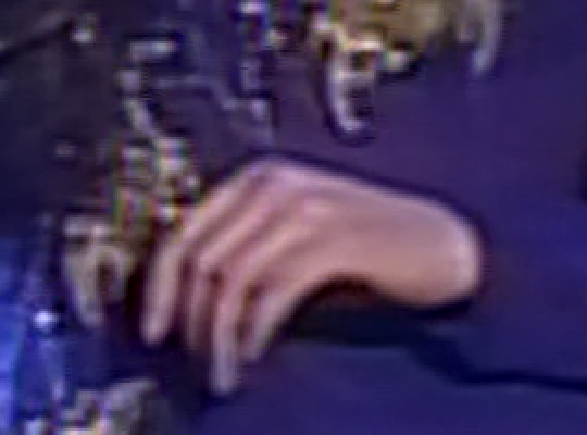

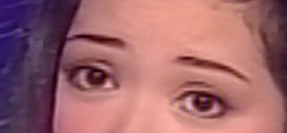

    Can you see the difference between these cropped screenshots between file 1 and 2 ? You said the same deinterlacing was applied to both, but clearly they are different. ( I' m not referring to the levels or color differences)
    1
    [Attachment 56851 - Click to enlarge]
    2
    [Attachment 56852 - Click to enlarge]

  17. Can you see this animated png ? If you use firefox or chrome it should animate if you click on it or open in a new window
    [Attachment 56853 - Click to enlarge]
    This is slowed down, but do you see those buzzing lines and jaggy artifacts ? This is from clip1
    Clip2 is not correct either, but it clearly has not the same treatment as clip1 . It's encoded progressively, but the 2nd field is slightly offset but really a duplicate, this results in the scan lines. But the fields that are encoded are potentially much cleaner than in clip1, because clip1 has be degraded by poor deinterlacing
    If you recorded it properly, then deinterlaced it properly, perhaps upscaled it properly, you wouldn't see those types of artifacts (or at least not as bad)
    The two video clips were recorded from the same VHS tapes through composite jack, then composite signal is converted to sdi and upscale to 1080 using all hardware. There was no post processing as to de-interlacing, frame rate conversions..etc at all to be honest.
    Ok, but clearly there are differences in the deinterlacing filter applied between the 2 clips. There are problems in both, probably avoidable problems
