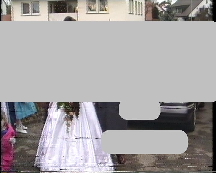

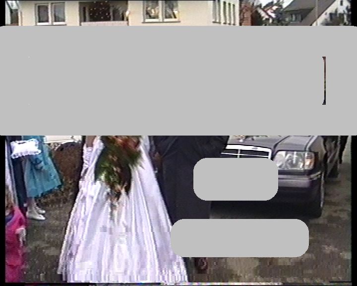

    The following is the same frame captured from the analog outputs of a Bauer VCC 816 AF camcorder and from the analog outputs of a Sony TRV-210E Digital-8 camcorder:
    Bauer VCC 816 AF:
    [Attachment 56816 - Click to enlarge]
    Sony TRV-210E:
    [Attachment 56817 - Click to enlarge]
    The Sony obviously does some sort of post-processing on the stripes at the bottom of the frame, so they become far less obvious.
    Can anyone tell me how to do this in software (VirtualDub / AviSynth) ?
    And what is the name for the phenomenon of these stripes?
    Cheers
    Ringo

    That processing called DOC (Drop Out Compensation), There is a chip inside VCR's and camcorders called DOC circuit that process that by replacing bad scan lines with good ones from neighboring lines, Obviously Sony does have a better processor than the other brand, they invented the format after all.

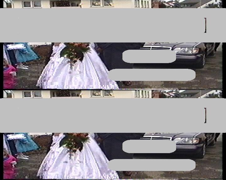

  4. I agree with dellsam34. If you separate the fields and view them separately you can see that the previous scanline is repeated, sometimes for several scanlines in a row, whenever one of the dropouts would have occurred.
    [Attachment 56827 - Click to enlarge]
