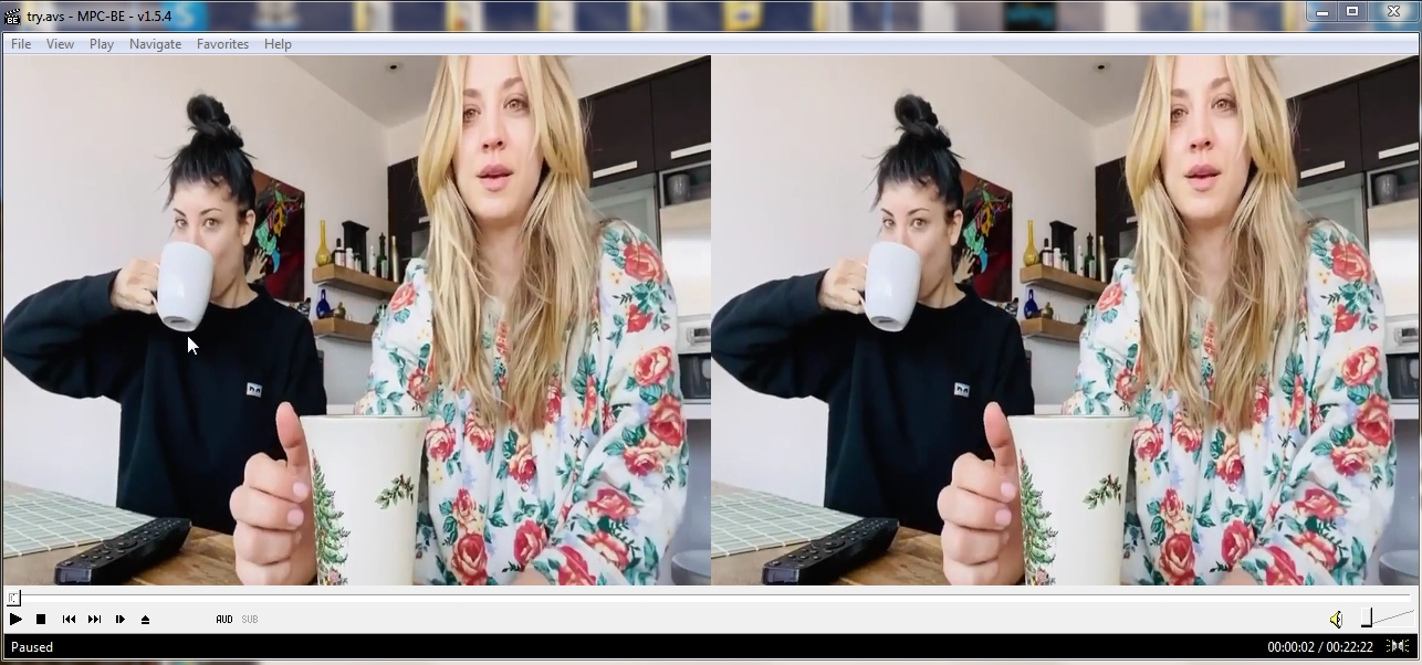

	If you have avisynth and ffmpeg all of the same resolution and you have a lot of these, I would just use a batch file to create an avisynth file:
 and then use ffmpeg to create your video.:Code:v1=directshowsource("c:\test\Instagram.mp4" ++ directshowsource("c:\test\xInstagram.mp4").lanczosresize(640,480) v2=directshowsource("c:\test\Instagram.mp4" ++ directshowsource("c:\test\xInstagram.mp4").lanczosresize(640,480) stackhorizontal(v1,v2)
 [Attachment 56803 - Click to enlarge]
 If the videos are all different sizes, you would need MediaInfo in your batch file to adjust individual resolutions as shown if the second file of each line .(They are different sizes)
 If its a straight drop and create this would be one method but if you need individual crop/zoom/pan/etc for each, its probably not the way to go. You would a windows drag and drop custom Gui
