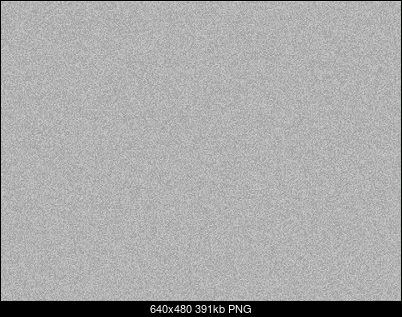

    I'm looking forward to create something like this with avisynth, it doesn't need to be exact, something to wave/shake/twist/distort the color bar or any other image or an effect like the old tv's with horizontal sync problems that make the screen to roll.
    I'm new to avisynth, hitting my head in the wall for some time I did manage to create this using NoiseGenerator and avisynth+ but don't know how to do the rest of the effects, googling for the terms I can find a lot of information about how to remove the noise and distortion but not how to create it:
    v1 = ImageSource("D:\TV-scanlines.png").NoiseGenerator(Gaussian=false, Amount=180, LumaOnly=true).ConvertToY()
    v2 = ImageSource("D:\TV-screen.png")
    Overlay(v2, v1, opacity=0.5)
    Thank you.
