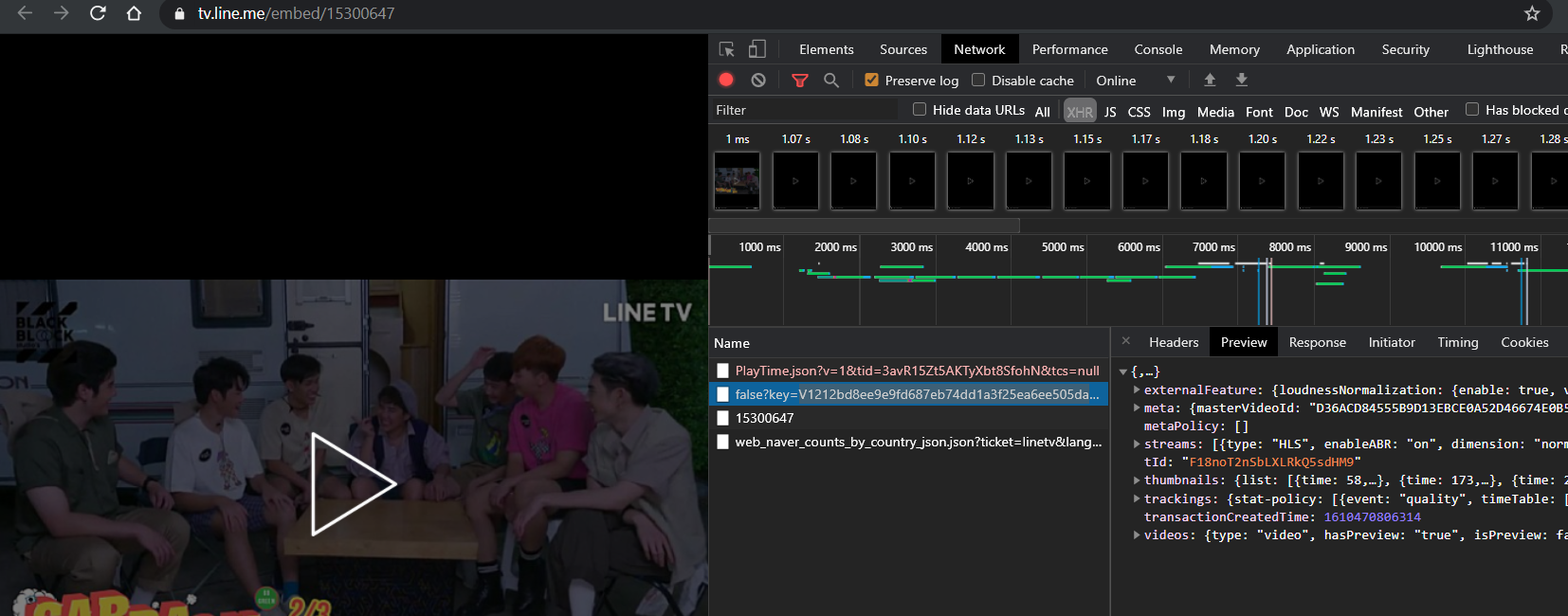

    yessss i mean how to get the tv.line.me/api/video/play link???? i think it could be work with vlive too???
    Mar 2019
    Germany
    Just look in developer tools.
    [Attachment 56762 - Click to enlarge]
    Jan 2021
    indonesia
    omg thanks!!!

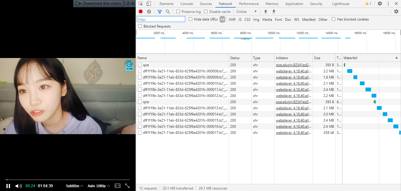

    now how about vlive??
    https://www.vlive.tv/video/228142
    https://www.vlive.tv/embed/228142
    Mar 2019
    Germany
    It is here.
    Search for that URL. You'll find the video files.
    Jan 2021
    indonesia
    It is here.
    [Attachment 56763 - Click to enlarge]
    theres only .ts i cant fint the apis.naver.com (

  13. Developer Tools -> Network -> find 'api'
    Jan 2021
    indonesia
    yes, but as you can see
    Mar 2019
    Germany
    You're opening developer tools too late. Just leave it open and refresh the page..
