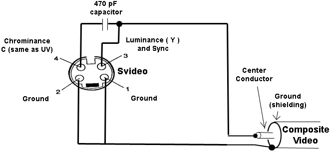

    If by DIN you mean s-video it should be easy to make yourself. see attached image.
    the distortion i see in your video, looks to me like bad tracking, if this is not adjustable the player needs adjustment, or repair

    Video2000 with S-Video? Unless the manufacturer time traveled, there was no such connection in that era.
