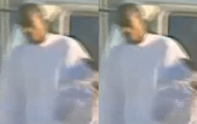

  1. Lately I got into Avisynth and VapourSynth and managed to get both installed and working on windows. My goal was to try and repair a progressive video that was already deinterlaced but now has pretty serious combing artifacts. I don’t have access to the original interlaced source.
    Here is an example of what is going on:
    [Attachment 56701 - Click to enlarge]
    Spline36Resize(width, height/2).Spline36Resize(width,height)
    This helped a bit at the cost of some details.
    What functions could I use to try to fix this?
  2. Originally Posted by dabbdubb View Post
    It's hopeless. It was resized vertically before being deinterlaced.
    But, you should post a link to 10 seconds of the video and not a picture.
  3. You can keep more detail by masking parts of the frame that don't appear to have comb artifacts (ie, areas without comb artifacts are not resized so they keep all their vertical resolution). But yes, a sample is required.

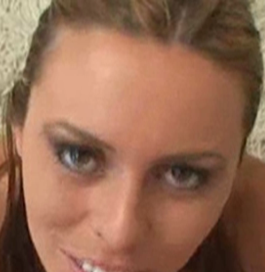

  6. I got it to work with small adjustments:
    • I used an older version of QTGMC because the latest one kept throwing an error when it didn’t know what to do with AvsPlusVersionNumber() even though SMDegrain version was > v3.1.2.101s. It worked with QTGMC-3.32.avsi, could probably use up to v3.361s if I searched for it.
    • Removed the DVD resize as I didn’t need it.
    • Changed second(first in main) call to Spline36Resize to Spline36Resize(width, 240)
    • Changed third (second in main) call to Spline36Resize to Spline36Resize(width,480) since that is the height of my video.
    • Lowered mt_binarize(6) to mt_binarize(1)

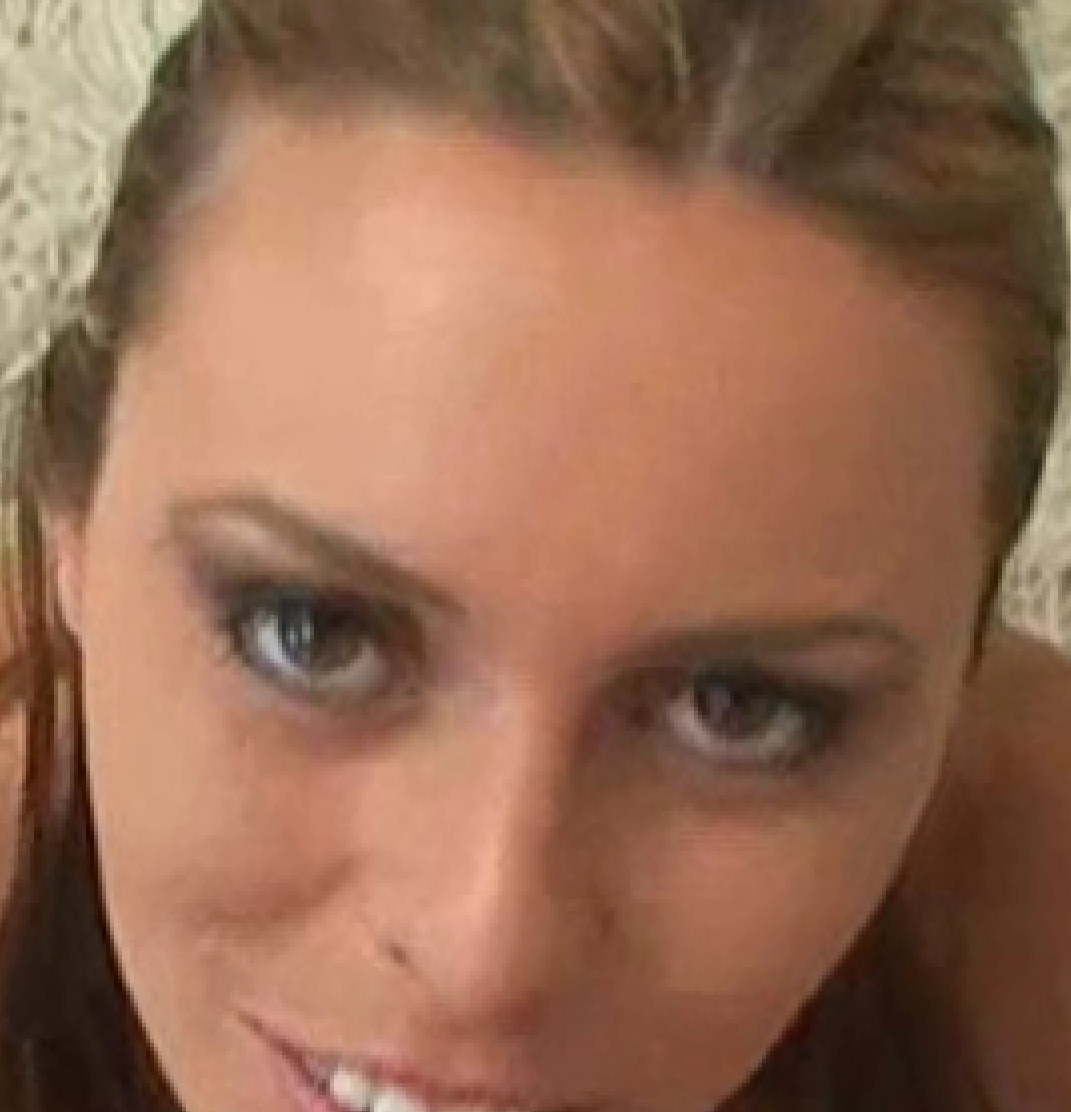

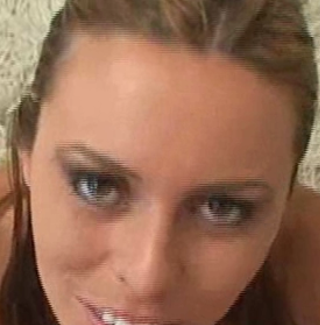

    Here are the results:
    The script did work better than what I was originally doing with just resizing it vertically (below).
    But ultimately, the source is too far ruined to really fix it well. I’ll see what I can get out once I run it through VEAI. I appreciate the effort it went into it because it did objectively improve the video, no doubt.
    Original video first, simple resize second, with jagabo's script third:
    [Attachment 57158 - Click to enlarge]

    I guess the only way to fix it would be to obtain original DVD with interlaced video, unless they already scrapped that and only sell deinterlaced.
