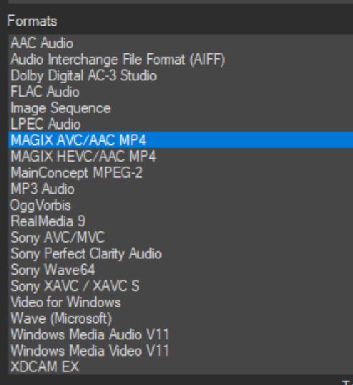

    These are the formats in my Customize Template
    https://forum.videohelp.com/images/imgfiles/MloogoH.jpg

  9. For example, it's using 11 reference frames. Magix AVC I think uses 2, and zero b-frames (when it was Sony , at least) ie. It's not using all AVC features to improve compression, and you have to means to adjust them. It's a limited version that does not allow access or control of some important parameters
    You can't use Magix AVC with low bitrates; if you want AVC video, you have to use another workflow, such as voukoder out of vegas, or debugmode frameserver , otherwise you're stuck with using higher bitrates to get decent quality
    https://www.voukoder.org/
    You can try Magix HEVC, not sure how good it is . It's HEVC, so 1 generation later than AVC. Potentially better. But there is wide variation in HEVC encoder quality .

    I am recording video using a GoPro.
    Resolution is 2.7k (2704x1520)
    60fps
    I am using Vegas Movie Studio 16 Platinum.
    I only see output settings for 4k and 1080p.
    So, I think the render is taking a lot longer since it is rescaling the frames.
    How can I output without resize and just stick to 2.7k output video ?
    Make Movie -> Advanced Options?
    MAGIX AVC/AAC MP4 ?
    MAGIX HEVC/AAC MP4 ?
