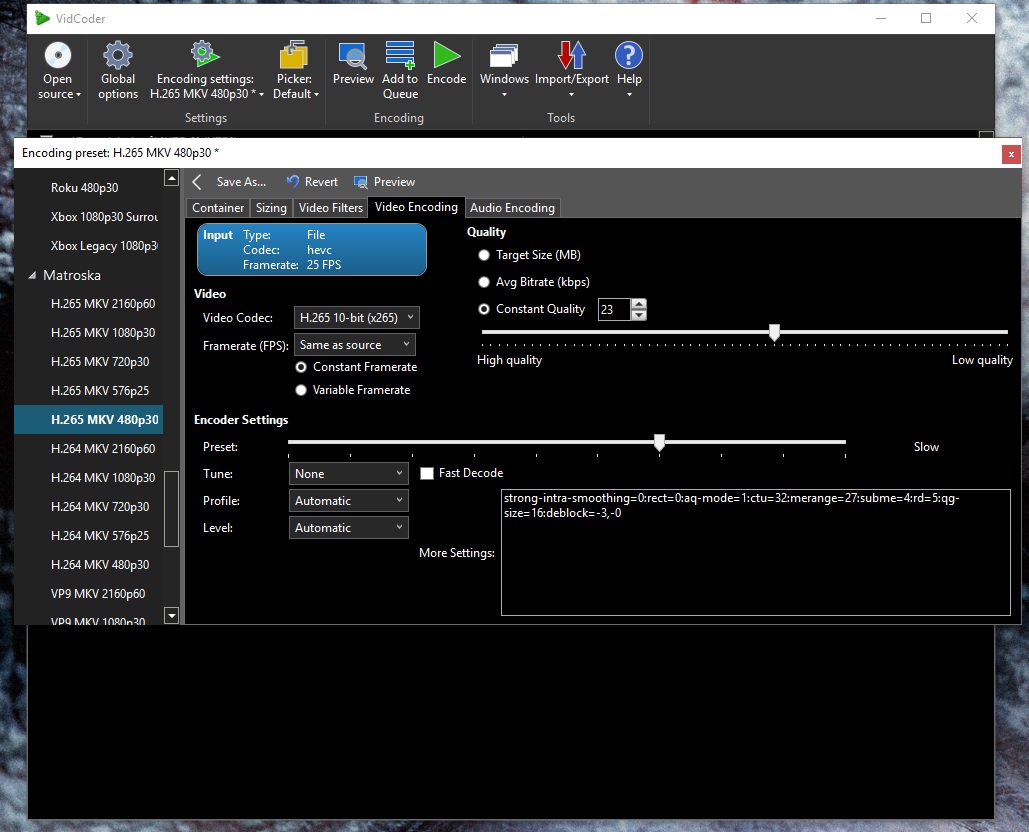

    For DVDs I'd suggest the following settings while using preset slow and CRF 23
    In more settings add the following
    PHP Code:
    strong-intra-smoothing=0:rect=0:aq-mode=1:ctu=32:merange=27:subme=4:rd=5:qg-size=16:deblock=-3,-
    Audio, its up to you but ACC 128 Stereo, or even old fashioned MP3 is enough.
    [Attachment 56644 - Click to enlarge]
  13. Originally Posted by jagabo View Post
    Nothing wrong with using floats for crf.
    Thanks for the reassurance. I am doing tests now with different quality values to explore the produced file size and the quality.

  15. Originally Posted by glenn1962 View Post
    PHP Code:
    Thanks for the settings that you provided. I have no idea what they mean but I will try to find out. I just had a look at the settings used for a TV Series from the WEB H.264 RIP and I was amazed with the amount of settings they mentioned.
