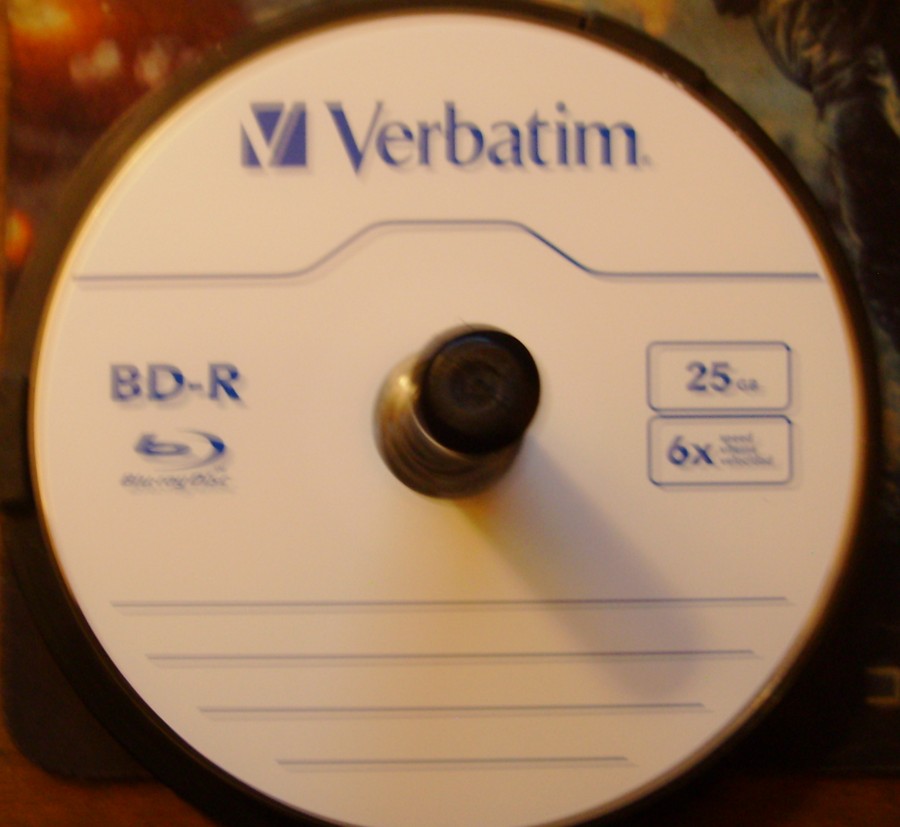

  3. probably was imgburn. and for name on the discs, do you mean use software to read the MCM-000 or what the disc has on it? they are white , says Verbatim at the top with a V blue logo blue text.. and BD-R on the left side with a bleray disc logo, everythign blue, amnd 25gb 6x speed on the right, with 4 lines at the bottom for writing on.

  8. it doesnt have lth on it. i was just wondering if anyones ever heard of this or knows what this drives deal is. Ive never heard of this before and I would .. might of heard of a drive starting to hate discs it once before liked. I didnt update hte firmware before this happened or anything ilke that. I did try the other night to update the firmware to see if it would fix it.
    The discs do not have that LTH on them. just some confirmation that its blown from somethign else similiar that i can cross reference it to is what i was looking for before i tossed it away.. just cant believe this nice drive blows, barely even burnt 100 discs id guess in the 5 years ive had it.

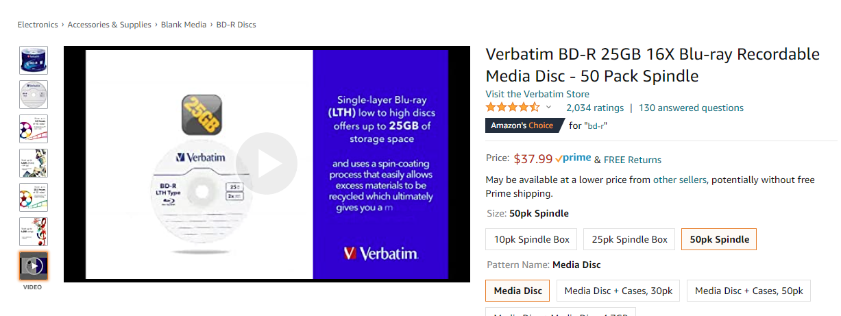

  9. aBigMeanie aedipuss's Avatar
    Oct 2005
    666th portal
    that's a screenshot from the link YOU provided to the discs you bought.
    https://www.amazon.com/gp/product/B00GSQ4DBM?psc=1
    look at the item image on the amazon page labeled video.

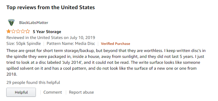

  11. Heres a big fat waste of 10 minutes of my time. i said what they had wrote on them. you found a picture in their advertisements of a disc labeled LTH. my comment said what was wrote on them, so i uploaded and took a picture and cropped it and resized it.
    so ok you're saying all of these discs are lth, every single one of these. even thought, I read/thought that they had to label LTH as so. and the picture of ONE of their discs shows LTH. and one comment on amazon reads "The write surface looks like someone spilled solvent on it and has a cool pattern, and do not look like the surface of a new one". sounds like to me that one single review/guy spilled some crap on his discs and lost them all and has them all stored in the same area. yea, here quote "I keep written disc's in the spindle they were packaged in," that what my detective work led to; he destroyed them all at once himself. theres 100's and 100's of good comments abotu these discs. and it only has 3% 1 star reviews. 82% 5 stars. out of 2034 total reviews. i think i uploaded a picture of mine. it doesnt state LTH, and you'd think the company that does list LTH on some of their discs and required lth be approved so they made LTH be required to be stated on those discs, would follow that. my discs dont say lth and there are some saying lth you showed with the picture in the worst reviews you could find which they will list something like that on their page. reaching for the worst,

    the other guy with issues was describing the appearance of the written surface that were stored ok. turn your bad ones over and look closely at the dye layer. any wavy/discolored area is an indication of disc rot. bdr lth discs were advised to label them as lth but it wasn't "required".
