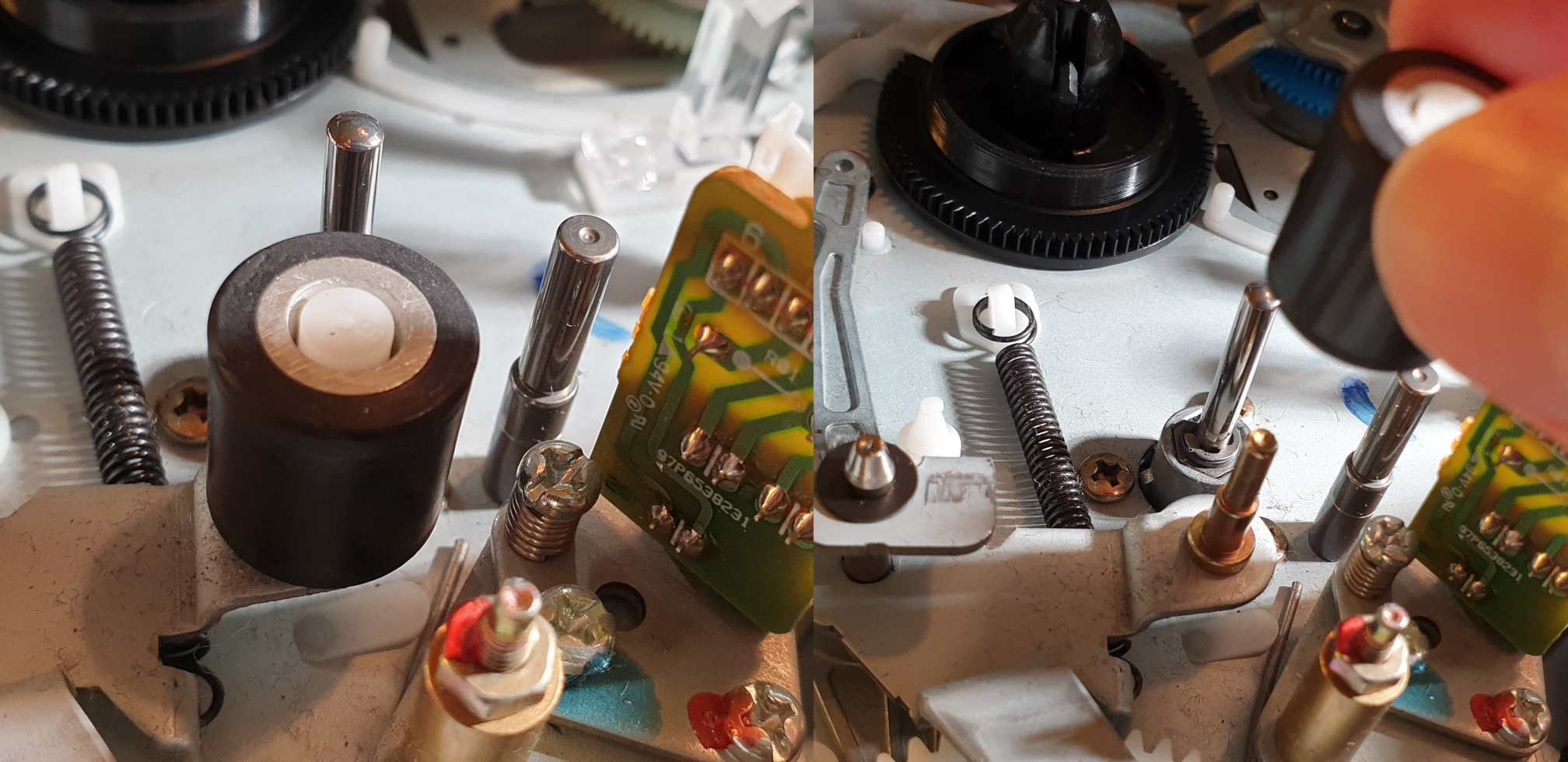

    The pinch roller is pretty shiny and feels smooth to the touch, so I'm leaning towards that it doesn't get enough traction on the longer tapes and needs to be replaced. However, I'm unsure where to find a replacement. I managed to access the pinch roller and measure it.
    Height: 17 mm
    Diameter: 15 mm

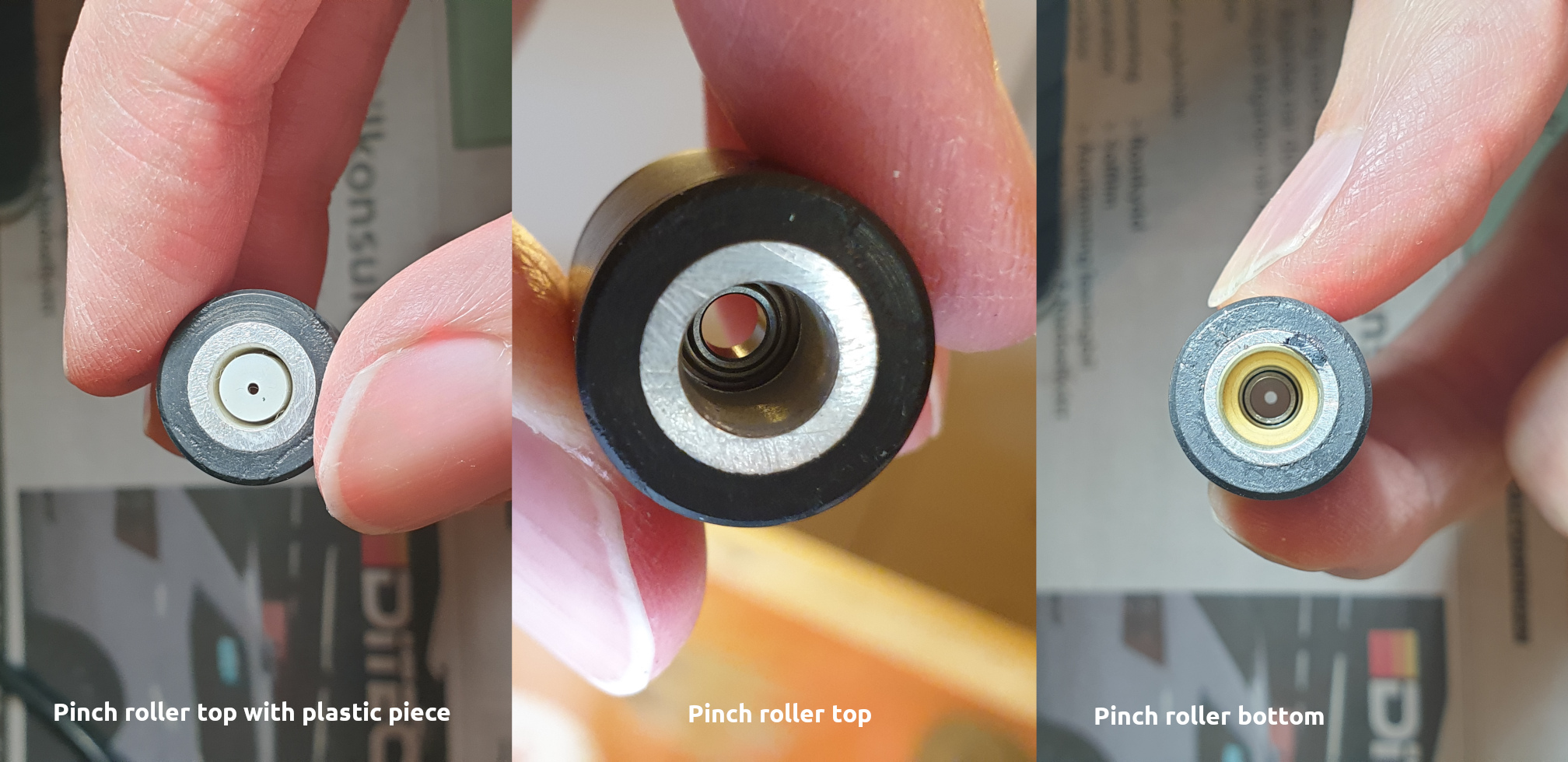

    Inner diameter top: 6 mm
    Inner diameter bottom: 7 mm
    [Attachment 56579 - Click to enlarge]
    What puzzles me is how the pinch roller looks inside, with 2 different inner diameters and some kind of separator inside it. When mounted, it has a white plastic piece on top of it which holds it in place. Does other pinch rollers look like this or is this a custom variant?

  2. That is normal pinch roller construction.
    To figure out whether the pinch roller is your problem, you might want to first apply some rubber rejuvenator. It is not a permanent fix, but it often temporarily restores enough pliability to the rubber that it will function normally for awhile.
    If you find that you get an improvement and want to replace the part, there are places which rebuild pinch rollers, idler wheels, etc. However, it is usually a $50-80 investment.
    There must be some repository of parts somewhere from all the service shops that used to repair VCRs. I was looking for a PE turntable idler wheel a month ago and could only find the rebuild services, but you may have more luck with your part.

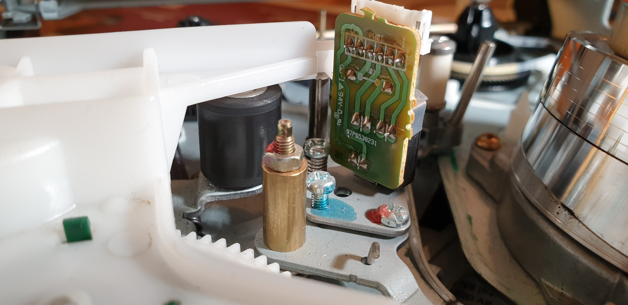

  9. Well, here's an update - the part came in the mail a few days ago and I also figured out that I only need to remove 3 screws in total to get the machine open and access the pinch roller (a lot easier than when accessed the last time). Even though the inner part is different (if you give the original part a spin, it spins for probably 30 seconds, this one less than a second), the pinch roller still fits and the rubber is fresh - and that seems to make all the difference. Now I am able to rewind the tape without any trouble (in fact I rewinded all the tapes I had so I could store them properly) and have used the VHS for a few hours today. So it seems to be a success!
