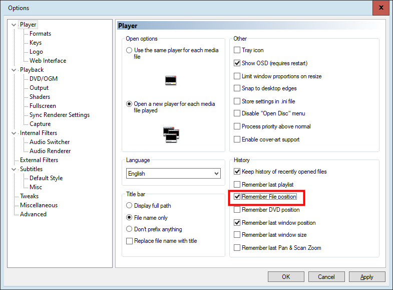

    But once again, why don't you just enable the player's "remember file position" feature? With that you can quit at any time you want and the next time you play the file it will start playback at that time. Most players have that feature. For example Media Player Classic Home Cinema:
    [Attachment 56607 - Click to enlarge]
    The feature has slightly different names in different players. But it's found in MPCHC, MPCBE, SMPlayer, VLC. Potplayer and KMPlayer have a variation of this where they automatically resume the last video when started.
