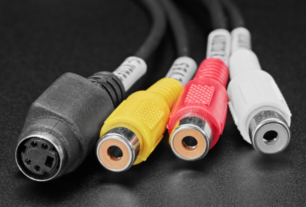

    I was offered an old TV for free, a Sony Trinitron KV-27V20 which I’ve been told is S-Video. I want to use this TV for old VHS tapes and occasional retro gaming. When it comes to hooking up a VCR to this TV how do I make sure that the VCR is S-Video compatible? For instance, I’ve found someone giving away a Sony SLV-585HF VCR but I have no idea if that will work with this TV. Any help would be appreciated. Thank you and Happy New Year!

    the tv will have s-vid inputs along with composite. you will be able to hook up most analog equiptment. you'll see inputs like the picture below and need cables that match. you either use the s-vid 5 pin with left/right white/red audio inputs or the yellow composite connector along with the audio.
    [Attachment 56506 - Click to enlarge]
    [Attachment 56507 - Click to enlarge]
  3. The TV will accept s-video, composite and rf input, so there is nothing to worry about on that end. However, that is not an s-video deck so you will be limited to composite or rf.
