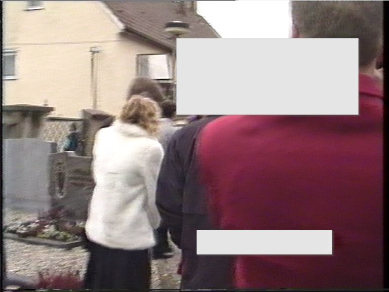

    I attached a screenshot of an AVI that I captured with a Sony Digital 8 camcorder from a Video 8 tape.
    [Attachment 56472 - Click to enlarge]
    There is a vertical stripe with falsy colors on the right of the video, about 10-12 pixels wide.
    The stripe appears most obviously as a green stripe on red areas, as it does on the red jacket in the screenshot.
    What is the reason for this?
    And can I prevent it, e.g. by trying another camcorder (which I do not currently have)?
    Or is this on tape?

  3. That's typical of Sony D8 caps of (Hi)8mm tapes.
  4. I cannot say that for sure, because my flat TV does not show the full size due to overscan and the overscan seems uncustomizable on that source.
    But my guess is that the camcorder does output the stripe.
  5. jagabo, so you're saying, it is not on the tape?
    So buying a fully analog camcorder is worth a try?
  6. I don't know if it's on the tape or not. But many people using Sony D8 camcorders report the same issue. Sometimes much worse than yours.
    The discoloration can be fixed by smearing the color near the edge over to the edge.

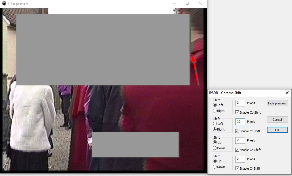

  12. Thanks, I've tried the chroma shift, but it doesn't seem the solution!
    By shifting CR by 8-10px to the right, the stripe is gone, but now the rest of the image is shifted too far, as can be seen on the OSD menu "shadow" that I marked in the screenshot:
    [Attachment 56488 - Click to enlarge]
    So, I guess I'll try to get a fully analog camcorder.

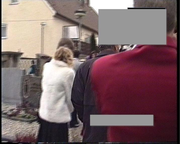

  16. Here I took the colors from near the edge and spread them to the right to fill in the discolored area:
    [Attachment 56501 - Click to enlarge]
  17. Originally Posted by jagabo View Post
    Looks good! I guess you did it with photoshop or the likes?
    No, I did it in AviSynth. The technique works with full motion video. Of course, there will be some color misalignment depending on the particular video. Unfortunately, I deleted the script and emptied the trash. I can recreate the script if you're interested.
