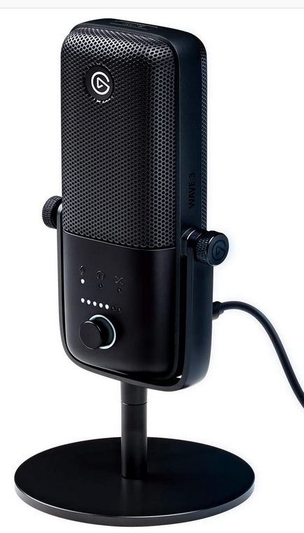

  4. I purchased this one a week ago and it seems to be pretty good. I use it mostly for Zoom meetings but since it's a USB mic, maybe it would work for you.
    https://www.amazon.com/Elgato-Wave-Microphone-Podcasting-Capacitive/dp/B088HHWC47/ref=...32486464&psc=1
    Perhaps! Thanks for the link and sharing your buy.
    - What made you pick it over the others?
    - Were there any runners-up you had been looking at?

    You'd also be happy with a USB-enabled mic made by a known mic manufacturer.
    The more I look at the Elgato (ironic, huh?) the more I'm liking it.

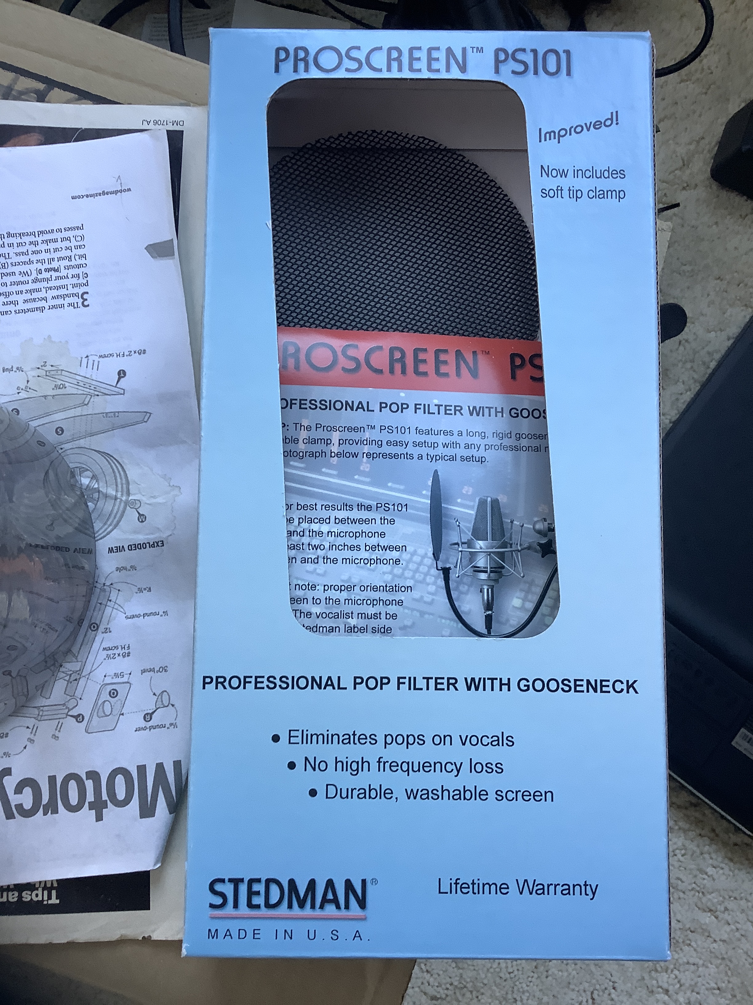

    I splurged on my pop guard and got a Stedman ($48), but I got a lesser one (a $20 Nady) for my son which would probably work almost as well.
