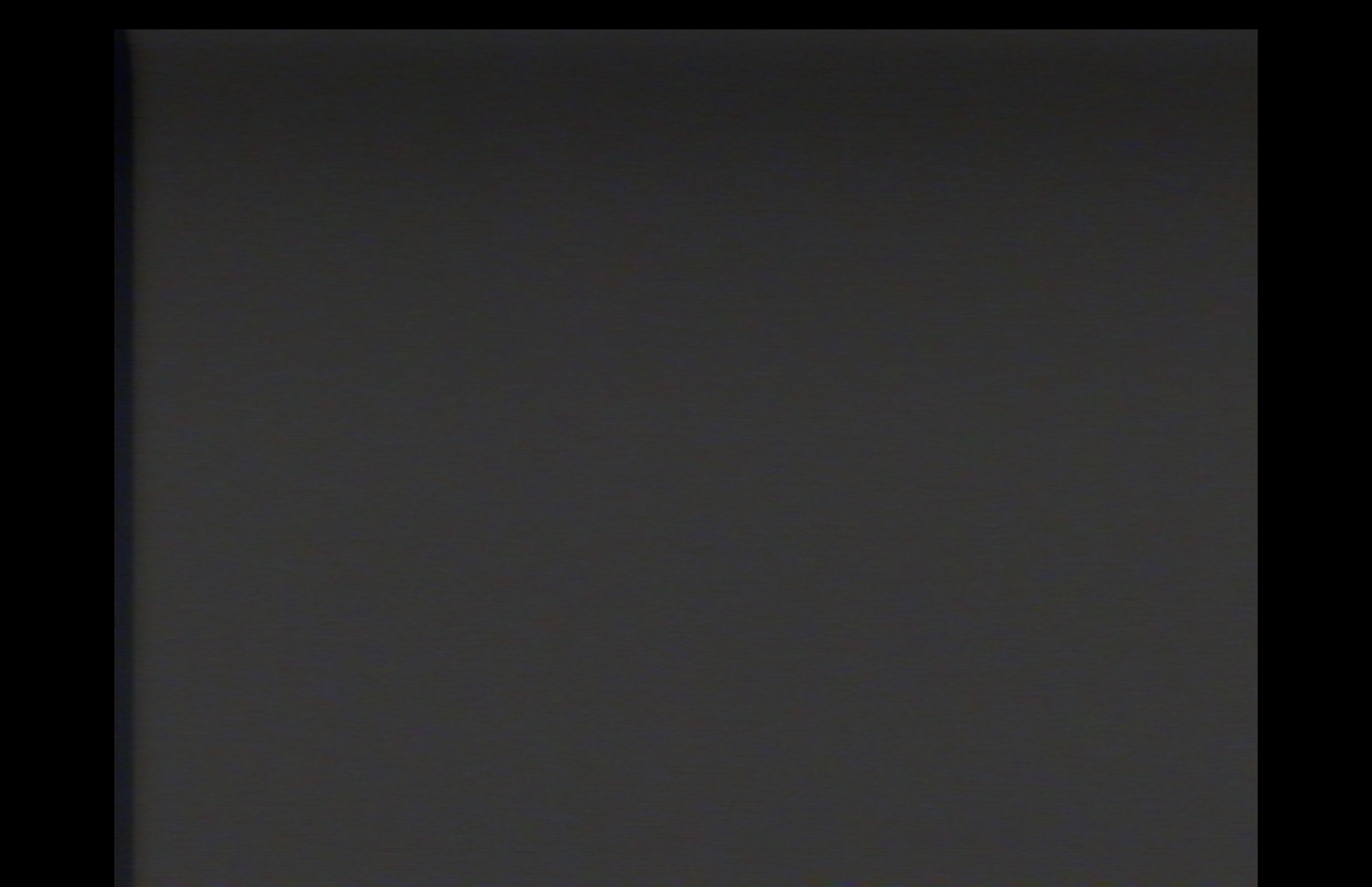

  15. Hmm, I ran a composite output into the DPS-235 to bypass the DPS-210 and resulted in the same skew error. Image
    [Attachment 77635 - Click to enlarge]
    Here's a screenshot of the skew in the top left corner; I'm not totally sure if this is an issue or just part of what the tape medium is like, but that is the skew/border we get on all our transfers.

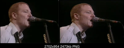

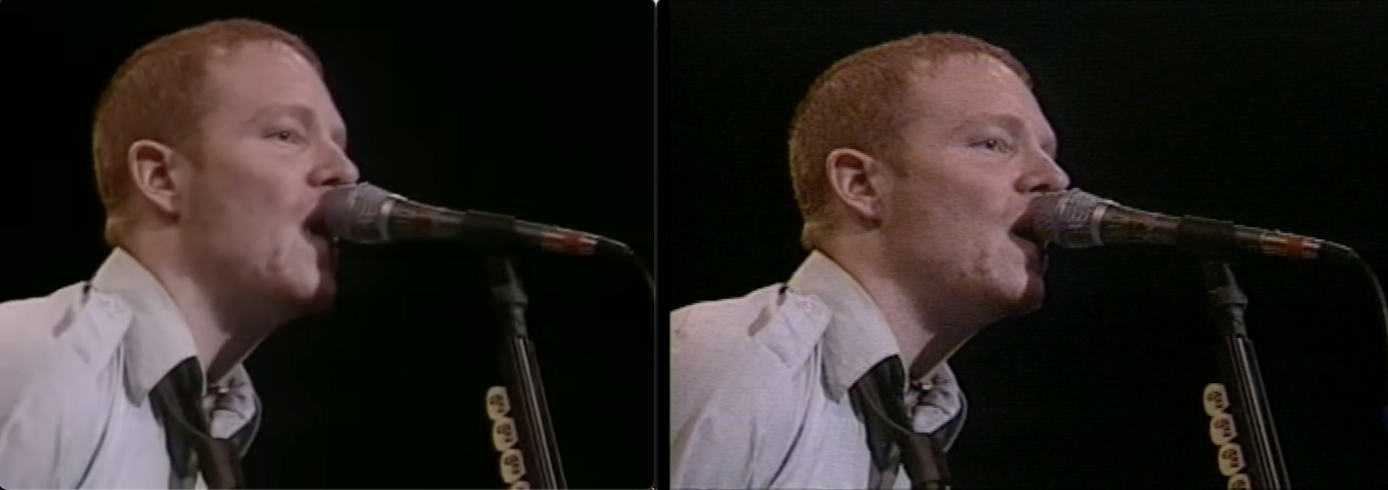

  19. I've got a few U-Matic decks and I have access to a DomesdayDuplicator, but having some issues getting it to run with the current version of their Mac install. I might have to drag out the Ol' Windows tower PC and try it with that.
    This was the best I was able to get out of a mid-tier VP9000 machine versus what's on YouTube from a Umatic copy of Open Road Song from EVE6, so I'm curious to see if a Domesday Duplicator copy looks significantly better or not.
