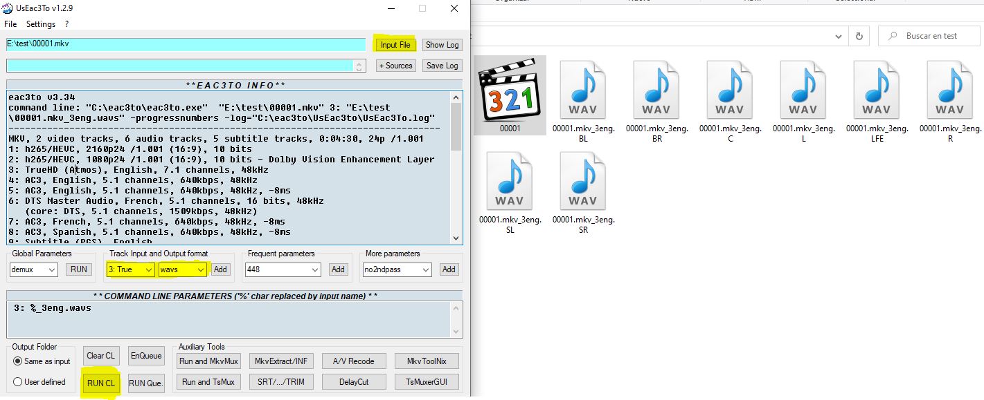

Hi there,
I have an mkv with Dolby Atmos audio. Can someone please describe the "easiest" way to extract each channel to a Mono Wav?
Thanks,
tarf
Results 1 to 12 of 12
Remember that you will only get the basic flatbed 7.1 channels.
Atmos data will be lost. -
No. It's not, via extraction. To be converted to a standard (read: non-object-oriented) format, you would have to render it. (What you hear is what you get). Which requires an already Dolby Atmos-supporting system.
And you had better render it using the layout you use in your listening environment otherwise the sound will be "off".
