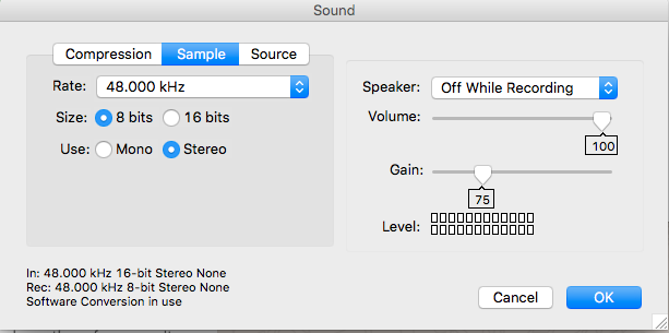

  1. Bear with me. This is an audio question. I have captured many hours of VHS recordings on my mac using VideoGlide from EchoFX. Stupidly I didn't check it all properly. Got rid of the tapes and then found my sync problem. I know what the issue was now. In the VideoGlide audio settings, I have a choice of 'Size' - 8 bits or 16 bits. I have to be honest. I don't know what that is or means. But it was set to 16 and when I changed it to 8 - problem solved.
    What I want to know is - is there any way to fix the captured files by separating the audio and making it the length/speed, or whatever the 8 bits setting would have done before putting it back with the video?
    Cheers
    Phil

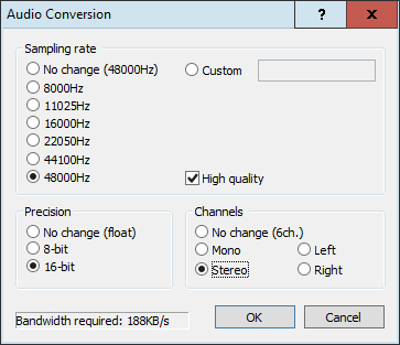

  10. Pretty much every video editor will allow you to change the audio sample size and sample rate. Here's VirtualDub2's Audio -> Conversion... dialog:
    [Attachment 56395 - Click to enlarge]
    But capturing 8-bit audio is a huge compromise. I highly recommend you figure out how to get 16 bit audio capture working properly. For video you should usually be capturing 16 bit, 48000 Hz, stereo (2-channel).
