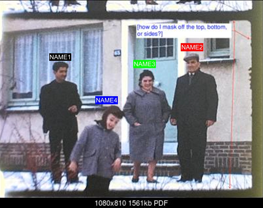

    1. There are many scenes where there's 5-10 people walking towards the camera. Looking for advice on how best to "label" each person. Maybe do a screenshot with labels on each person and show that for 5seconds before the scene starts?? (per the attached example screen grab)? Or maybe some type of subtitles??
    2. also, I'd like to mask off some of the overscan areas, like top and bottom and sides, where telecine machine was out of alignment. Is there any easy way to do that?

    For the text, an external subtitle which you turn on and off throughout playback (see srt format) is the easiest option so then you are not re-encoding your video.
    Now I am not familiar with the device you used but I do know how cine projectors work (done some transfers in the past) and the very least you should be able to do is centre the image with that gate adjustment knob since your result is pretty poor.
    If you can not nor wish to re-do the transfers then I would use avidemux to crop both top and bottom and the right. If you want to retain a particular aspect ratio you can then add a border. But I can not help thinking that the people in the picture are a little shorter than they should be. Another sign of a poor transfer.

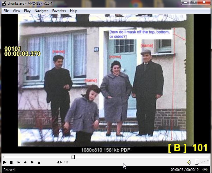

    Johnmeyer has the best write up for your problem. I do not have the hang of Movie Studio Platinum yet so I free tools to display times during video where you wish to place subtitles.
    [Attachment 56621 - Click to enlarge]
    Aegisub is a great ASS subtitle creator utility but I find it easier to create a simple text SRT subtiles file with the placement noted as a separate line as I view the video. Converting SRT to ASS format is a VERY simple task with FFMpeg. I change the placements using the extra line and then delete them.
    Now you have an external subtitle file playable in almost all players that does not alter your video quality.
