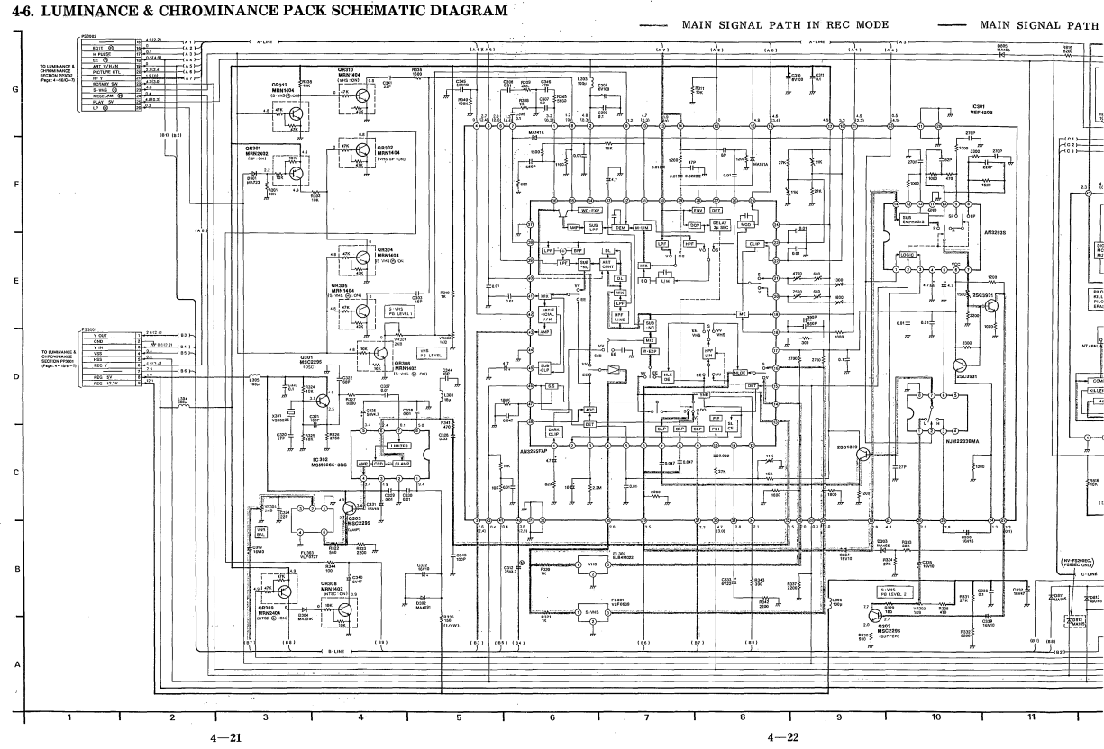

    As LordSmurf and I noted, the closest PAL equivalent to the AG1980 was the NV-SF200. From that basic fact, things proceed to get a bit more complicated and shaded in UK vs USA.
    I'm not sure it is, when you look at the service manuals, the NV-FS200 is nearly identical to the AG1970, e.g:
    NV-FS200
    [Attachment 56513 - Click to enlarge]

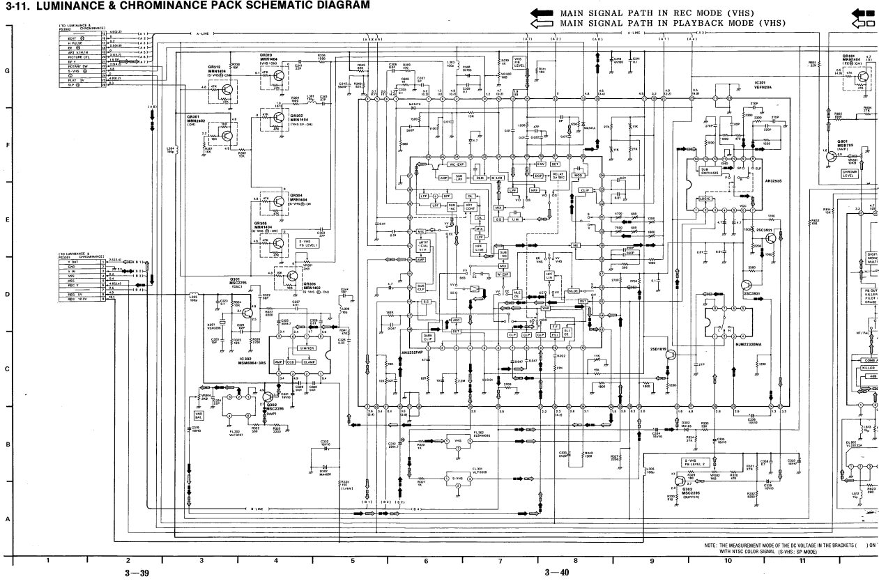

    AG1970P:
    [Attachment 56514 - Click to enlarge]

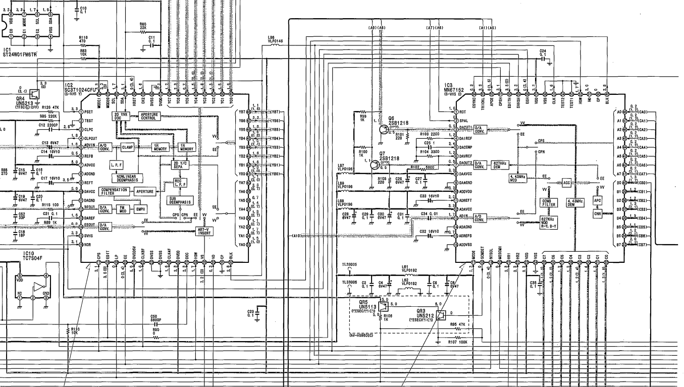

    The PAL model that has most in common in the video decoding path with the AG1980P is the NV-HS950 which uses a lot of the same chips and the same mechanism (K). The pcb and general layout of the machine is a bit different though, it being mid-mount with the pcb below the mechanism like newer units. The AG1980P also seems to have 2 additional video head connections on the head amp schematic, not sure if it had 2 more heads or if it's some other thing.
    NV-HS950
    [Attachment 56515 - Click to enlarge]
    AG1980P
    [Attachment 56516 - Click to enlarge]

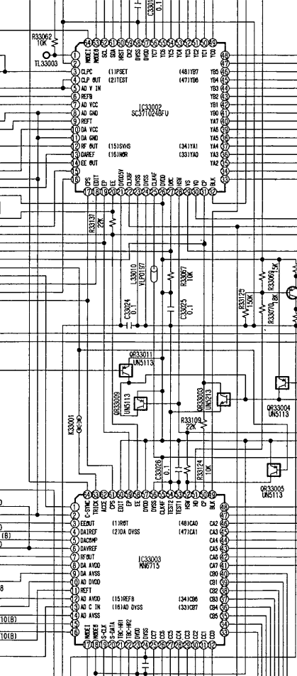

    The NV-HS1000 seems to sit somewhere in between the FS200 and HS950. The mechanism (K mech), video and system chips have been updated, and it has a TBC, but with otherwise analog video decoding and noise reduction. There is a HS800 which is idendical except no TBC, and the HS900 which is similar to the HS950 but without TBC and digital decoding (video chips seem more similar to the HS1000/800).
    The syscon chips all of these in them have slightly different, but seem to be related.
    The HS850 (non-TBC model which seems be between HS950 and HS860 age wise) ,HS860 and HS960 moved to use the z mechanism, though seems to also use some digital video decoder circuitry still with 3d noise reduction, albeit with different chips, at least on the 860. The HS960 seems to be similar to the 860 with some extra features and share the same manuals.
    The later 830, 880, 930 and non-TBC 820, 825 and 870 seems to have moved back to a more traditional setup, with a video IC that looks suspiciosly similar to one JVC used in their later models (just noted with a part number in the schematics, but the pinout seem to be the same), and some off-the-shelf TBC/DNR/YC sep chips from Toshiba (TC90A88F, TC90A79AF TC90A11F).
    NV-HS880:
    [Attachment 56520 - Click to enlarge]
    JVC HR-S6950:
    [Attachment 56521 - Click to enlarge]
    The late models NV-SV120/121 I haven't found much on so I don't know what hardware they use, though I think they use a further cost-reduced mechanism at least.
    The consumer non-SVHS PAL models meanwhile seem to just be progressively tweaking the same design through NV-HD and NV-FJ models. They are completely different from the models released in the US, the US ones seem to even use a different mechanism not seen on the PAL ones. There are a few multi-system ones variants of them though and some ""pro"" ones like the AG25xx models that look similar on the outside and maybe have similar hardware that come in NTSC versions.

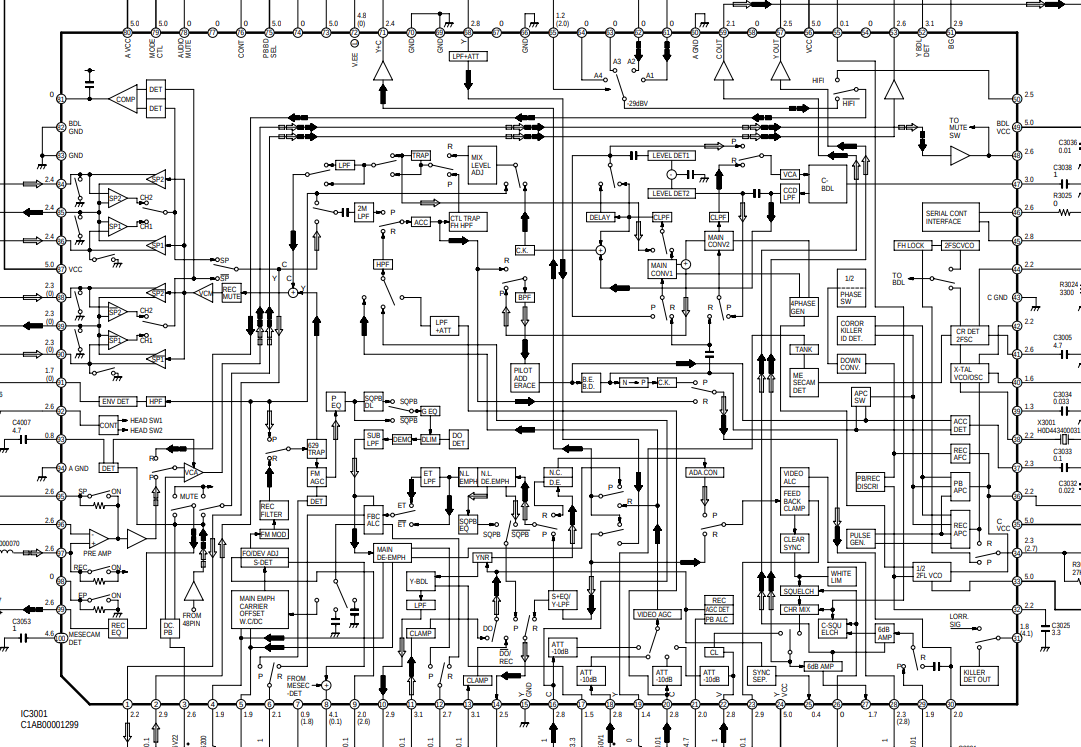

  10. Wow: thats some great detective work, oln! Excellent info for anyone needing a starting point for parts or repairs: I don't think I've seen this exact collection of details all pulled together in a single post anywhere before. Thanks!
    Re the NV-SF200 and AG-1980 confluence: the reason LS and I (and others) consider the 200 the closest PAL approximation to the NTSC 1980 is tradition and availability, along with the outer similarity. As the 1980 is the most recognized and well-known North American Panasonic, so is the 200 in EU (UK particularly). Long story short, no PAL Panasonic prior to the 200 equaled its TBC/DNR performance: the benchmark it set was matched by later PAL models but not significantly exceeded. In that way it equals its NTSC cousin: no Panasonic before or after the 1980 equaled its performance- it set the benchmark. The 200 was the first in a line of high performing TBC/DNR PAL Panasonics, its rough contemporary the 1980 was the first (and only) NTSC Panasonic with equivalent TBC/DNR performance. While they may be far distant internally, the end result is what matters: by that metric the 200 was the first, most popular PAL to look like, operate like, and perform like the 1980. Or vice versa: its unclear whether the 200 or the 1980 arrived first on the market.
    The difference in video formats seems more significant than one might imagine. While the 200 shares more general DNA with the NTSC 1970 than 1980, the performance of the 1970 elements in PAL guise is distinctly better. The 1970 is a lovely deck with mediocre video performance: strip out the lame TBC and phantom DNR, drop the original retail list price by $400, and its quite competitive with other NTSC SVHS vcrs of the early-mid '90s. Its sturdy, nice to operate, tracks great, and has decent (if not remotely impressive) video output. But at its original list price, it was a joke when tested against comparable JVCs: much more expensive, with nothing in the video to justify it. JVC TBC/DNR was like flicking a light switch in a dark room: huge noticeable difference when active vs inactive. The effect of the 1970 TBC is almost imperceptible except with the extremely rare range of tape defects it can fix, the 1970 DNR (if it actually exists and is connected to anything) shows no visible effect.
    The PAL 200, by contrast, has a video presentation competitive with similar JVCs. The 200 TBC and DNR actually seem to do something when switched in and out. Much of the internals may match the 1970, if so those bits work way better when optimized for PAL than they do when pitched for NTSC. Panasonic needed to really step it up in the 1980 revision to finally reach NTSC TBC/DNR parity with JVC, while descendants of the PAL 200 either maintained the same performance or faltered a bit (other than the anomalous 860, later models do no better than 200 output). So in PAL regions, the shift from 200 to later models was not nearly as dramatic as the NTSC shift from 1970 to 1980.
