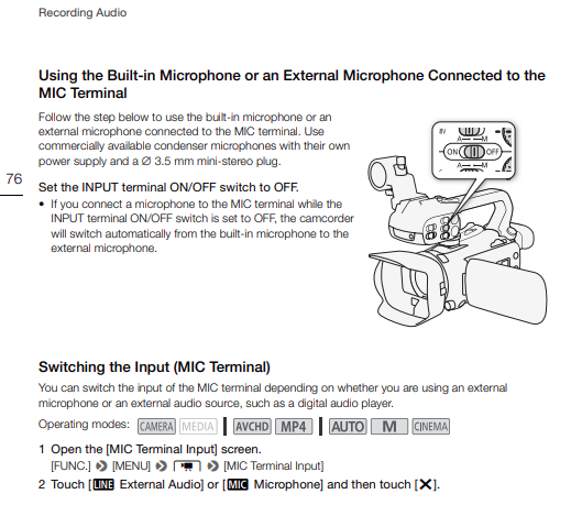

from page 76 of the xa-11 manual if you use the 3.5 mic connector it has to be a condenser mic with it's own power supply.
[Attachment 56357 - Click to enlarge]--

By George, I think you've got it!
The XA-11 packaging only included a 32-page manual, so that item wasn't included.
Many Thanks, Aedipuss! -
So I purchased a powered condenser shotgun mic--a TakStar SGC-598--and paired it with the Canon XA-11...
Voila!
Got great audio on playback!
Problem solved, many Thanks again, Aedipuss. -
