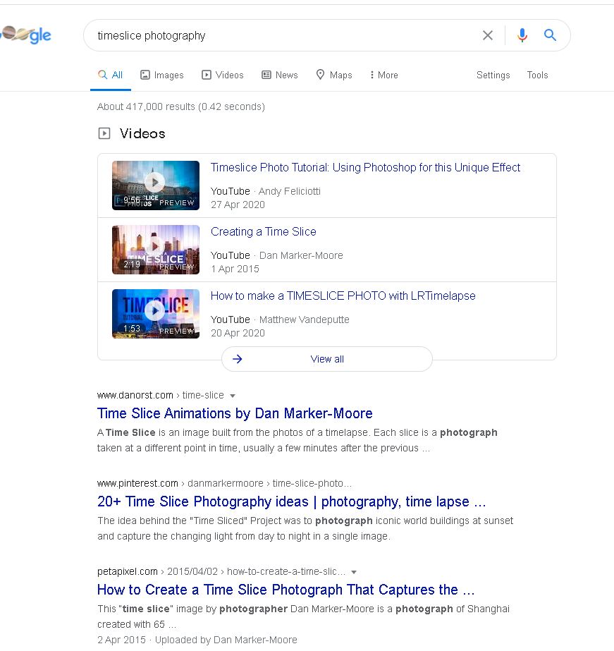

  10. The technique is called timeslice. If you Google "timeslice photography" you will find plenty of posts.Image
    [Attachment 56362 - Click to enlarge]

  11. Capturing Memories dellsam34's Avatar
    Jan 2016
    Originally Posted by Buel View Post
    Apologies, I mean the set up in the YouTube vid - the revolving turntable, etc. What sort of quality camera would be needed?
    The faster the the arm the better so you will be looking at camera's that have very sensitive sensors (the highest shutter speed possible), A slow motion cam will be perfect but they are not cheap.
  12. Capturing Memories dellsam34's Avatar
    Jan 2016
    No, it's the opposite of time slice, You don't want to slice the time, what you want is to slice the position in theatrically zero time or the time it takes to take one shot. With a revolving camera it takes few seconds and several shots, with multiple camera's it takes one shot.
