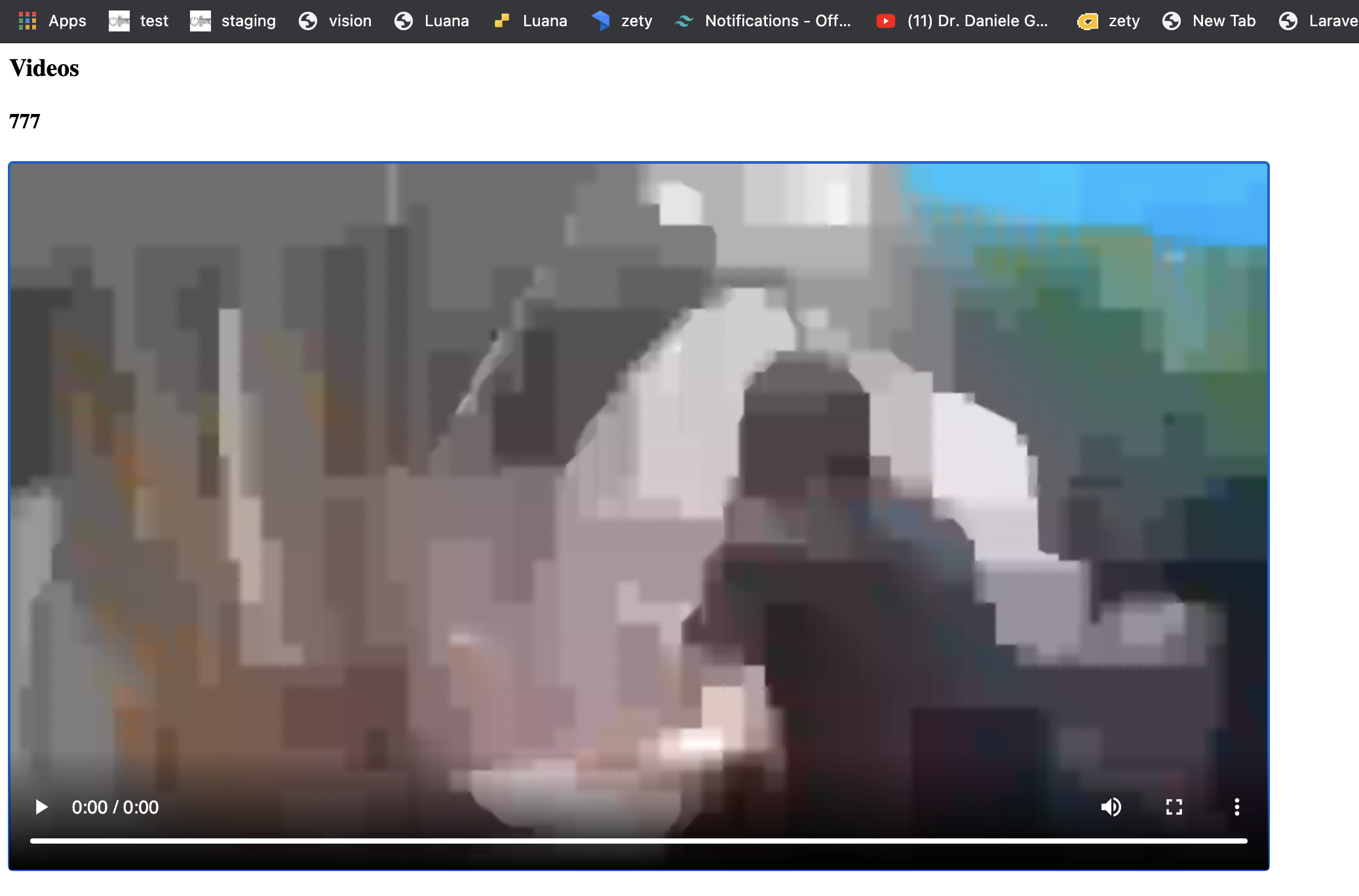

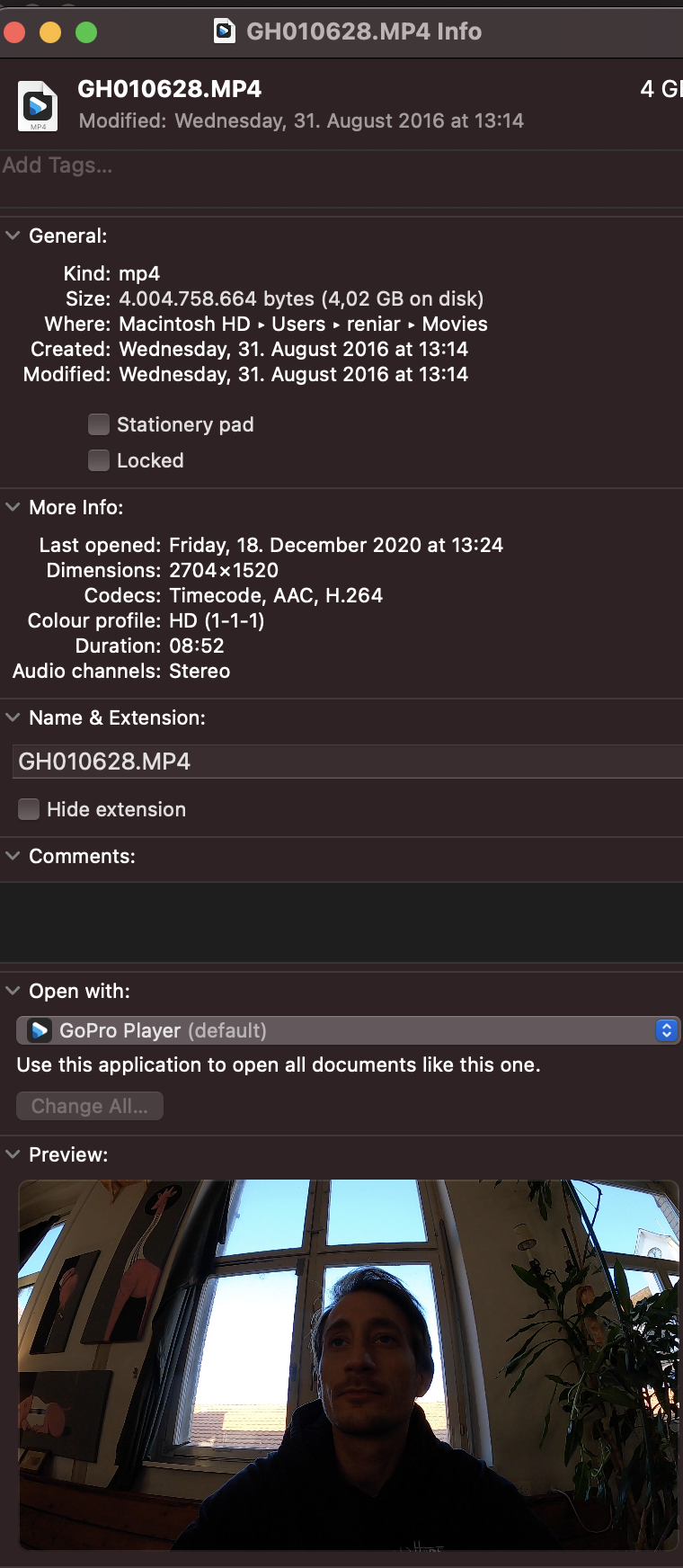

I convert a video shot with goPro8:
https://i.postimg.cc/3YhF4rTz/Screenshot-2020-12-18-at-13-26-55.png
[Attachment 56307 - Click to enlarge]
with PHP-FFMpeg / PHP-FFMpeg
the conversion seems to be successful but the output video is stuck on frame 0 and 0 seconds long and very pixldCode:ffmpeg' '-y' '-i' '/Users/reniar/code/OfflineJetstream/storage/app/public/NgzQEAWIjvJUX9wn.mp4' '-threads' '12' '-vcodec' 'libx264' '-acodec' 'libmp3lame' '-b:v' '500k' '-refs' '6' '-coder' '1' '-sc_threshold' '40' '-flags' '+loop' '-me_range' '16' '-subq' '7' '-i_qfactor' '0.71' '-qcomp' '0.6' '-qdiff' '4' '-trellis' '1' '-b:a' '128k' '-vf' '[in]scale=960:540 [out]' '-pass' '1' '-passlogfile' '/var/folders/kd/979xg6nd0jq8xy3zyy812c_40000gn/T/ffmpeg-passes5fdc9a58242b5coh38/pass-5fdc9a582433b' '/Users/reniar/code/OfflineJetstream/storage/app/public/NgzQEAWIjvJUX9wn.mp4'
https://i.postimg.cc/WTRjvgT0/Screenshot-2020-12-18-at-12-35-22.png
Code:ffprobe nn0aurzgsT58AHaE.MP4 ffprobe version 4.3.1 Copyright (c) 2007-2020 the FFmpeg developers built with Apple clang version 12.0.0 (clang-1200.0.32.27) configuration: --prefix=/usr/local/Cellar/ffmpeg/4.3.1_4 --enable-shared --enable-pthreads --enable-version3 --enable-avresample --cc=clang --host-cflags= --host-ldflags= --enable-ffplay --enable-gnutls --enable-gpl --enable-libaom --enable-libbluray --enable-libdav1d --enable-libmp3lame --enable-libopus --enable-librav1e --enable-librubberband --enable-libsnappy --enable-libsrt --enable-libtesseract --enable-libtheora --enable-libvidstab --enable-libvorbis --enable-libvpx --enable-libwebp --enable-libx264 --enable-libx265 --enable-libxml2 --enable-libxvid --enable-lzma --enable-libfontconfig --enable-libfreetype --enable-frei0r --enable-libass --enable-libopencore-amrnb --enable-libopencore-amrwb --enable-libopenjpeg --enable-librtmp --enable-libspeex --enable-libsoxr --enable-videotoolbox --disable-libjack --disable-indev=jack libavutil 56. 51.100 / 56. 51.100 libavcodec 58. 91.100 / 58. 91.100 libavformat 58. 45.100 / 58. 45.100 libavdevice 58. 10.100 / 58. 10.100 libavfilter 7. 85.100 / 7. 85.100 libavresample 4. 0. 0 / 4. 0. 0 libswscale 5. 7.100 / 5. 7.100 libswresample 3. 7.100 / 3. 7.100 libpostproc 55. 7.100 / 55. 7.100 Input #0, mov,mp4,m4a,3gp,3g2,mj2, from 'nn0aurzgsT58AHaE.MP4': Metadata: major_brand : isom minor_version : 512 compatible_brands: isomiso2avc1mp41 encoder : Lavf58.45.100 Duration: 00:00:00.07, start: 0.000000, bitrate: 467 kb/s Stream #0:0(eng): Video: h264 (High) (avc1 / 0x31637661), yuvj420p(pc), 960x540 [SAR 1521:1520 DAR 169:95], 1216 kb/s, 119.88 fps, 119.88 tbr, 120k tbn, 239.76 tbc (default) Metadata: handler_name : GoPro H.265 timecode : 04:21:22:50 Stream #0:1(eng): Audio: mp3 (mp4a / 0x6134706D), 48000 Hz, stereo, fltp, 129 kb/s (default) Metadata: handler_name : GoPro AAC Stream #0:2(eng): Data: none (tmcd / 0x64636D74), 3 kb/s Metadata: handler_name : GoPro H.265 timecode : 04:21:22:50
any ideas are welcome
