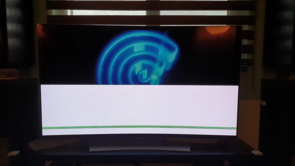

    Long story short - my LG EG920V (WebOS2.0) can't properly handle 2076 vertical resolution. As you can see in the attached picture half the screen is noisy with a green horizontal bar at the bottom. I tried to play the same file (.mkv) from PLEX (Xplay/Plex), EMBY(Emby Theatre/Screenplay), as well as directly from USB HDD with the same result.
    [Attachment 56279 - Click to enlarge]
    As an workaround I added horizontal black bars on top/bottom (42px each) with ffmpeg, but it's a very very slow process - on my AMD Ryzen 7 3700U (8 cores) it runs ~1fps. Anyway the result 3840x2160 plays without issue on TV.
    Stream #0:0: Video: hevc (Main 10), yuv420p10le(tv, bt2020nc/bt2020/smpte2084), 3840x2076 [SAR 1:1 DAR 320:173], 24 fps, 24 tbr, 1k tbn, 24 tbc (default)
    ffmpeg.exe -i input.mkv -vf "pad=3840:2160ow-iw)/2oh-ih)/2" -c:v libx265 -crf 20 -map 0:0 -map 0:2 -c:a copy "output.mkv"
    When I tried to use hw encoder hevc_amf I found out there is no yuv420p10le pixel format available (like libx265 has), and thus the output is only 8bit using yuv420p.

  2. You could also try to remux your 3840x2076 video with MkvToolNix, specifing for the videotream a resolution of 3840x2160.
  3. Try:
    ffmpeg -i "input.mkv" -map 0 -c copy -bsf:v "hevc_metadata=crop_top=0:crop_bottom=0" "output.mkv"
    (It's a long shot but who knows ... May need to extract and remux afterwards with mkvtoolnix.)
  4. Originally Posted by sneaker View Post
    Try:
    This command outputs 3840x2080 which is still no good for my TV, my goal is 3840x2160. And if I don't explicitly specify the video codec it defaults to X264. Anyway after I choose libx265 it is as slow as my command above.
    The real deal would be to use hardware encoding but with 10bit...
    Thanks,
  5. Originally Posted by ProWo View Post
    I have already tried that and it outputs the same res 3840x2076. Where do I have to specify the resolution? If it's Video properties -> Display width/height it's not working as expected...
  6. Try
    ffmpeg -i input.mkv -c copy -bsf:v "hevc_metadata=sample_aspect_ratio=16/9" output.mkv
  7. Originally Posted by MihaiB. View Post
    That's why I used "-c copy" ... (JFYI. Not that it solves your problem.)
