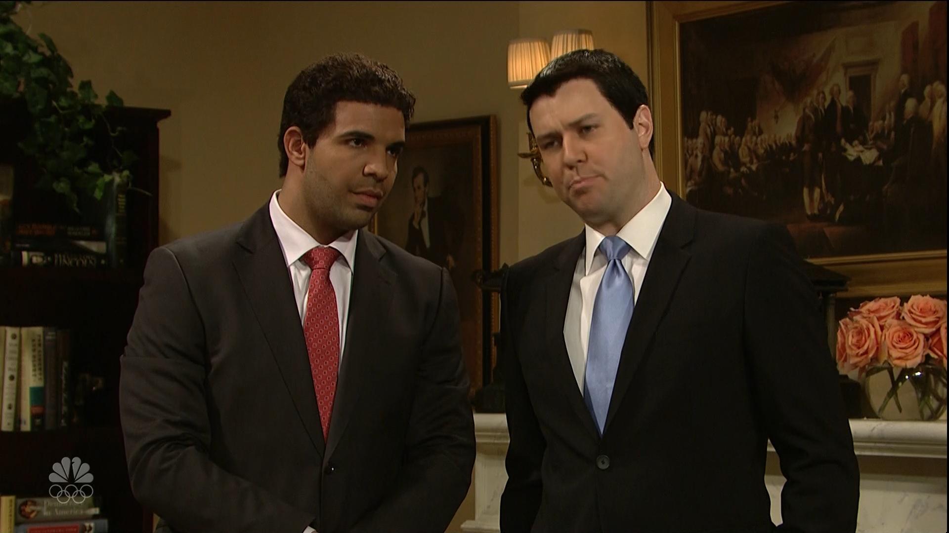

  9. Does the video look about like this on your computer?
    [Attachment 56346 - Click to enlarge]
  10. problem is - im trying to compress this 13 gb episode - using handbrake with quality on 19 and decomb bob filter - everything looks normal and detailed (but with same washed out colors) - so after fixing contrast in avidemux , file looks like this (watch horrible pixelated costumes) https://drive.google.com/file/d/18dTRJNwGZSpbvnQNNonVVntFaDOutAdl/view?usp=sharing
    i dont understand is it avidemux makes file so pixelated or its handbrake compression? (cause its impossible to watch this file on any player wthout washed out colors)

  12. Original file is also wrongly flagged as "full range" while the content is not really full range. Maybe that's also part of a problem.
  13. Originally Posted by badyu17 View Post
    You're right. It might be possible to remux with the video flagged as limited range.
