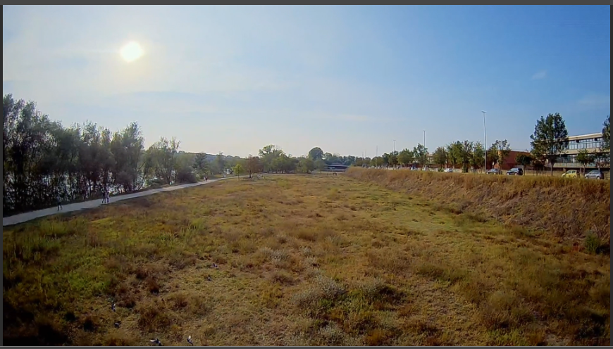

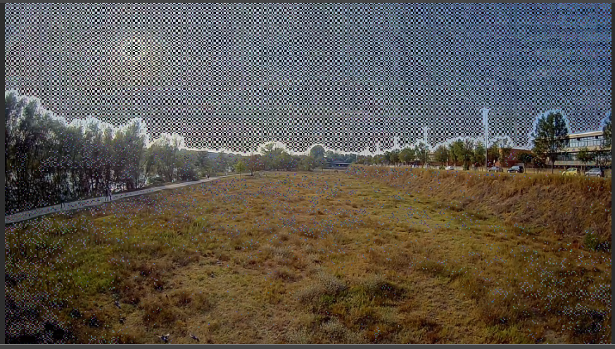

    I have an issue with Magix Vegas Pro 17 which just happened recently when I started editing the very high bitrate videos from a newly acquired quadcopter with HD camera.
    When rendering the video, the output has some artifacts appearing in just single frames here and there in a few minutes video.
    Every time I render the video the artifacts are in few different frames.
    The issue is in single frames: the previous and following frames are always perfect as you can see from the attachment screenshots.
    The source videos do not have any issue, I've tried different sources.
    There is no difference by changing the rendering codec: I have the issue both rendering with Magix AVC and Voukoder x264 codecs.
    What can be the cause of the issue? Do you have any suggestion to help getting rid of the problem?

Name:	2020-12-12 19_00_44-Untitled _ - VEGAS Pro 17.0.png
Name:	2020-12-12 19_13_35-Untitled _ - VEGAS Pro 17.0.png

    No, as I mentioned in the thread, every time I render again the same video, even with the same exact codec and options, the artifacts appear in different frames. Once in a while I'm able to have a video without or almost without artifacts, but usually I have about 3/4 frames with artifacts in about 5 minute video. Attached another example. It is a really bad issue as when playing the video in normal speed it is like you see a flash.
Name:	2020-12-12 22_14_16-Untitled _ - VEGAS Pro 17.0.png

  6. At the end it seems the cause is somehow in the system used to render the video.
    Moving my project to an external drive and using another PC to render the same project, still using the same codec (Voukoder x264 with same settings), there wasn't any artifact in the output render.
    To clarify, the issue was only in 2 edits/projects out of 4 I did with the videos coming from the same drone: on the other two edits there wasn't any artifact even repeting again and again the same rendering with the affected PC.
