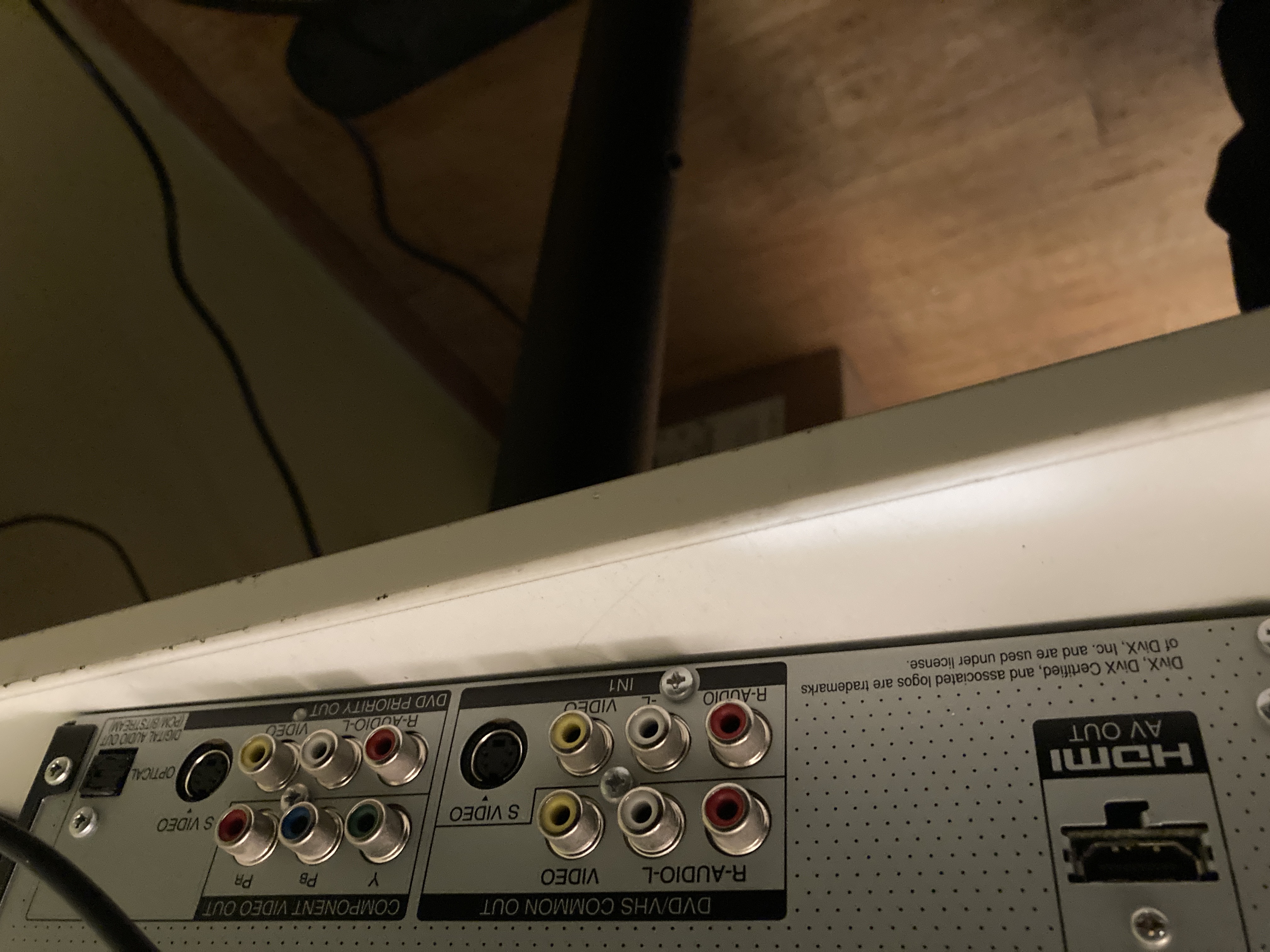

    Thank you! I appreciate all the responses, I'm trying to get better at doing this and even trying to get started on it as an extra source of revenue to do this as a service for friends and family so I want to take it seriously.
    At this point is S-Video with RCA audio is going to be best bet, without a ton of additional upgrades? I am using the DVC 100 and I know people aren't huge fans of the usb capture devices, I'd like to work my way toward a setup like that German one in the link above, but I also am being economical and working with what I have.
    Please let me know if there are any better/reliable guides than the Youtube one I've linked, as that's mostly what I've gone off of. It's worked for me, but I end up with HUGE raw files ~50GB. I know I can convert and compress these, but I don't like the idea of losing any quality if I don't need to. Is that unreasonable? Is there a codec you like better than the UTvideo one I use?
    Appreciate you guys!
  7. If the Capture device supports it, it looks like it should be possible to get 480i HDMI out from it. From what people have wrote here and on dfaq in the past the way the older panasonic combo VHS/DVD recorders work is that the "DVD-priority" outputs (+ component and HDMI obviosly) you get video that has gone through the internal digitizer and thus a stable signal, while the DVD/Video common out gives the direct signal as you would get from a standard VCR. I don't know for sure about this model, but it's likely it works in a similar manner. Also no idea if the internal video decoder is as good at correct wiggle and instability as the standalone DVD-recorders. So, if you have a decent capture card, there probably won't be a whole lot of difference between HDMI and S-Video out.
    A quality SD card has always been better than an HD card.
    HD cards do SD quite poorly.
    It's like buying a car to haul a load of cement. Wrong tool for the task. You'll just make a mess.
    The DVC100 is what I reluctantly consider "minimally acceptable". It still has issues, but it's better than many other options, the Easycaps (Easycrap) and Elgato (Elcrapo), the generic "grabbers, and the like. Quality will take a hit with Dazzle cards, but mostly with the exposure values (uncorrectable in proc amp or later software correction).
    Lots of component decks have internals that are not component chain-of-custody, force deinterlace, etc. These units were not meant to output VHS for capturing, but instead output a "good enough" (not really good at all) signal to that new whizbang HDTV set.
