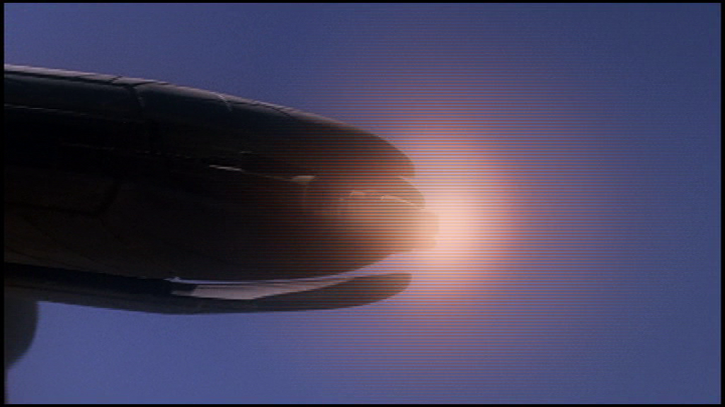

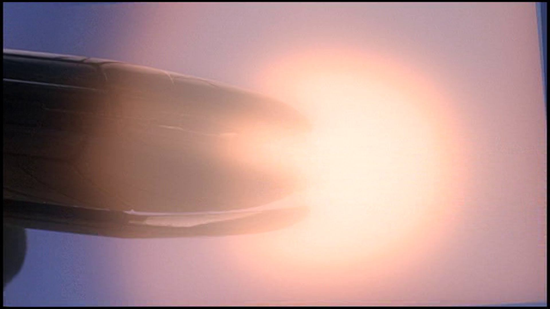

  17. aBigMeanie aedipuss's Avatar
    Oct 2005
    666th portal
    try vidcoder with de-interlace set to decomb. it leaves p frames alone and only "adjusts" interlaced ones.
    interlaced.
    [Attachment 56217 - Click to enlarge]
    decombed
    [Attachment 56218 - Click to enlarge]
  18. Thank you all for help , i will try with vidcoder decomb , i guess with interlace detection default for leave progressive frames alone , if will not work well i leave the files in original .
