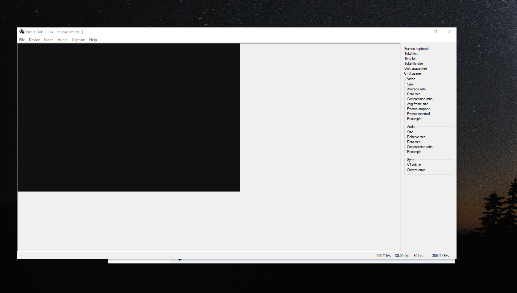

    Hey,
    I would like to capture some of the videos from the old VHS and I have a working VHS\DVD player Daewoo drv-6702SV and I did connected it to a USB Grabber Media-Tech (MT4169) trough a scart\component cable things (I did connect yellow -> yellow, red -> red and white -> white).
    I installed VirtualDub, however, after selecting the Device "AV to USB2.0" i get a black screen with no video or audio (see attached screenshot).
    If anyone could help me with this, I would really appreciate it as I would like to send out videos till xmas
    Thank you in advance and if any further info will be needed please do not hesitate to ask, as I will provide with much info possible.
Name:	Screenshot 2020-12-10 000512.png
    canada
    Are there any other device names you can choose in virtualdub?

    There are also setting you must make in the 'Video' and 'Audio' menus.
    Eg. Video Source = composite (not component). Capture Filter = (per your broadcast standard Pal-?)

    looks like another easycrap clone to me. you can't use virtualdub as it only converts to mp4 in haardware. use the software provided.

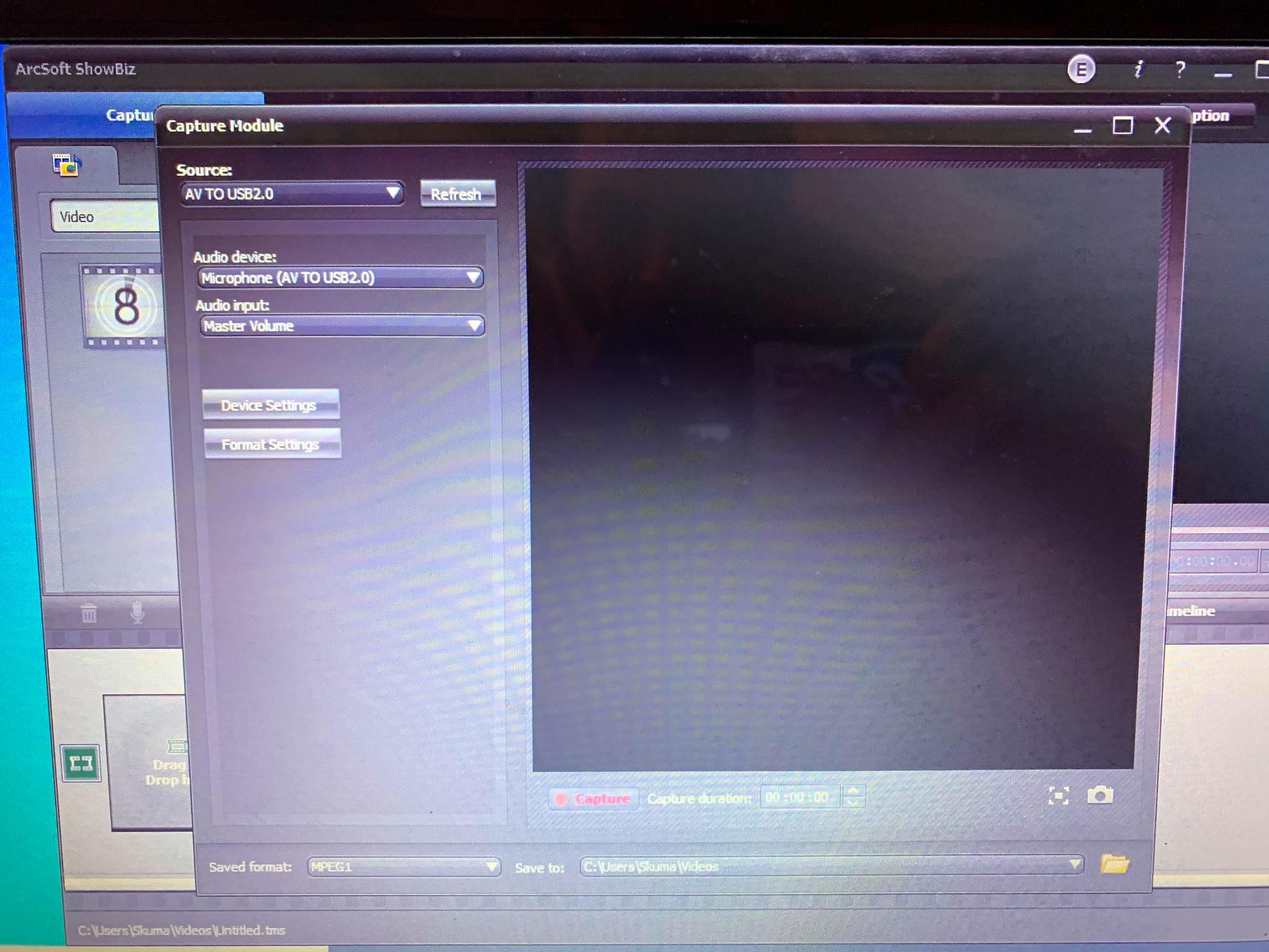

    Thanks for all the help. I have now tried to install the program that was provided (ArcSoft ShoBiz) however, I'm still getting only a blackscreen and there is no option to select imput S-video or composite or at least i cannot find it.

    BTW What scart adapter are you using ?
    Some of these are switched to have video-in and video-out
    But there really should be some instructions with that software. And, again, you can not select s-video unless you have a S-VHS vcr. Most combi units only allow for s-video for dvd playback.

    And according to the manual there are several on-screen buttons for Video Settings, Video Format and Video Input. Same as with audio.
    Jan 2016
    What's under device settings and format settings buttons? and also check the VCR manual as DB83 pointed out, 90% of the time for an average user the solution is in the user manual.

    Have you tried playing a tape first to see if it works on your tv?
    Dec 2020
    Slovenia
    Thank you all for the help! Scart cable had a manual IN\OUT switch and it was set to the wrong setting heh.
