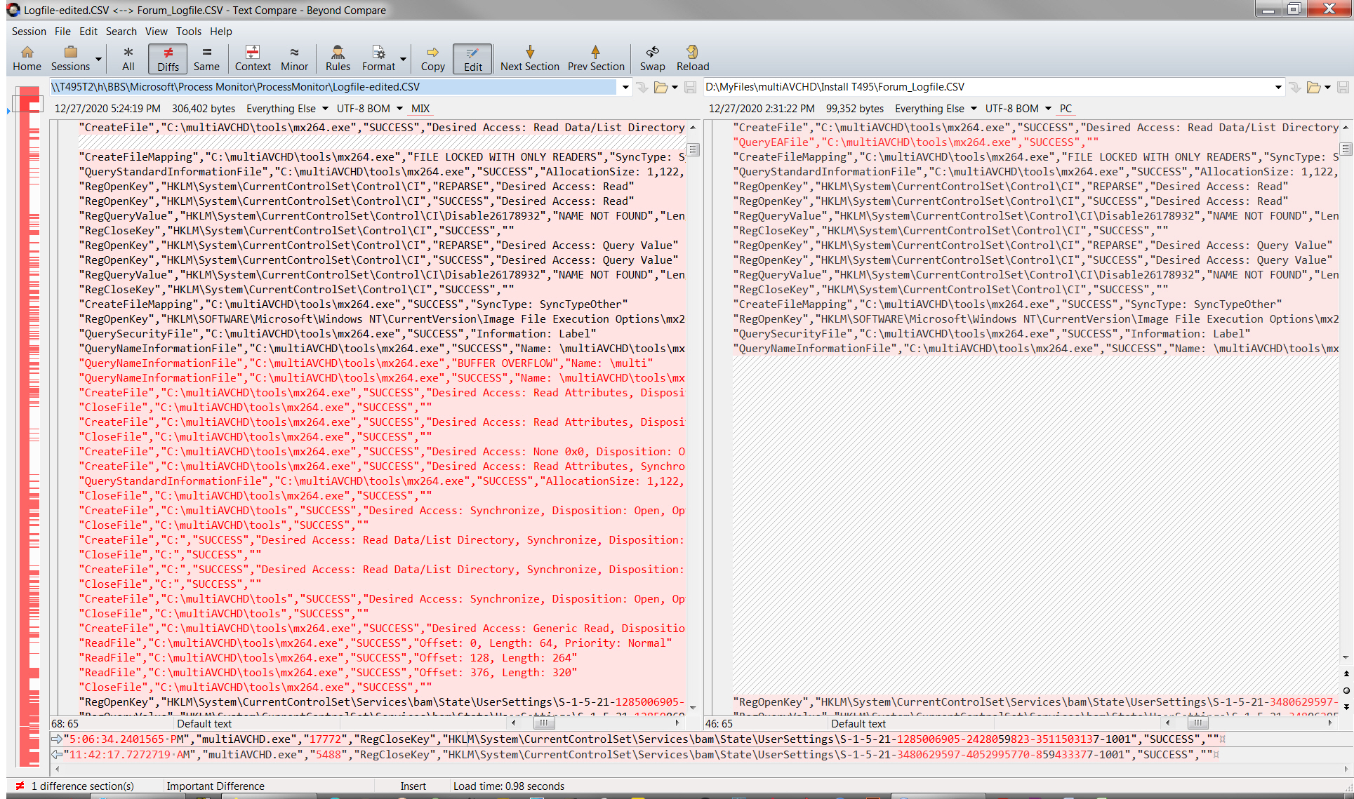

    I have re-installed Windows 10 one more time (settings / Update & Security / Recovery / Reset this PC / Remove Everything / Local reinstall.) Once it had completed, I created an offline account, updated Windows until it was up-to-date, and then proceeded to install multiAVCHD. I even used Edge as the browser, so I installed nothing beyond the Windows OS prior to the multiAVCHD install.
    I started with the tools: avisynth, ffdshow, and haali, in that order, downloaded using Dean's links.
    I then installed multiAVCHD, launched it, navigated to thee Author tab, and clicked Create top menu. As before, it complained. I attached the ProcMon trace.
    The trace looks much like it did before, although that initial QueryEAFile is now gone. It still did only one read of multiAVCHD.dat as before.

    And this is relevant because when I compared my newly created log (on this T495 machine) to your latest log, there was that difference. On my T495 there was an occasional "side trip" looking through that \AppCompatFlags\Layers key specifically looking for an entry for c:\multiAVCHD\tools\MX264.EXE which is NOT present. On your system since there was no \AppCompatFlags\Layers key your trace did not reflect any side-trips.
    (3) MX264.EXE is a very critical internal component of multiAVCHD. In fact AVISynth.dll is loaded by MX264.EXE (according to the trace, visible if you also show MX264.EXE entries). For that reason I expanded my ProcMon trace to include its process name as well as multiAVCHD.EXE. I think the trace output from both programs is very important to see, because looking at your trace there seems to be some problem involving MX264.EXE. Since your trace doesn't have its output I can't yet compare those one-level-down entries for significant differences. But I'm suspicious of something related to MX264.EXE.
    Can you please re-run your test again, but this time with a second PROCESS NAME filter (include) of MX264.EXE. I'm posting my own trace output here, already including MX264.EXE as well as multiAVCHD.EXE.
    However I still think the fundamental problem is revealed much earlier in the trace. As you can see from the following comparison, even though your mysterious QueryEAFile for multiAVCHD.DAT has disappeared, there now is one of them for MX264.EXE. I'm not a programmer at this level, but I'm guessing this is referring to a "program information file" for MX264.EXE, and if not found it gets created. Or something. But whatever is going on, your trace and my trace is different. Perhaps since I've run multiAVCHD multiple times that program information file for MX264.EXE is already created on subsequent requests. For you, the very first time you run your test after installing Win10 there isn't yet an entry for it. Perhaps that's the difference here.
    So I think the best thing is for you to run at least two (or even three?0 tests, before capturing the ProcMon output, just to be sure we're not distracted by first-time-only anomalies. We really should be looking at "steady state" symptoms from the 2nd or 3rd test, since you say you can reproduce the failure 100% every time you try it.
    Notice the difference in our trace output right at line 28 in file. For my situation MX264's "program information file" seems to have been properly populated with information, probably thus making MX264.EXE "usable". And it's the entryway to AVISYNTH.DLL. In contrast, your trace shows a QueryEAFile entry, perhaps because this is your first time running multiAVCHD. So I'm willing to give it the benefit of the doubt.
    But the real problem is then visible a bit further down, at your line 42, which is right at the QuerySecurityFile entry, followed by a QueryNameInformationFile entry. This is really where our two trace outputs diverge. And this pertains to MX264.EXE. So if the access to MX264.EXE is somehow hindered by what's happening here, perhaps that explains why the interface to AVISynth is defective, eventually resulting in the error messages you see.
    I don't know what this QuerySecurityFile is all about, but it seems relevant.
    [Attachment 56482 - Click to enlarge]

    Here is the ProcMon trace from my latest test that includes both multiAVCHD as well as MX264.
  4. I running Win10Pro as well. Here are the specifications:
    Edition Windows 10 Pro
    Version 20H2
    Installed on ‎12/‎26/‎2020
    OS build 19042.685
    Experience Windows Feature Experience Pack 120.2212.551.0
    I launched multiAVCHD and tried to enable menus several times before generating the ProcMon log. Our log files still diverge at about the same point but it's all foreign to me.
    I've attached the log as before.
