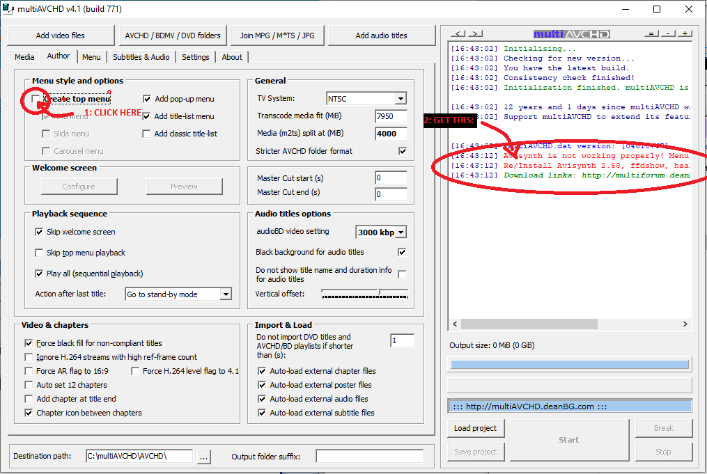

  3. I have used MultiAVCHD for several years on my Win7-based machine with very good results, so I am familiar with menu creation. My problem is much simpler:
    1) I have installed MultiAVCHD and all the tools it requires using the versions called out in the author's install instructions (http://multiforum.deanbg.com/viewtopic.php?f=7&t=17).
    2) I have configured the tools per the same instructions.
    When I launch MultiAVCHD and select Author / Menu styles and options / Create top menu, I get the following:
    [15:00:45] Avisynth is not working properly! Menu will not available!
    [15:00:45] Re/Install Avisynth 2.58, ffdshow, haali splitter.
    [15:00:45] Download links: http://multiforum.deanbg.com/viewtopic.php?f=7&t=17
    I've uninstalled and re-installed those three tools multiple times and followed the configuration instructions carefully but every time, I get the same problem.
    So that's where I'm at.
    If you have been able to click on the Create top menu box and not get this message, please tell me how you installed the utility and its tools!

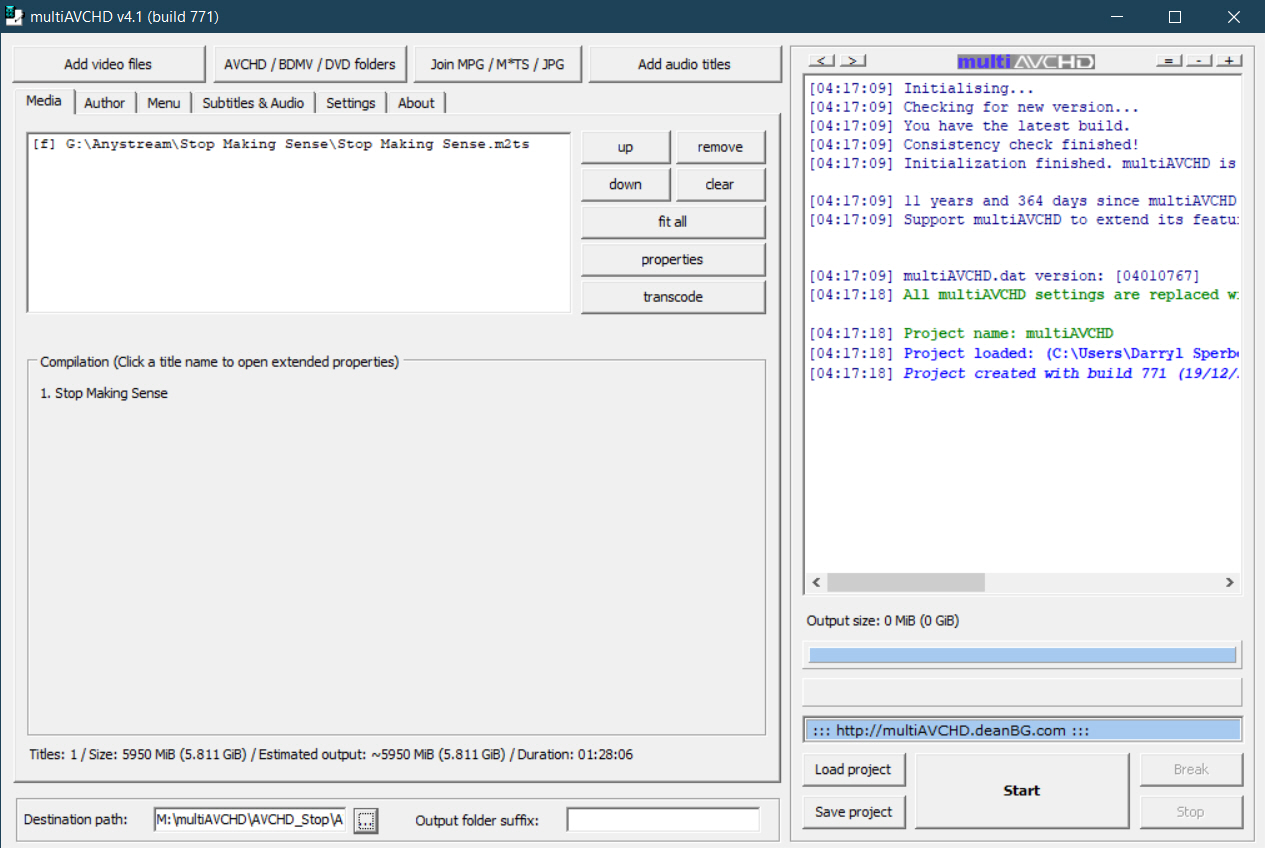

    (1) Media tab, defining one M2TS input file:
    [Attachment 56366 - Click to enlarge]

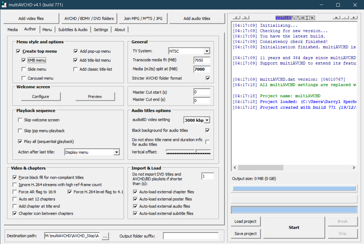

    (2) Author tab, showing "create top menu" (XMB style) checked:
    [Attachment 56367 - Click to enlarge]

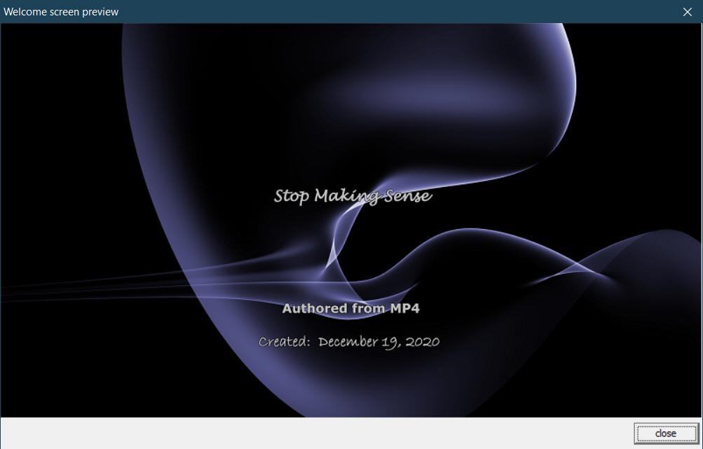

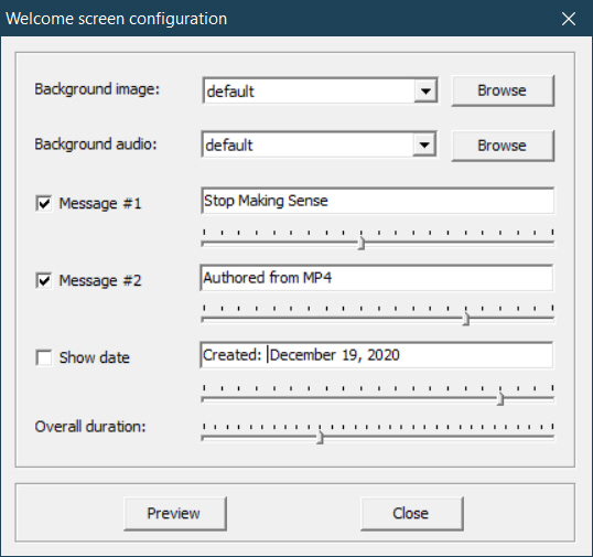

    (2a) Welcome screen configuration:
    [Attachment 56368 - Click to enlarge]
    (2b) Welcome screen preview:
    [Attachment 56369 - Click to enlarge]

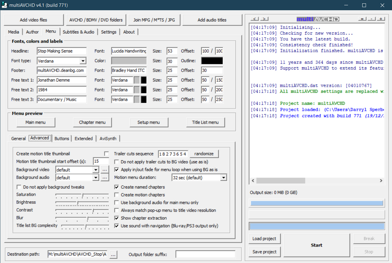

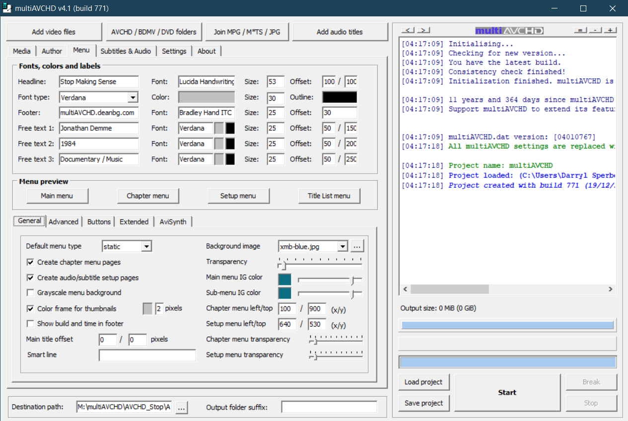

    (3a) Menu tab - general sub-tab:
    [Attachment 56370 - Click to enlarge]
    (3b) Menu tab - advanced sub-tab:
    [Attachment 56371 - Click to enlarge]

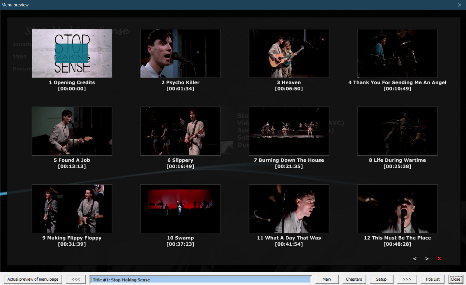

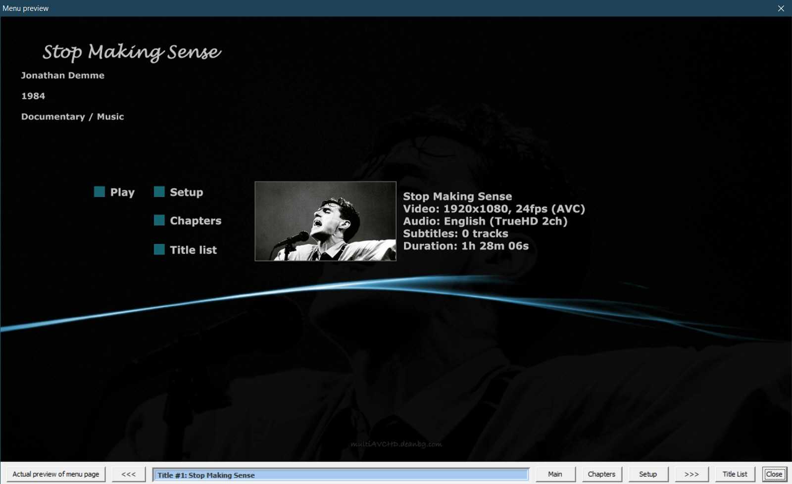

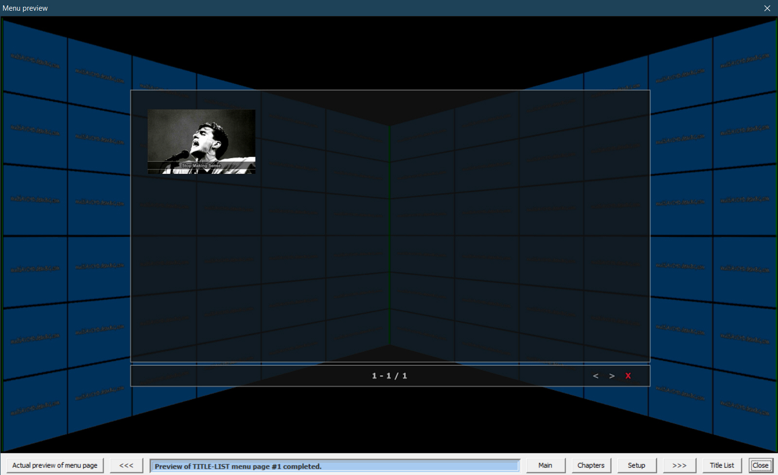

    (4a) Menu preview - main menu:
    [Attachment 56372 - Click to enlarge]
    (4b) Menu preview - chapter menu:
    [Attachment 56373 - Click to enlarge]
    (4c) Menu preview - title list menu:
    [Attachment 56374 - Click to enlarge]

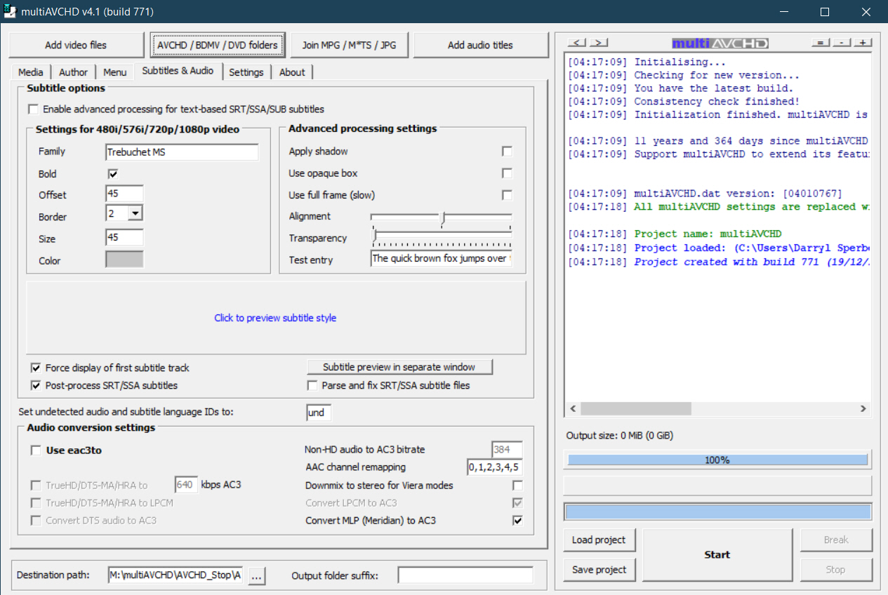

    (5) Subtitles & Audio tab:
    [Attachment 56375 - Click to enlarge]

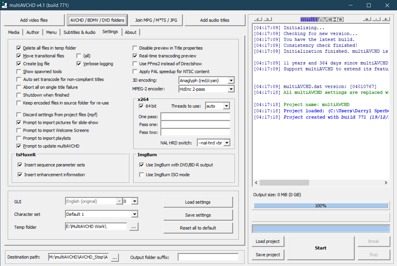

    (6) Settings tab:
    [Attachment 56376 - Click to enlarge]

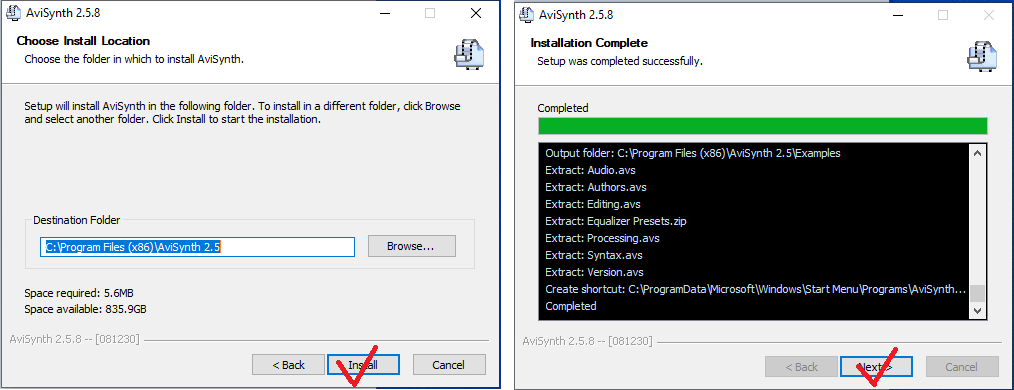

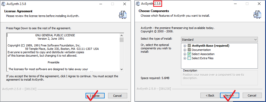

  14. I started to take a closer look at the support tools installation and I see something I don't understand.
    Upon installing avisynth 2.58, I see this in the install dialog:
    Output folder: C:\Windows\system32
    Extract: avisynth.dll
    Extract: devil.dll
    However, when I navigate to C:\Windows\System32, there is no sign of these two dlls. However, they do show up in C:\Windows\SysWOW64.
    I've tried running the installation as administrator as well.

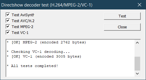

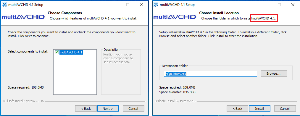

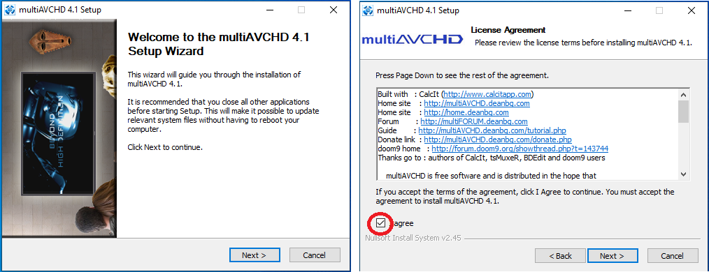

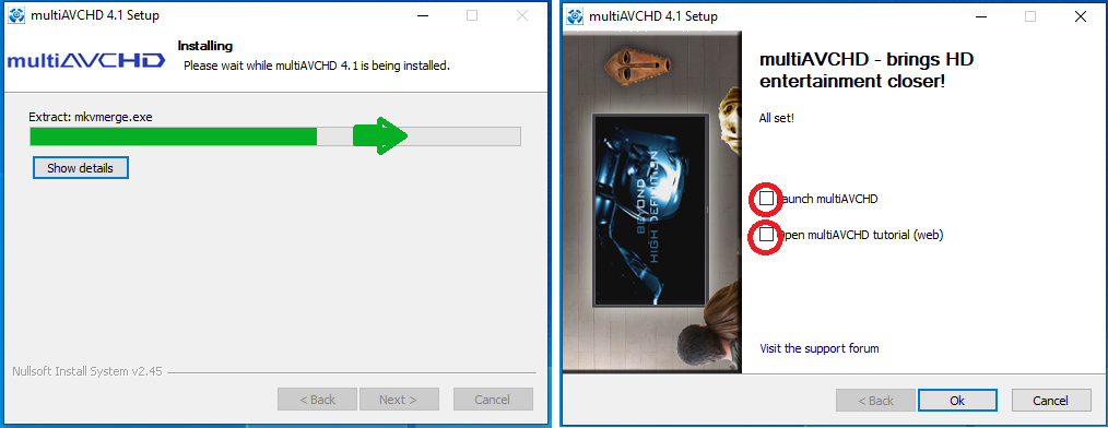

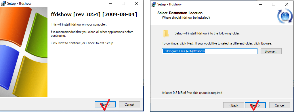

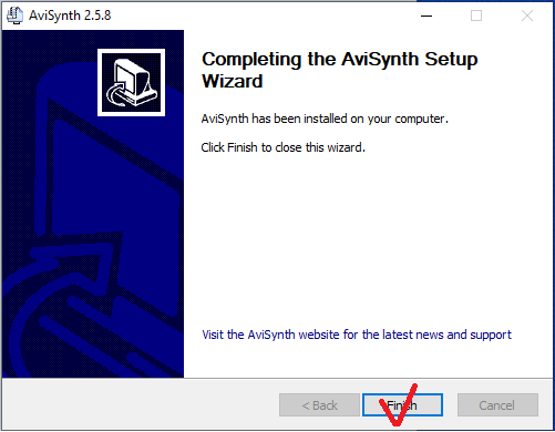

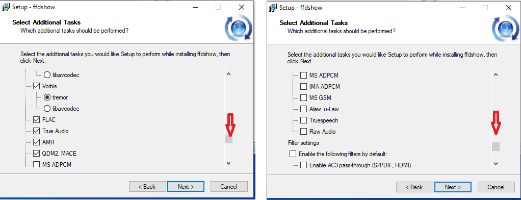

    I've now gone through the whole prescribed installation process, EXACTLY as instructed on Dean's "latest links" and installation instructions page. I used another Win10 machine that had never had anything video-related installed on it. In fact I don't even have Audacity installed on it, preferring to use CoolEdit 2000 for the relatively simple audio editing functions I utilize.
    Anyway, just to be clear, here was what I did. Remember this is a brand new "virgin white canvas" Win10 (20H2) system. Everything installed was exactly as it opened, pushing only NEXT until done. The only changes or tweaks in the default install sequence for any product are specifically noted.
    (1) Installed multiAVCHD.
    (2) Ran multiTEST (expecting everything to fail). It did all fail.
    (3) Installed AVISynth 2.58.

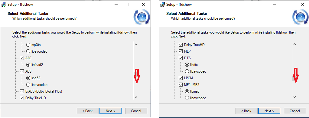

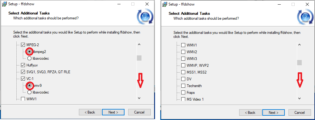

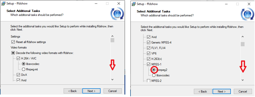

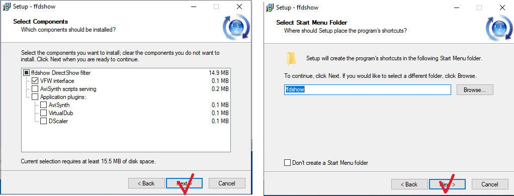

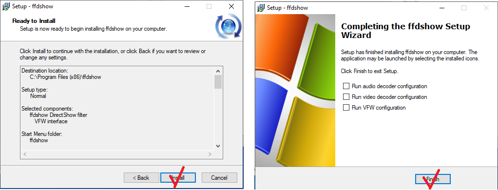

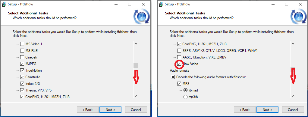

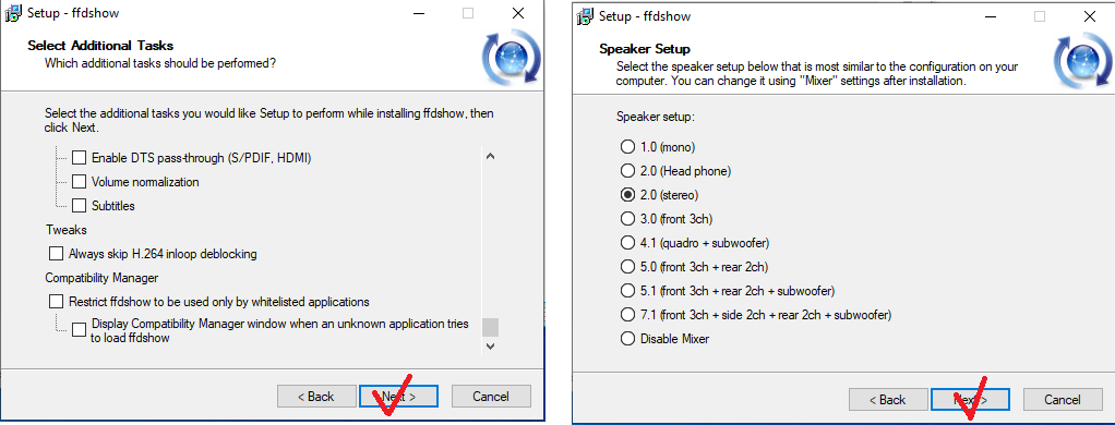

    (4) Installed FFDSHOW rev3054 from 2009-08-04, with the following items manually checked (their defaults are un-checked), exactly as shown in Dean's installation steps:
    (a) checked MPEG-1 and MPEG-2
    (b) checked VC-1
    (c) checked Raw Video

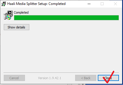

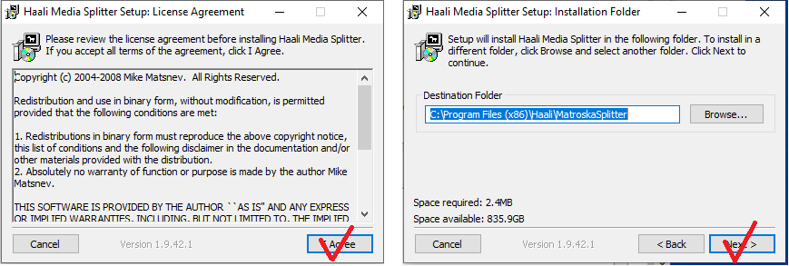

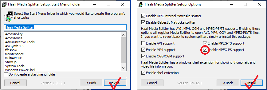

    (5) Installed Haali Matroska Splitter from 2009-11-01, with the following items manually checked:
    (a) enable MPEG-PS support
    (6) ran multiTEST again. This time ALL TESTS WORKED, including VC-1.
    [Attachment 56397 - Click to enlarge]

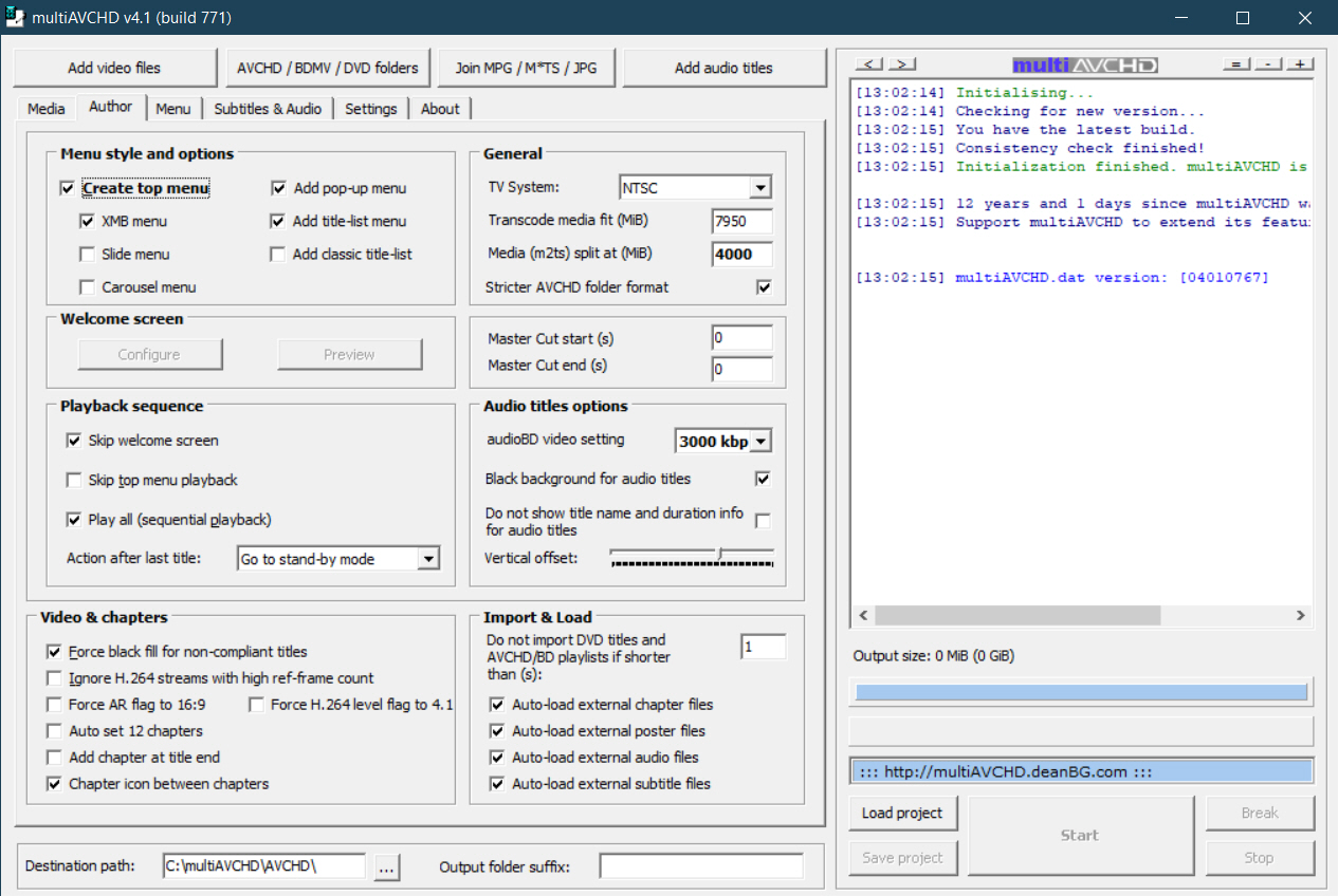

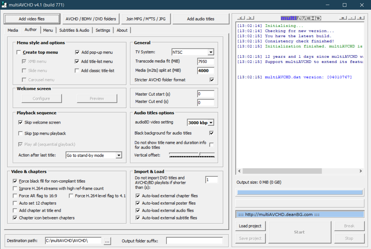

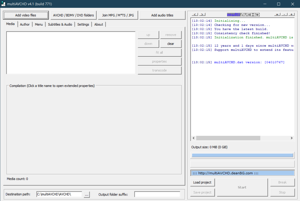

    (a) initial default presentation, with Media tab selected:
    [Attachment 56398 - Click to enlarge]
    (b) initial default presentation of Author tab:
    [Attachment 56399 - Click to enlarge]
    (c) Now I checked "Create top menu" box, and the program seemed to do something for a few seconds (perhaps this is when your error situation is occurring), so obviously it's not just checking an option that happens when the box is checked. Clearly SOMETHING else IS definitely happening. But in my case that did not cause any problem. After that short period of "thinking about it" the screen changed slightly, un-graying the default XMB menu option.
    [Attachment 56400 - Click to enlarge]
    So that's it. No errors of any kind up to this point.

  19. Okay, I completely re-installed Windows 10.
    I installed NVIDIA control panel and Firefox - nothing else.
    I installed multiAVCHD and all the tools per http://multiforum.deanbg.com/viewtopic.php?f=7&t=17
    MultiTEST fails VC-1 decoding.
    I launched multiAVCHD, went directly to author tab, no other setup of the application. Cannot check Create top menu box. I still get:
    [15:36:43] Avisynth is not working properly! Menu will not available!
    [15:36:43] Re/Install Avisynth 2.58, ffdshow, haali splitter.
    [15:36:43] Download links: http://multiforum.deanbg.com/viewtopic.php?f=7&t=17
    I will uninstall, re-install and provide screenshots.

  20. Virgin install of Windows 10.
    I didn't change anything for avisynth.
    I clicked on four additions for ffdshow.
    I clicked on one addition for haali media splitter.
    I didn't configure anything for multiAVCHD, just tried to enable top menus.

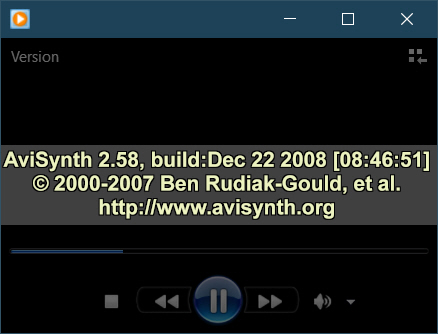

    Try this, to verify that AVISynth is installed and operational. It should work as described if it is:
    (1) create a script (i.e. text file) named VERSION.AVS and put it somewhere. It's content is only one line (exactly as follows):
    Version()
    (2) open File Explorer and navigate to where you saved VERSION.AVS, right-click on the file and select "Open with..."
    (3) When you get the "Open with..." dialog click on the "more apps" link to get the "how do you want to open this file" dialog.
    (4a) Scroll down through the alphabetical list of offered programs. At the bottom you should see Windows Media Player, which you should select.
    (4b) If you don't see Windows Media Player at the bottom of the list there is a "look for another app on this PC" link, and click on it to get the standard "Open with..." dialog. Then navigate to C:\Program Files (x86)\Windows Media Player, open that folder, and double-click (or select and push the OPEN button) on WMPLAYER.EXE to launch Windows Media Player.
    (5) You should then get a message from WMP about the fact that it doesn't recognize the extension of AVS but that it still might be able to play it, and do you want to let it try. Go ahead and push the YES button, and if AVISynth has been installed properly you will next see a short "video" that looks like the following:
    [Attachment 56429 - Click to enlarge]
    If this works as I describe, then it sure looks like AVISynth is actually installed properly. If not, let's pursue what happened back when you installed it.

  25. I have re-installed Windows 10 one more time (settings / Update & Security / Recovery / Reset this PC / Remove Everything / Local reinstall.) Once it had completed, I created an offline account, updated Windows until it was up-to-date, and then proceeded to install multiAVCHD. I even used Edge as the browser, so I installed nothing beyond the Windows OS prior to the multiAVCHD install.
    I started with the tools: avisynth, ffdshow, and haali, in that order, downloaded using Dean's links.
    I then installed multiAVCHD, launched it, navigated to thee Author tab, and clicked Create top menu. As before, it complained. I attached the ProcMon trace.
    The trace looks much like it did before, although that initial QueryEAFile is now gone. It still did only one read of multiAVCHD.dat as before.
