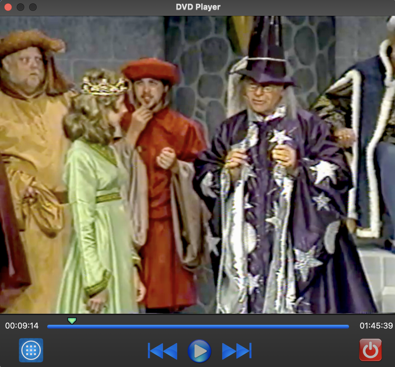

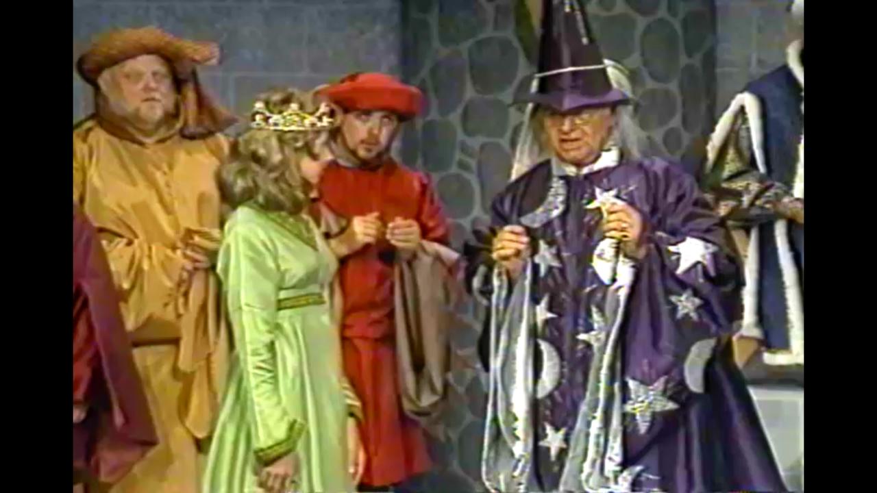

  3. My guess is it's supposed to be something in this ballpark (sat=2.5):
    [Attachment 56793 - Click to enlarge]
    If your editor doesn't give you that much latitude with one saturation bump you can try applying it multiple times.
  4. This looks pretty close, does it? This is at 84%

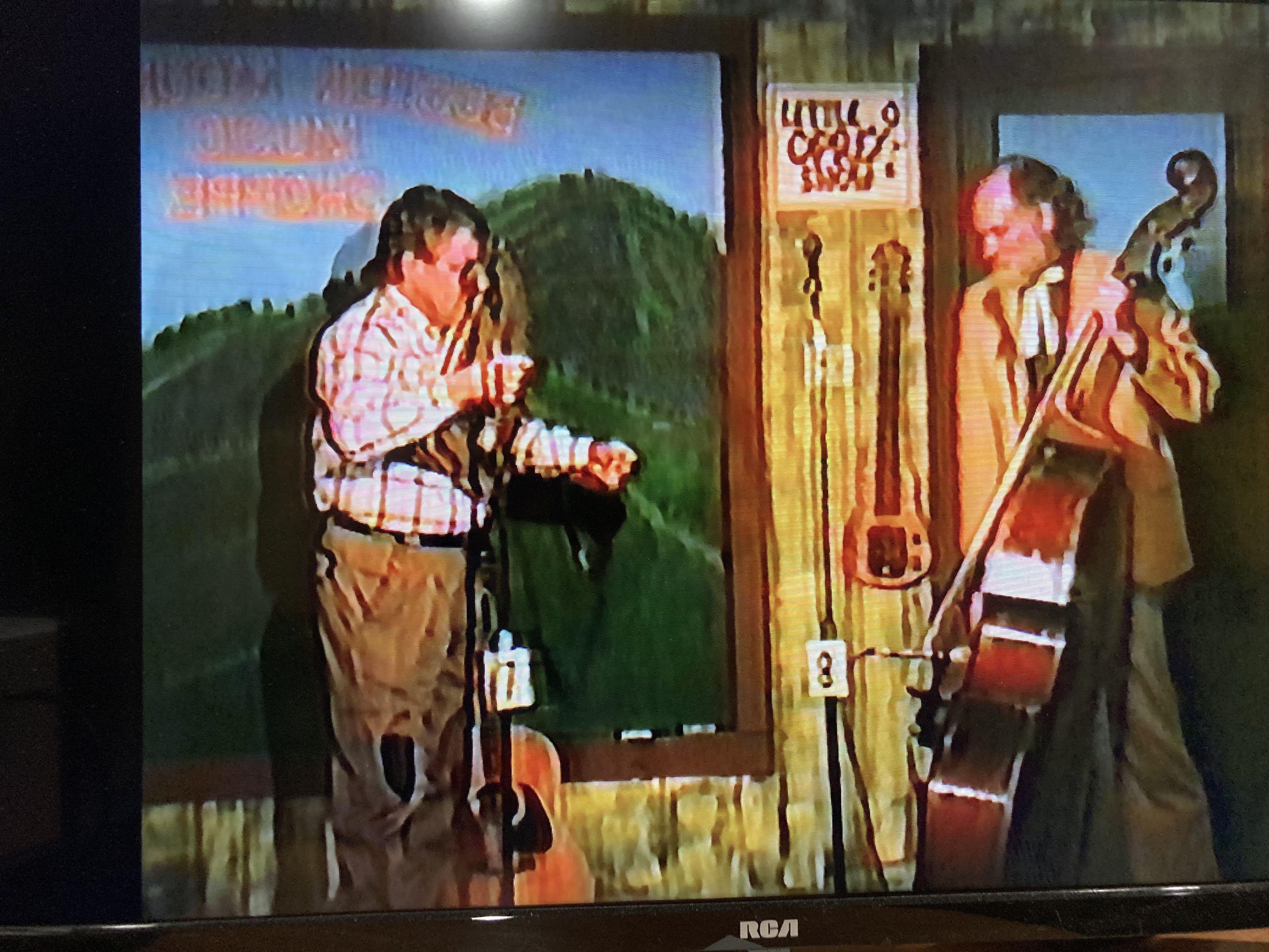

  13. ignore that wavey stuff and notice the colors and brightness. This is the DVD

  14. the VHS
  15. You usually don't want your product to look exactly like the VHS tape. VHS recordings often have bad levels, bad colors, their noisy, etc. You want to fix all that.

    One can't judge a video by a photo of a TV screen. There are too many variables. But it looks oversaturated and over bright. As davexnet said, a video sample (not reencoded, not uploaded to youtube) would help.
