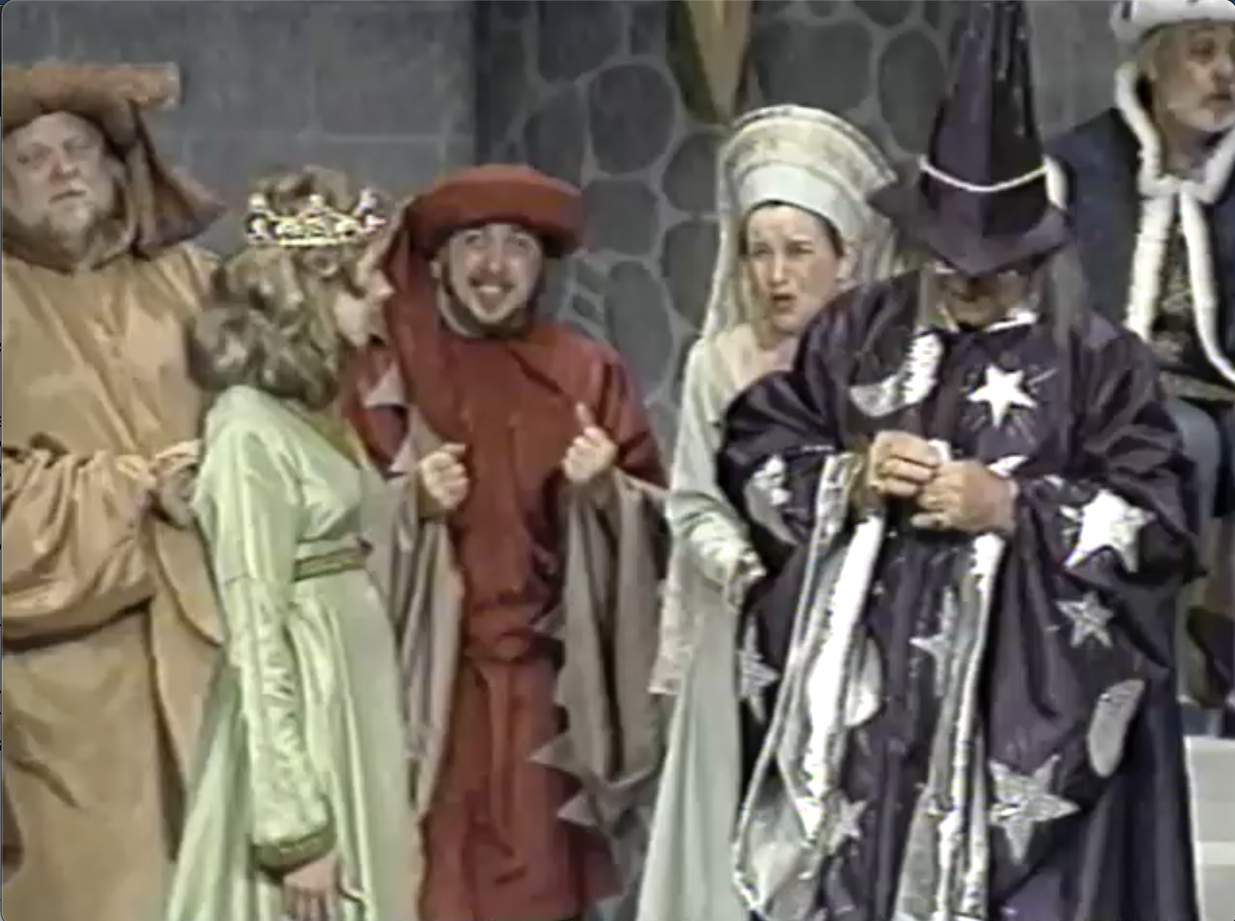

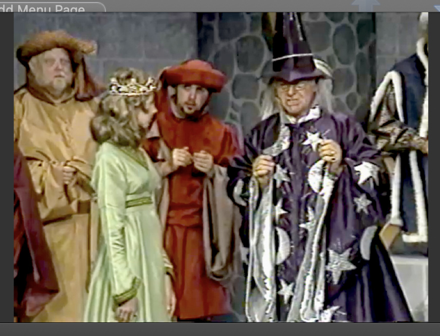

  1. Originally Posted by jagabo View Post
    Originally Posted by cinemakyle01 View Post
    The first on is obviously a photograph of the TV screen -- you can see the Sanyo logo. I'm guessing the other is too.
    The other photo is a screenshot from my laptop. The photos I posted are from a VHS to computer conversion.
    So the second picture is from a computer capture of the analog video from the VHS deck, as displayed on the computer? Photographed with a camera? Or screen captured with software?
    It's just that converting to a DVD gives me the same results.
    As viewed on the TV from the DVD recorder playing the DVD it recorded? Or as viewed on the computer? This is critical because TVs are often set to increase contrast and saturation, computer monitors are not.
    The second image can be made to look more like the first just by increasing the saturation.
    [Attachment 56165 - Click to enlarge]
    The second picture is from a computer capture. With this particular tape, I then burned in onto a disc after transferring the footage to a computer (so VHS to computer to dvd) and played the disc onto a DVD player and it still looks desaturated. Also, I burned something else onto a dvd using the other method which involved the VHS/dvd dubbing option and it caused the same issue.
  2. What I think I'll do is try using the 3 VHS players I have with me and converting footage with all of them while also using my laptop. I'll post pictures of everything and I will try to also use the vhs/dvd combo machine again to make sure it's doing this with everything. I think it'll be the easiest way to get to the bottom of this.

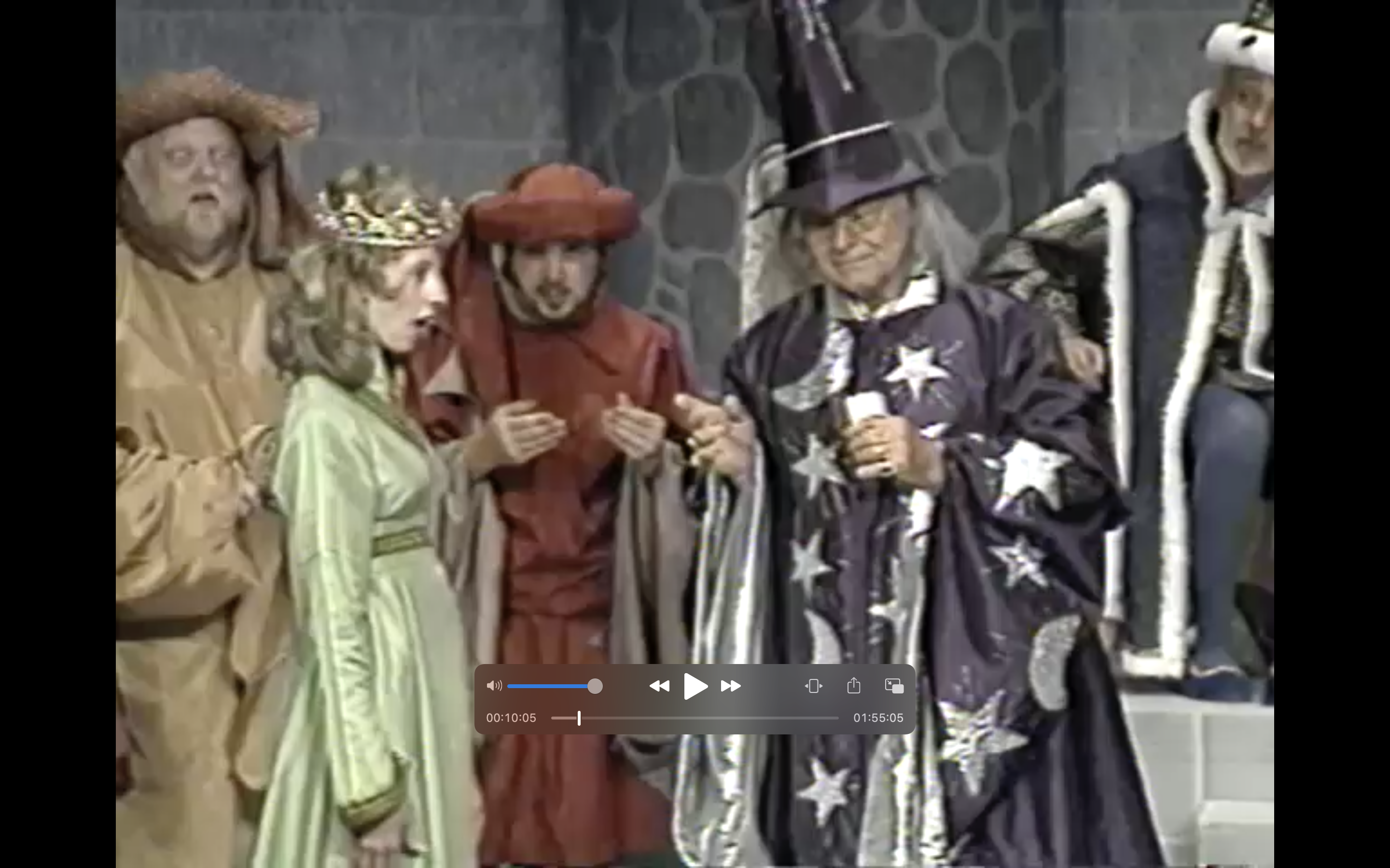

  20. here is a screenshot of the image after tweaking it on my computer. How does this look? I mainly bumped up the saturation. Does this image look fine to everyone? Any suggestions on tweaking the image?

  23. Originally Posted by cinemakyle01 View Post
    I think it's still undersaturated and maybe has a rec.601/rec.709 problem. But there's no reference so I don't know what the colors are supposed to be.

  27. Would taking a screenshot of the video unaltered on my laptop work as a reference point to get a better idea on how to enhance it?
  28. This is the original video converted to a computer file unaltered.
  29. I think I might have just realized what the problem was when I started this thread. On the Sanyo TV, it was producing a very saturated image, but I just tested the VHS on two other TV's and both are producing a saturation level close to the image above. So, what does that mean for the image quality above?
