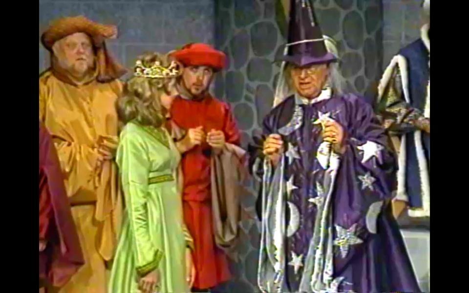

When you convert a tape, does anyone notice a significant quality difference between the formats (VHS and DVD)? I have my own setup and I've done a compare/contrast between the footage on the 2 formats, and I've noticed a significant difference. I know since these are 2 different formats, that's to be expected, but the colors in this particular video I've converted look a certain way, and on the DVD, the colors are less strong. I can't decide if the DVD image looks washed out, or if the VHS is too saturated. Any advice anyone can give me? Does putting the footage on a DVD neutralize the image quality? I've used a VHS/DVD combo with the dubbing function.

	Well, that is a massive difference. I have never seen such a supersaturated VHS capture. What did you use to capture these two images?
	If those are accurate depictions of what you see on the TV it's a huge difference. The VHS may be a little oversaturated but DVD is definitely undersaturated.
	I used a VHS/DVD combo player that has a dubbing feature. The supersaturated image is the VHS and the undersaturated image is the DVD. Whats odd is that I also have a Elgato video capture device and it produces the same result.
	You didn't answer the question: HOW did you capture these images? I understand clearly that you have a VHS/DVD combo unit. Did you create the DVD and then capture the result as the DVD played from this unit? Did you capture the VHS tape as it was playing from this same VHS/DVD combo unit? What is the connection between the unit and the computer, and what capture software did you use on your computer to capture these still images?
 What is the make/model of your VHS/DVD combo unit?
	The first on is obviously a photograph of the TV screen -- you can see the Sanyo logo. I'm guessing the other is too.
	I put in a blank disc, then started the VHS, which is the source of the footage, and simultaneously hit record on the DVD as the VHS was playing. When the VHS played all the footage, I stopped the DVD recording, then finalized it. As for the capture software, I sometimes use it and not always. Regardless if it's just the VHS/DVD player or VHS to computer, It produces the same result. The software is Elgato Video Capture.
 Model: Sanyo FWZV475F.

	You probably won't be able to solve this without borrowing a different VCR and dvd player, and possibly checking the Sanyo combo with a different TV.
 Digitizing VHS with a combo recorder does typically result in somewhat noticeable differences from the original tape, but not this dramatic color desaturation (differences btwn VHS vs a dvd recorder copy of it lie more in the appearance of video noise, blur/sharpness, etc). Getting exactly the same desaturated result from your Elgato device connected to a PC would be extremely odd coincidence if you're playing the files from your PC to the TV. However, if you are making a DVD of the Elgato files in your PC, then playing that DVD with the Sanyo, you almost certainly have a defect in the video output of the Sanyo dvd section.
 To narrow down the source of the problem, you'd need to try playing the Sanyo-burned and Elgato/PC-burned dvds in a different dvd player. If the color looks normal in another player, the Sanyo disc playback circuit is faulty. If the dvds show the same desaturation in another player, you've got a defect in either the dubbing system circuit of the Sanyo, or the Sanyo VCR section does something funny to the video signal that triggers desaturation in digital encoders but doesn't manifest when it plays directly to a TV. Ruling out the Sanyo VCR section requires trying the same tapes in a different external VCR, connected to the Sanyo for DVD dubbing and then the Elgato for PC capture.
 There's a slight chance your Sanyo TV just doesn't like something in the output signal of your Sanyo combo unit in dvd mode: trying the combo with a different TV would determine that. Also try swapping connection methods between the combo and TV: check if DVD playback quality changes when shifting from HDMI to composite, S-video or component cables instead. If so, the connection that looks desaturated is defective in the combo (or that connection cable itself is funky).

	I've tried a second VCR before, and it gave me the same results, but I can try it again to make sure because it was several months ago when I tried that. These are home videos. When I connect to a computer, I use Composite cables on a Elgato video capture device, and you plug it in to a computer with a usb, so it's composite to USB.

	If the DVD picture was from the laptop, perhaps you should play it on the TV same as the tape, same unit, same cables, same TV settings
	So the second picture is from a computer capture of the analog video from the VHS deck, as displayed on the computer? Photographed with a camera? Or screen captured with software?
 As viewed on the TV from the DVD recorder playing the DVD it recorded? Or as viewed on the computer? This is critical because TVs are often set to increase contrast and saturation, computer monitors are not.
 The second image can be made to look more like the first just by increasing the saturation.
