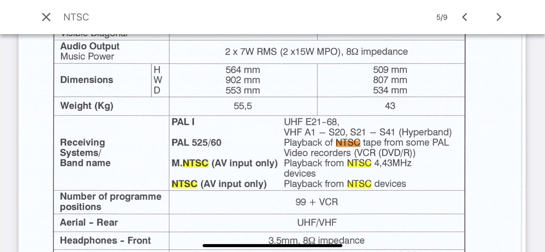

    The PAL CRT seems to accept both PAL60 and "true" NTSC signals, although I don't think it specifies whether this is across both the RF and the composite inputs (attached small screenshot from the manual)

  7. The manual is fairly clear that it only accepts NTSC signals thru its "AV inputs" (which indirectly means SCART or composite or S-video if it has that). Like most EU CRT televisions with the NTSC feature, it cannot accept NTSC via RF input because that would require an additional NTSC tuner for NTSC channel 3/4. It is easier/cheaper to add NTSC mode to the line inputs, and the demand NTSC RF playback in PAL countries is minimal, so the RF option would be difficult to accomplish unless you somehow cobble together a chain of conversion devices. Since that would likely defeat your aim of crisper picture quality, I'd recommend using an all-AV-connection chain.
