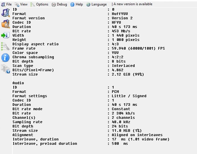

  16. Capturing Memories dellsam34's Avatar
    Jan 2016
    I emptied it and now it's complaining about the audio queue being empty and maybe I forgot to add audio,,,,????
    Here is the files I'm trying to encode:
  17. If the audio isn't set to 'ignore' and the audio queue is empty, Hybrid will warn about it (jobs will still be generated).
    So yes, seems like you are to hasty.
  18. Capturing Memories dellsam34's Avatar
    Jan 2016
    If I set it to ignore it will be video only no audio, I want both video and audio and I selected custom, first, all, none of them wanted to convert from PCM to AAC.
    Wow Hybrid is a pain in the @$$.
  19. If you want to passthrough PCM you can't use mp4 as container, since mp4 does not support PCM audio.
    Reencoding the audio to aac works fine here.
    If you select custom, don't forget to add your setting for the selected track to the audio queue,... just setting some settings and not letting Hybrid know that the selected settings should be used for processing isn't enough.
