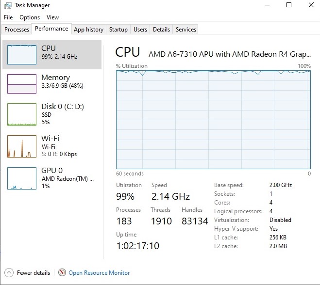

    With prefetch(4) I'm topping 19 fps, still not practical for the project.

  23. Capturing Memories dellsam34's Avatar
    Jan 2016
    Originally Posted by TimA-C View Post
    Just to jump in, it looks like you've only got one hdd in the system - admittedly a SSD - but would he see any improvement with more? Also, have you checked that your Win10 is running with the AHCI drivers for your Hard disk controllers? (device manager, some mention of 'AHCI' in the drivers of hard drive controllers section. There are also some registry entries you can check, but I can't remember what they are off the top of my head.) Also, assuming you're running some internet security, have you excluded any temp folders and destination folders that your setup is using from a possibly overzealous security program. Whitelist your encoding program as well, if you can, just for good measure.) And, obviously, disconnect from internet whilst encoding.
    I'm guessing you've probably got all this covered, but I would be interested to know what the thoughts are on multiple SSDs for encoding. Good luck.
    No, The bottle neck is not the hard drive as you can see from the previous screen shot, it is hovering around 5% usage, It's the processor.
    Jagabo, I will try setting 3 when I get home.
