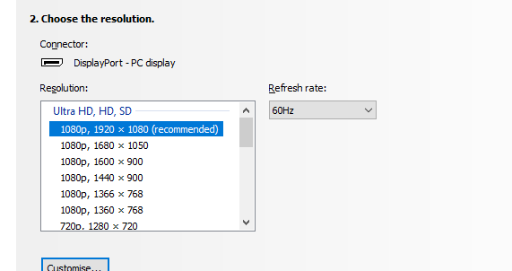

    ok by default my monitor / video card always sets to 60hz, so should I set this to 50hz ?

    I have set my video card refresh rate to 50Hz but still have the problem

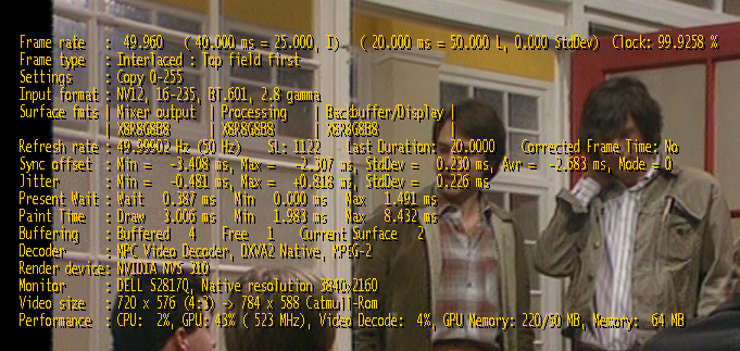

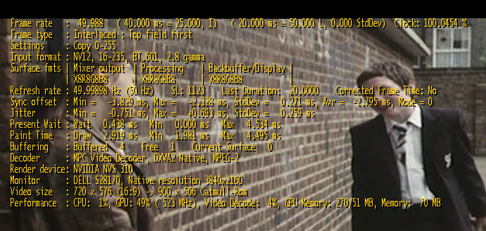

    [Attachment 56110 - Click to enlarge]
    [Attachment 56111 - Click to enlarge]
    what is strange these both seem to have the same attributes and settings ?
    these images were taken in MPC-BE x64 PLAYER, which seem to be better at playing the video, than VLC does
    but it would seem both videos are the same standard (interlacing etc), so why is VLC playing one better than the other >??
