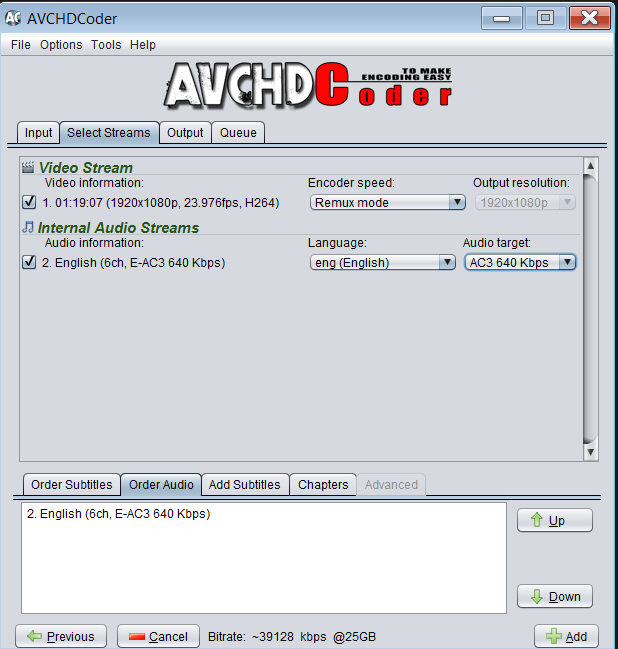

    Just to provide pictures of what I'm trying to do (using just one input file for the following):
    (1) here is my input MP4 file. Note that I've requested REMUX-MODE for video quality, to retain original source with NO RE-ENCODING OF VIDEO. I've also selected AC3 640Kbps for the audio output target, which happens to be exactly the same as the input audio format. Again, I'm expecting no re-encoding of audio, just perhaps re-muxing from EAC-3 to AC3 (if there is any difference).

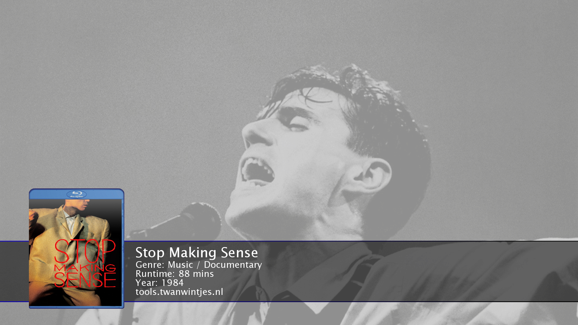

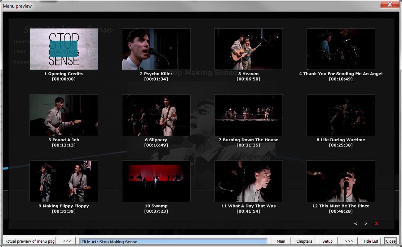

    (2) here is the way OUTPUT looks, showing the one file playlist
    [Attachment 56086 - Click to enlarge]

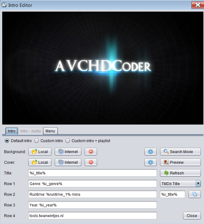

    (3) Here is what the intro specification is, for pure "default intro"
    [Attachment 56087 - Click to enlarge]

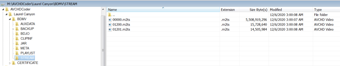

    (4) And after running the conversion this is what the resulting \BDMV\Stream folder looks like, showing a non-zero 01200.m2ts intro movie as well as a non-zero 01201.m2ts menu movie.
    [Attachment 56088 - Click to enlarge]

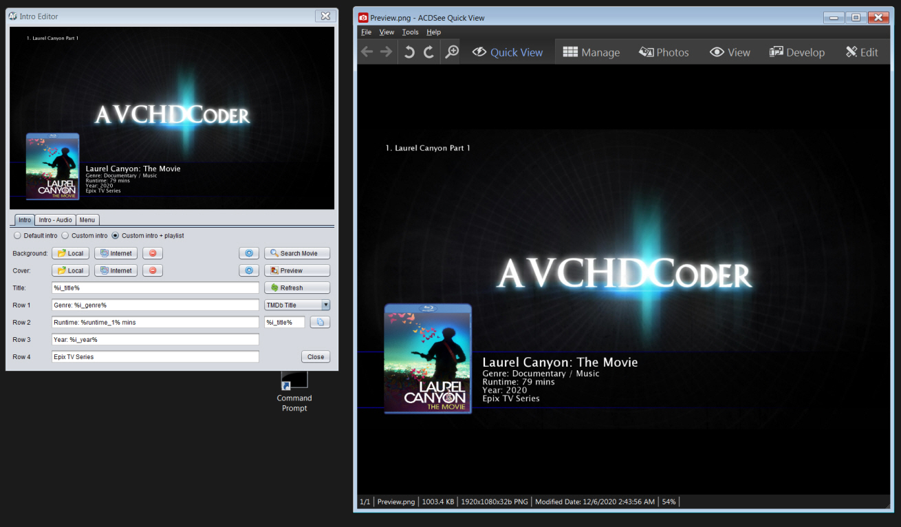

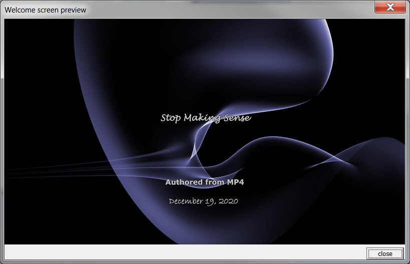

    (5) Now instead of "default intro", I check "custom intro + playlist", and go through "search" to locate my movie thumbnail image along with other details about the movie in order to populate those five custom intro fields. I then push PREVIEW, and see the following (all of which is PERFECT)
    [Attachment 56090 - Click to enlarge]

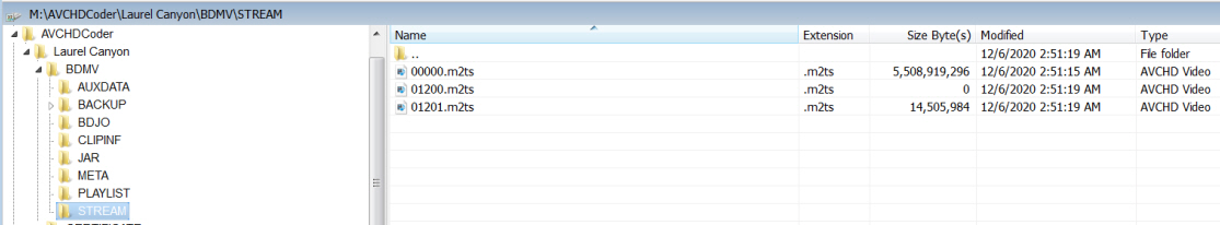

    (6) And now after running the conversion this is what the resulting \BDMV\Stream folder looks like, showing a ZERO BYTE 01200.m2ts intro movie.
    [Attachment 56091 - Click to enlarge]
    So, what did I do wrong, or forget to do or provide?? Does this function actually work for anybody else?
    I did not manually provide either "cover" or "background" myself, because I assumed that when selecting the results provided from "search mode" that this would be all that is needed, assuming it's acceptable to me. And in fact the PREVIEW of what it theoretically is going to do is perfect!! The thumbnail image and 5 rows of detail info, along with the playlist in the upper left corner... I assumed this would all be overlaid on top of the default intro movie to produce a new intro movie looking just like the PREVIEW. If it did just that it would be perfect for me.
    And that's what I thought would happen, since PREVIEW looked perfect. It's just that 0 bytes got produced.

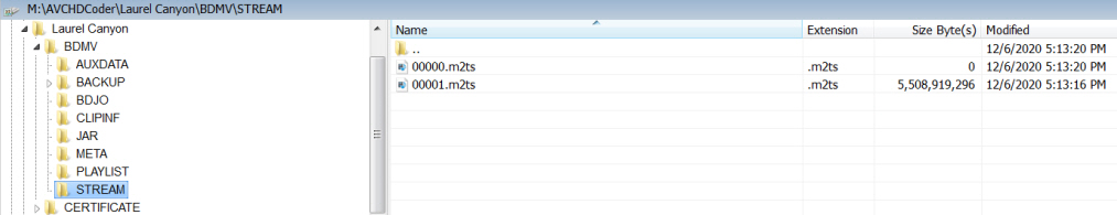

    No success for me. For simplicity I'm just testing with a single input MP4 file. And (this maybe important) I select REMUX-MODE for "video quality", as I do not want any re-encoding of audio or video and resulting loss of original source quality.
    Although the intro movie file name was now 00000.m2ts with the main title now 00001.m2ts, the intro movie is still 0 bytes.
    [Attachment 56116 - Click to enlarge]
    I'm still using "search" to populate custom image and information about the movie on this "custom" intro. Maybe that's key to the problem.

    Well, I guess I have to give up. Everything I've tried, every combination, every option, nothing has worked. Always 01200.m2ts ends up at 0 bytes.
    And yet, PREVIEW is perfect and shows exactly what I hope would be the resulting "custom intro":
    [Attachment 56158 - Click to enlarge]

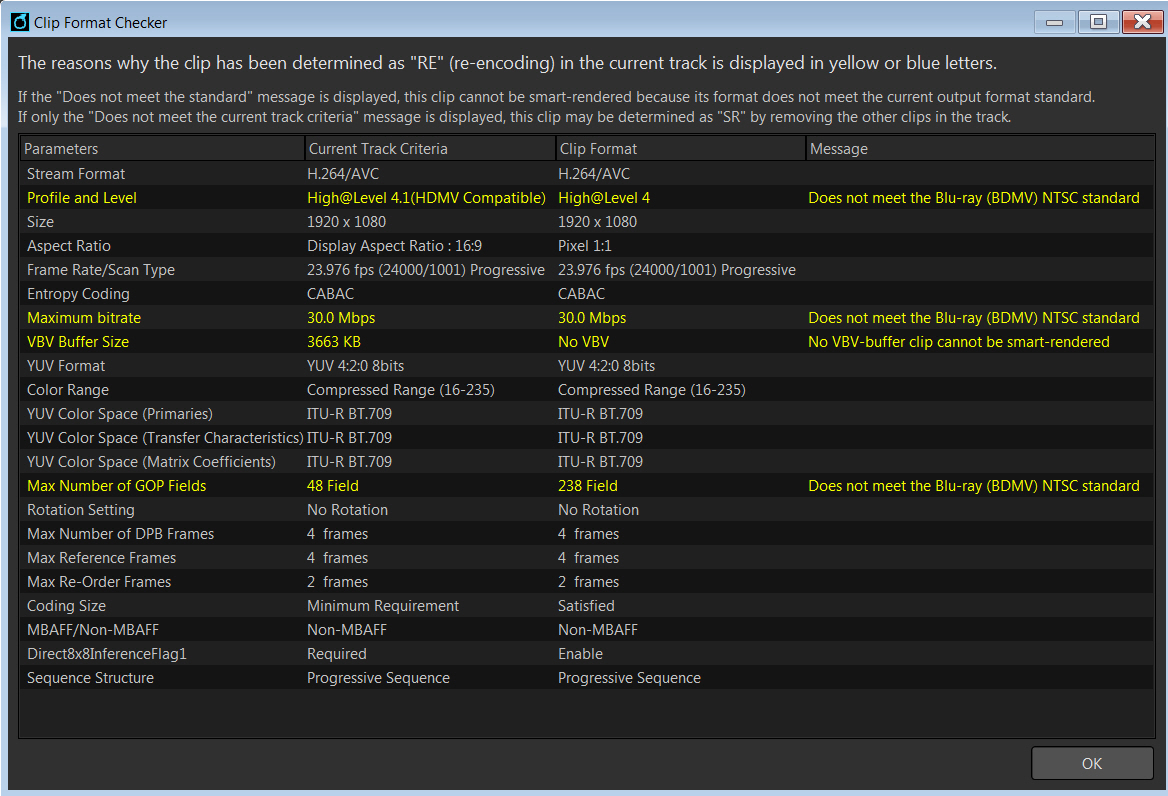

    I have investigated one other possible alternative product, named TMPGEnc Author Works 6. Not free, and not cheap, but purportedly very very capable and function-rich. And it also supports REMUX-MODE (named "SR", or Smart-Copy") if possible and if the input clip satisfies all the minimum BDMV-requirements. Alternatively video is re-encoded (named "RE", or Re-Encode).
    Unfortunately, the "clip format checker" built into TAW6 has found (correctly or incorrectly) four specific areas of non-BDMV-compliance with my input MP4 files. I question whether one of those discoveries is actually valid, but even so that leaves three items which in theory prevent their "SR" REMUX-MODE from being invoked.
    [Attachment 56159 - Click to enlarge]
    In contrast, AVCHDCoder only checks resolution and framerate, which for my MP4 clips allows REMUX-MODE to be requested. And the output BDMV is perfectly playable, both with software players as well as on my Oppo mechanical player. So maybe TAW6 is a bit too stringent and picky, or maybe they should offer an "override" option (currently not available) to force SR and hope for the best, like AVCHDCoder does. Worst case I could re-encode, but if resolution and framerate being acceptable is truly "acceptable" as the absolute minimum requirements and if REMUX-MODE output from TAW6 truly works, that would be fantastic to go along with their superior MENU functionality. I'd gladly pay their price, if they would allow "force SR and pray".

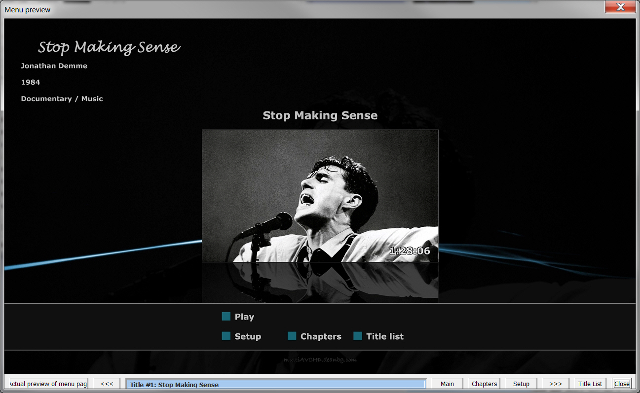

    So, i have now achieved 100% success using multiAVCHD. Custom intro screen, custom navigation menu for the one or more titles, custom chapter navigation sub-menu per title with frame-thumbnails and titles for each chapter, remux-only audio and video that finishes in under 5 minutes with 100% original source quality... totally and completely everything I'd wanted to do from the get-go, and which I'd thought ConvertXtoHD could also have done for for me.
