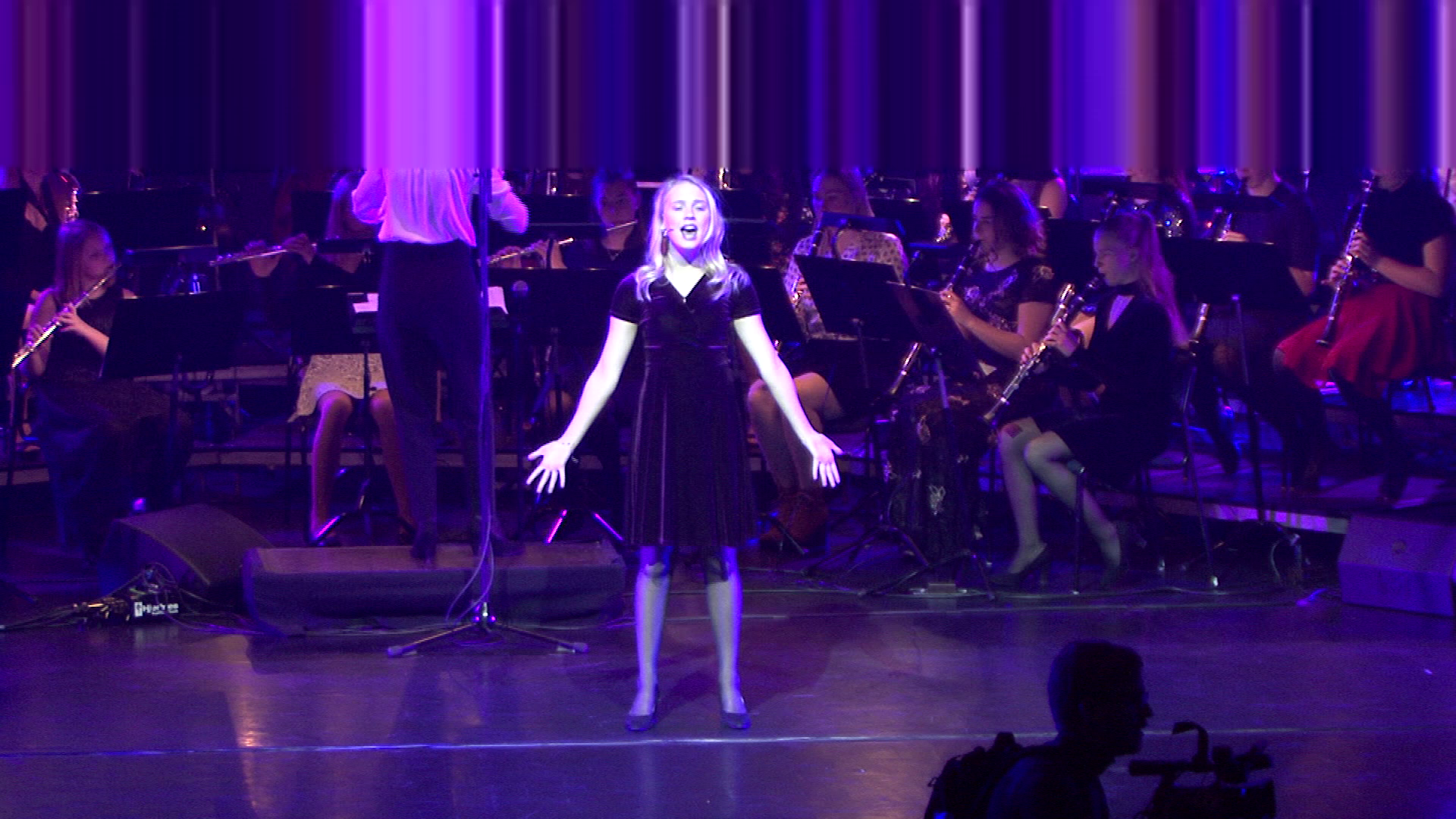

    the file seems really weird. the file's metadata says it's 29.97i.
    "xmp:MetadataDate="2019-01-28T22:56:19+01:00" xmp:ModifyDate="2019-01-28T22:55:55+01:00"
    xmpDM:videoFrameRate="29.970030"
    xmpDM:altTapeName="BN2019"
    xmpDMhotDate="2019-01-28T21:20:44Z"
    xmpDM:audioCompressor="Uncompressed"
    xmpDM:videoPixelAspectRatio="17280/12960"
    xmpDM:videoFieldOrder="Upper"
    xmpDM:videoAlphaMode="none"
    xmpDM:audioSampleRate="48Â 000"
    xmpDM:audioSampleType="16Int"
    xmpDM:audioChannelType="Stereo"
    xmpDMtartTimeScale="30000"
    xmpDMtartTimeSampleSize="1001"
    xmpDM:tapeName="BN2019"
    xmpDM:logComment="">
    <xmpMM:History>
    <rdf:Seq>
    <rdf:li
    stEvt:action="saved"
    stEvt:instanceID="xmp.iid:4A807C014223E9118480A458 842CD018"
    stEvt:when="2019-01-28T22:55:55+01:00"
    stEvtoftwareAgent="Adobe Premiere Pro 4.0"
    stEvt:changed="/metadata;/content"/>
    <rdf:li
    stEvt:instanceID="xmp.iid:4B807C014223E9118480A458 842CD018"
    stEvt:when="2019-01-28T22:56:19+01:00"
    stEvt:changed="/metadata"/>
    </rdf:Seq>
    </xmpMM:History>
    <xmpDM:videoFrameSize
    stDim:w="1440"
    stDim:h="1080"
    stDim:unit="pixel"/>"
    the 10:21 long part i could re-encode to mp4 is a bunch of repeated frames and lots of tearing of the upper 1/4. but the audio's fine

    Sounds like my starting point... Reindexing with DGIndexNV has fixed the video - which btw is 1080i25. The metadata in the file is absolutely all over the place.
