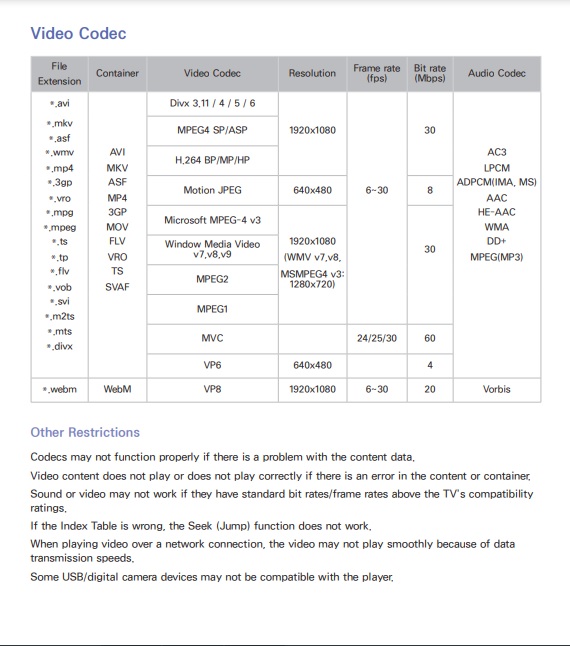

    It may be possible to play compatible video files stored on a computer running Windows via DLNA with the TV's built-in media player. Sharing needs to be enabled for the drive and directory where they are located, and AllShare on the TV needs to be set up to recognize the computer. To be playable, the file has to match the characteristics set forth in the manual. Also, your Wi-Fi connection has to be good enough for steady playback.
    From the manual for the Samsung F6800 Series:
    [Attachment 56074 - Click to enlarge]
    Using Networked External Storage Devices
    This TV can directly display media files from web storage devices and computers and DLNA-enabled
    devices connected to the TV over a network. To display the media files on an external storage
    device, the device must support DLNA and be connected to the same network as the TV. For more
    information, refer to the manual of the external storage device.
    For example, you can display the media files on your Smartphone or web storage in the following
    ways:
    ● Send a media playback request to the TV from a Smartphone or computer.
    ● Establish a link between the TV and a computer/Smartphone/web storage and play the media
    files.
    ● Use a Smartphone to send a request to the TV to play the media files stored on a computer or
    use a computer to request playing the media files stored on a Smartphone.
    ● Log into your Samsung account and play the media files stored on your web storage.
    " Certain media files stored on a networked external storage device may not play on the TV, depending on
    their resolution and format. In addition, certain functions may not be available.
    " Certain files may not play smoothly. If this is the case, use a USB storage device.
    Move to Photos, Videos & Music at the top of the Smart Hub screen. Select the media type and then
    the device where the media file is located. The folder and file list of the selected external storage
    device are shown.
    Allowing DLNA Device Connections
    Screen Menu > Network > AllShare Settings
    Selecting AllShare Settings screen Content Sharing displays a list of external storage devices
    connected to the same network as the TV. Select a device to allow it to connect to the TV. You can
    only play media files from devices that have been allowed to connect to the TV. This function is
    available for all DLNA DMC devices. Alternatively, you can send a media playback request from an
    external device that has not yet been allowed to connect to the TV and then accept the connection
    when prompted.
    AllShare
    AllShare makes it easy to retrieve and enjoy media files from computers and DLNA-enabled devices.
    However, computers need to be installed with AllShare PC and mobile devices need to support
    AllShare. For more information, visit the Samsung Content & Service portal (http://link.samsung.com).
    " You may experience compatibility issues when attempting to play media files via a third-party DLNA server.
