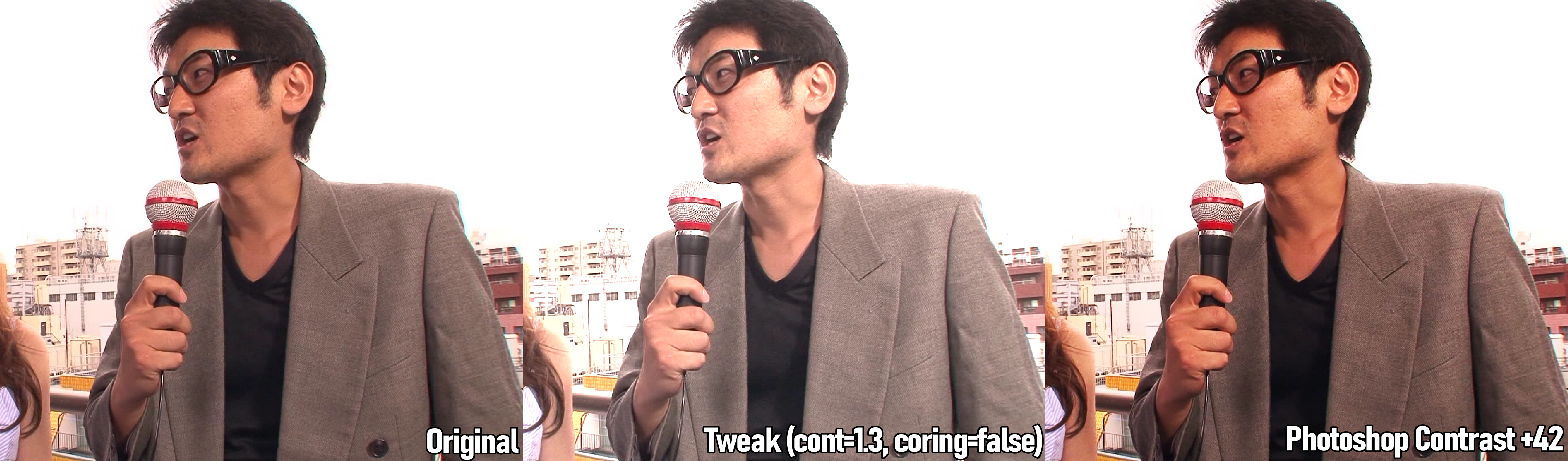

OK I've managed to make a comparison between Tweak and Photoshop, both with an exagerated bump in contrast, as you can see the results are nowhere near. It's not so much an issue with the scaling as it is an issue with the effect it's having on the picture.
[Attachment 56071 - Click to enlarge]
Unfortunately it's a little painful to fiddle with Tweak, as I have to write the script manually and reload each time in VirtualDub... maybe there's a way to have a GUI showing real time effect of the filter?
There are no conversions in the script either, but you are correct in the fact that Tweak works in YUV only, so it may be the issue. What then could I use to obtain the desired effect? -

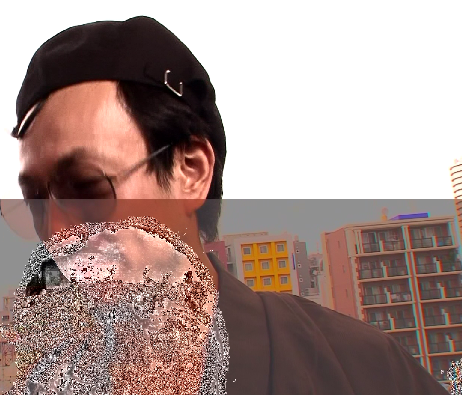

[Attachment 56072 - Click to enlarge]
dither_sigmoid_direct is having this very weird effect what gives? I'm using 1.28. Full script for reference.
EDIT: Sorry it's probably what you're mentioning with pixel format. But can I even convert to the appropriate one?Code:DGSource("D:\Ripping\VOB\STREAM\00000.dgi") AssumeTFF() QTGMC(preset="fast") Dither_sigmoid_direct(cont=6.5) -
It would be something like this for the syntax for stacked16, going back to 8bit

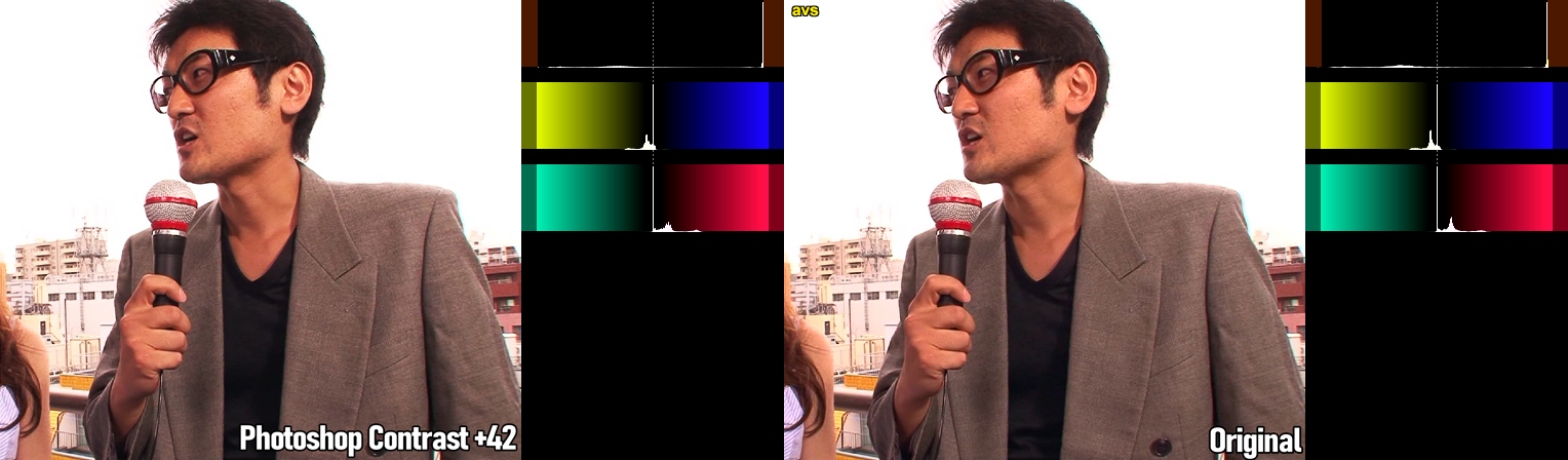

This is semi-close, the highlights in the skin detail are a bit off
Code:ImageSource("compare.png") spline16resize(width/3 , height/3) crop(1017,0,0,0,true) converttoyv24(matrix="rec709") histogram("levels") c1=last ImageSource("compare.png") spline16resize(width/3 , height/3) crop(0,0,-1017,0,true) converttoyv24(matrix="rec709") orig=last orig.greyscale() Dither_convert_8_to_16() Dither_sigmoid_direct(cont=2.5, thr=0.53, u=2, v=2) ditherpost(mode=6) y=last orig.utoy Dither_convert_8_to_16() Dither_sigmoid_direct(cont=3, thr=0.5) ditherpost(mode=6) u=last orig.vtoy Dither_convert_8_to_16() Dither_sigmoid_direct(cont=3, thr=0.5) ditherpost(mode=6) v=last YToUV(u,v) MergeLuma(y) smoothlevels(0,1,255,0,252, chroma=0) subtitle("avs") histogram("levels") c2=last stackhorizontal(c1,c2)
[Attachment 56073 - Click to enlarge]
