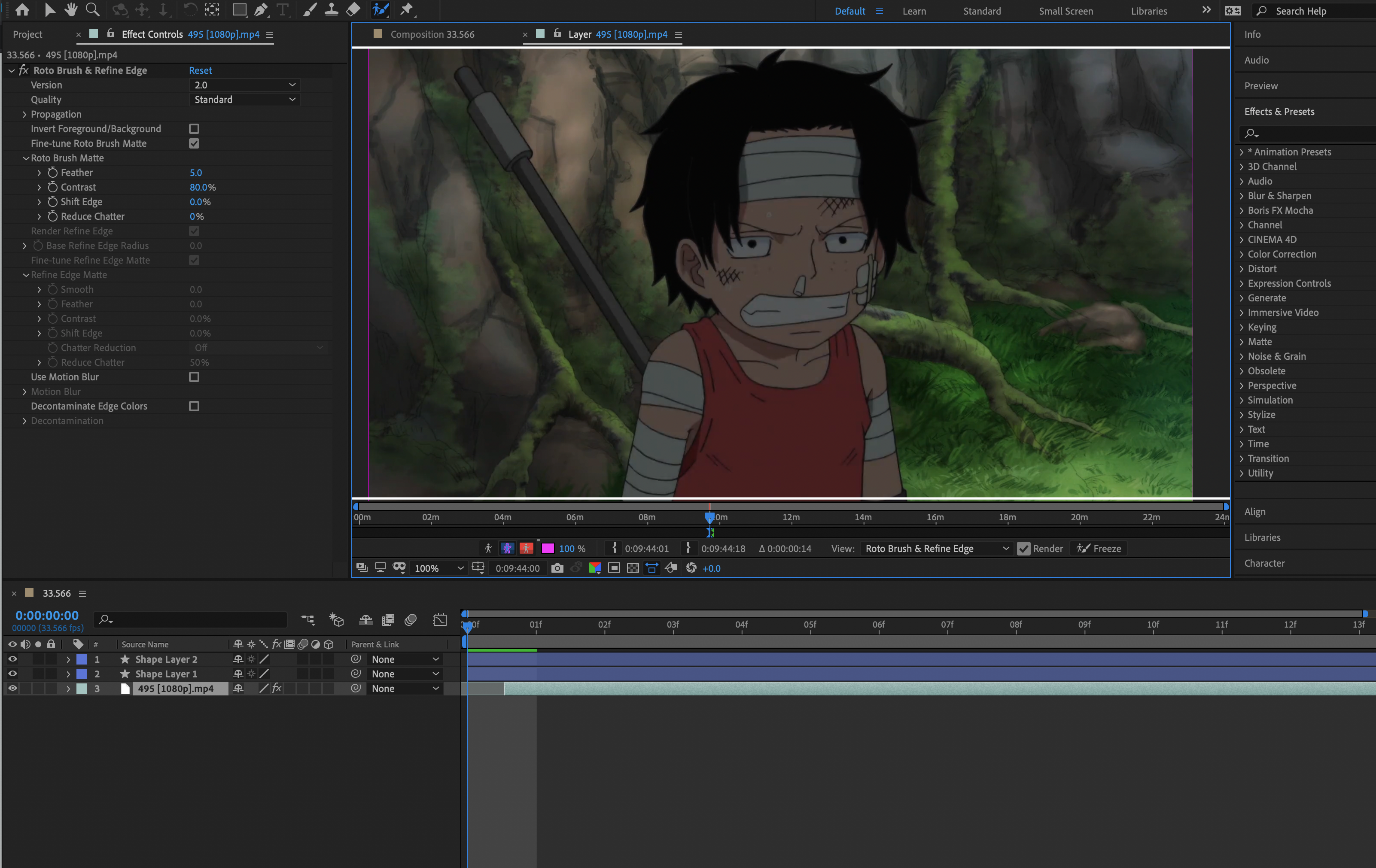

  5. Maybe try uninstalling and reloading AE. FWIW I had no problems with rotobrush using your image. My selector was smaller than necessary if that's any help.
