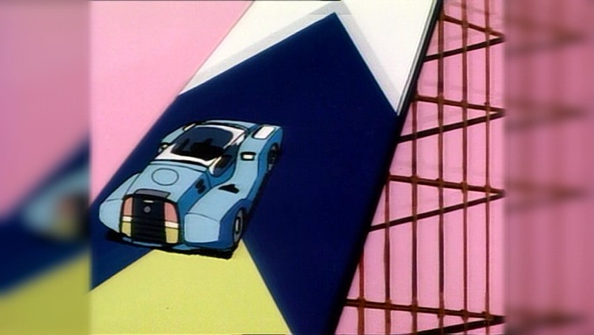

  5. I did a quick test of that script in AviSynth with a 640x480 video. The script works but it enlarges the frame to 852x480:
    [Attachment 85252 - Click to enlarge]
    You can't enlarge the frame like that in PotPlayer -- it will crop the video back to the original frame size.
