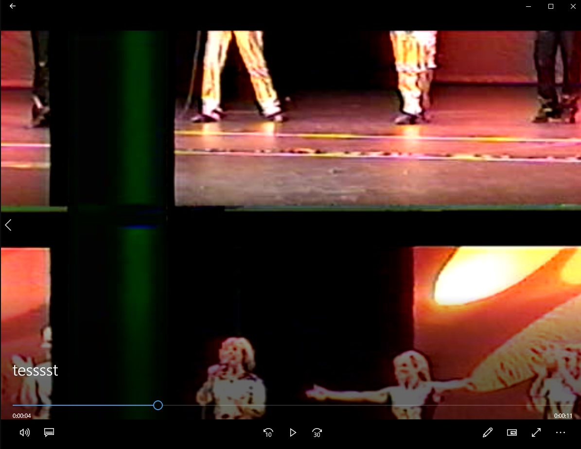

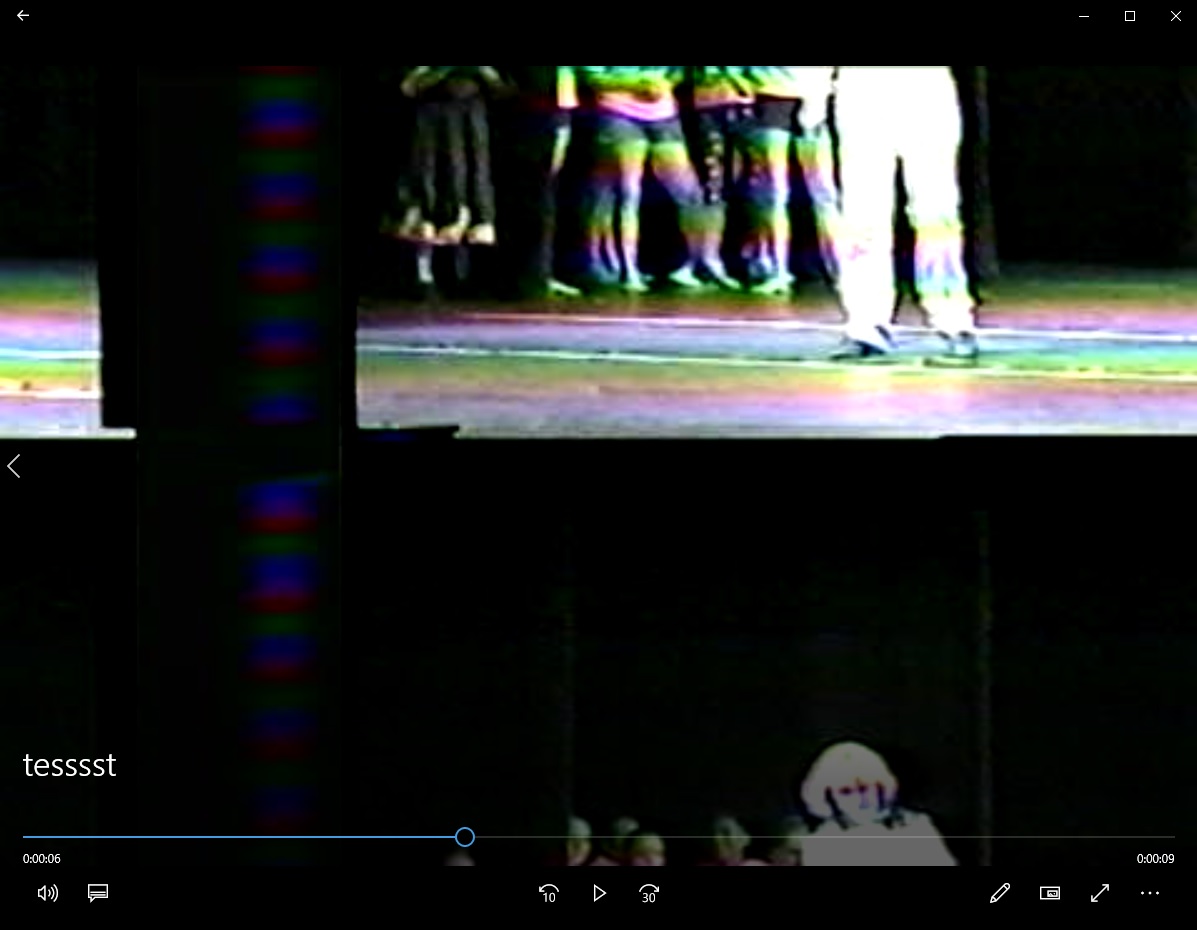

  1. Using the EZCAP device to capture from old vcr onto virtualdub/obs studio. this is what im getting now. when i originally hooked it up it looked more aligned. i dont recall changing any settings but now all the videos look like this. any ideas?
    [Attachment 55995 - Click to enlarge]
    [Attachment 55996 - Click to enlarge]

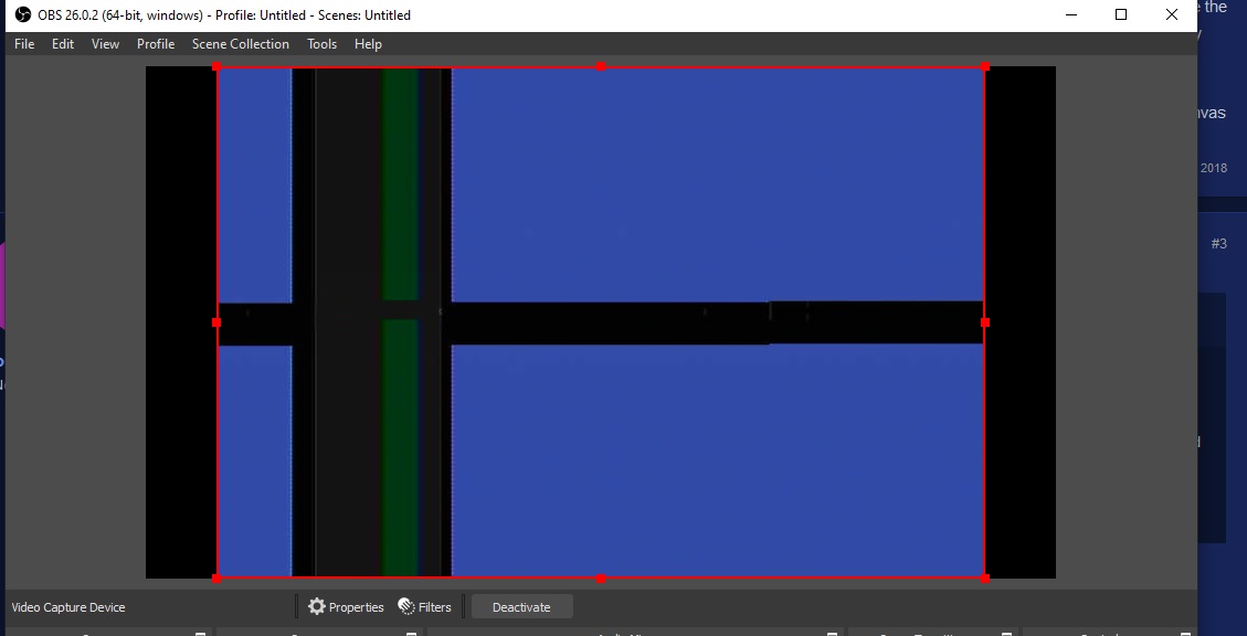

  2. this is what is looks like when i plug in the yellow video composite
    [Attachment 55997 - Click to enlarge]
    An Easycap earned the nickname "Easycrap".
    It's a horrible item.
    Even without the vhold skew, look at how terrible the video is. All the highlights are blown out, the colors are destroyed.

    Jayleonois, the skew problem could be from anywhere in your hardware chain. The EZc(r)ap may have gone defective recently (more common than you'd imagine), your PC may have burped on a recent Windows update thats now interfering with correct function of the capture software, and/or your VCR is unable to output a signal with these tapes that your capture setup can handle cleanly.
    Post back with more details of your setup (VCR brand/model, PC specs & OS 7/10 version, where/from which vendor you obtained the EZcap. Experts here may then be able to help you troubleshoot more accurately. Note it is very tricky now for newbies to buy a "genuine" EZcap: most that you see for sale are generic, poor knockoffs of the "real" EZcap, and even new examples of the real one aren't always as decent as it was years ago when first introduced. Much of the advice you receive will entail spending rather more money than you anticipated: forums like this tend to recommend setups known for best results, recommendations for "just OK" setups are a moving target and much more subjective.

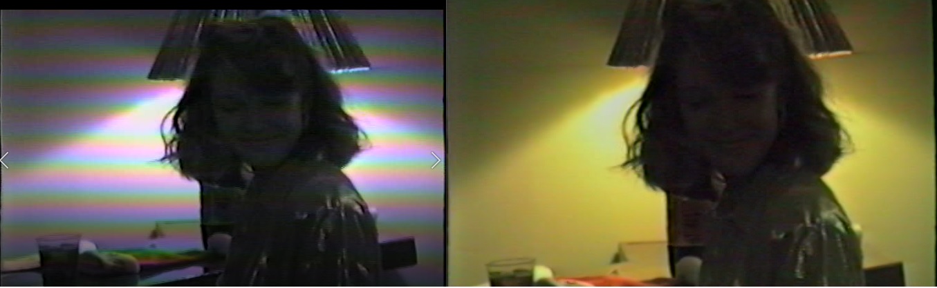

  18. Okay so I switched from EZCAP to the hauppage. here is the first difference I saw with a video that was giving me trouble. (I also switched from virtubal dub to the hauppage capture software if that makes a difference because I couldnt get the haupage to show up under devices in Vdub.)
    The other photo shows later in the video where I am still having issues. Is this snowyness a result of bad tape? or could a new VCR help out there too?
    Originally Posted by orsetto View Post
    theres something really wonky in the older tapes that is giving fits to either the VCR or
    This is because VHS conversion has a recipe. Follow it.
    VCR > TBC > capture card (ie, the workflow)
    Not just any VCR, any TBC, or any capture card, but models known to work well with consumer sources like VHS.
    Some sort of TBC is required, it's not optional.
    For budget reasons, there are some shortcuts for building a good workflow, but each does incur a quality hit, and there will be a fail rate.
    Deviation gives you non-stop problems, and quality will be severely harmed.
    In terms of gear costs, buy it, use it, resell it.
    This entire thread is caused by (A) lack of TBC, and (B) lousy cheap Chinese knockoff-chip capture card
    Make sure you check the format settings for your EZCAP. You didn't say what model of capture device, but make sure that, if you are in North America that you have the format set to NTSC, not PAL or SECAM. Also, if you have an NTSC-J setting, change that to NTSC.
    That's not a PAL/NTSC issue. That presents differently.
    Finally, if any of the tapes which are giving you problems are commercial tapes
    His sample was a homemade camcorder video.
    That was a mistake. You're now capturing compressed video. Quality will suffer.
    Perhaps. Depends on what is causing it.
